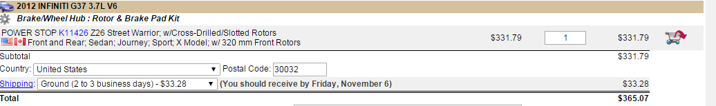

Lorenzo, I'm going to purchase this package from Rock auto it should provide the same performance as the Z1 Motorsports package and with shipping its cheaper then their package. Although it does not come with stainless steel lines, you can probably purchase them cheaper and add some high performance brake fluid and still come out on top. catalog number: K11426
