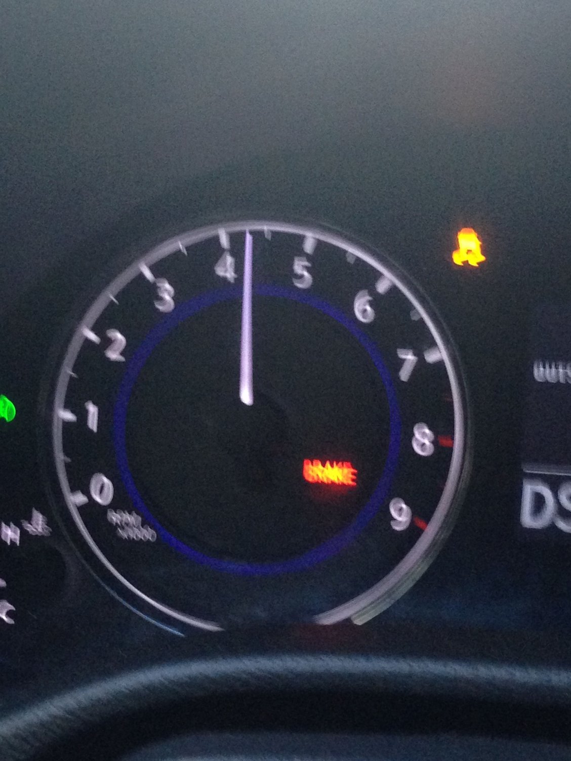

I think I have desided to just buy the kit listed above. Slotted only rotor, hps pads, 600 fluid. Also I added a z1 silicone brake booster hose since I'm replacing the other lines and it looks cool I guess. I'll let y'all know the results. Just not sure on spending the extra 800-1000 for the calipers when for what I use the car for the oem work fine. My rear pads are at maybe 10% so figured I'd change everything. Also I get a brake light on my car a lot on the speedo that comes on during acceleration and goes away when slowing wayyyyy down. Anybody seen this before?

Brake light comes on during acceleration and also I have another light that comes on after getting on it ? It looks just like the traction control light but in the picture tcs is on. Obviously when it's off there would be another yellow car icon. So is the one that's on currently like stability control or something?
Top off your brake fluid and it will go away. I had the same thing. Light came on only during hard acceleration. Fluid wasn't real low, but I topped it off (after reading a thread here that mentioned it) and haven't seen it again.

+1 ^^^^^
I had the same thing just after I took delivery of my G. I added like four tablespoons of fluid and haven't had the light come back yet.
