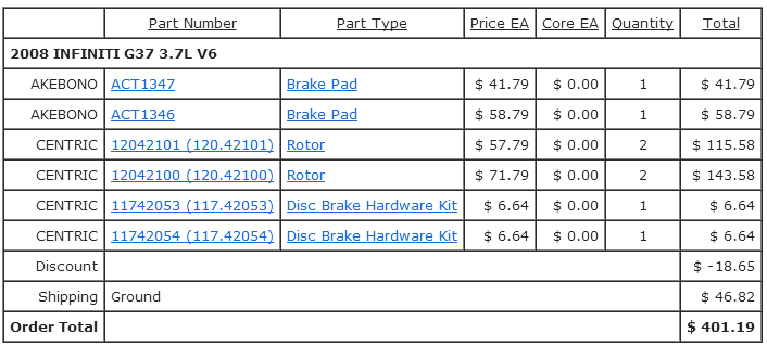

OP, what rotors are you considering purchasing? I have bought budget rotors in the past and had a pretty bad experience. I highly recommend Centric Premium rotors. The slight up charge is well worth what you get in return. They are high quality parts and come with a black coating on the hat. Below are my part numbers from my order in April of 2014. I haven't had any squealing with the setup, it has been great.

I just ran the part numbers for your rotors and answered my own question. I'd still recommend moving into the Centric Premiums. For the small increase in price, it's worth it.

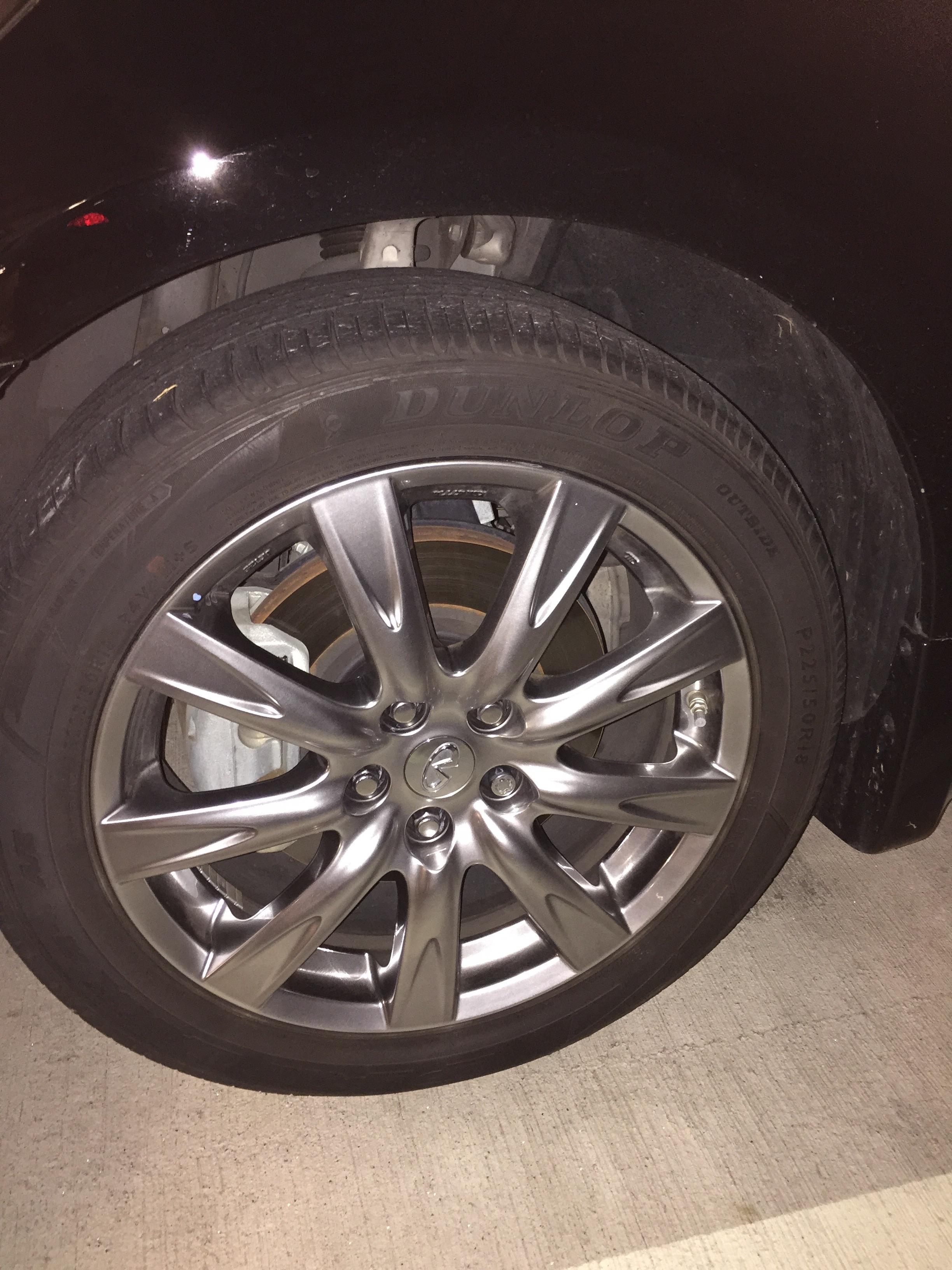

Ok, so I ordered the sway bars and the paddle shifters, but I thought I'd double check everything before ordering the brakes and sure enough I realized my rims were 18" (most likely these ones) and not 19".
I haven't seen any threads detailing the install on these rims specifically, but if Infiniti's website is to be believed, it seems like they fit just fine?
I think i will have the mechanic remove one of the front/rear tires when I get the sway bars installed so I can compare them against the template.

I know the duckfeet ones for my xS sedan on my 2010 will fit over the Akebonos. Not sure about those though. But our tire sizes are the same.

I had the shop verify whether they'd fit by comparing against the templates and they didn't. Their recommendation was to look at 19" rims instead of going with spacers as I'd need really big spacers.

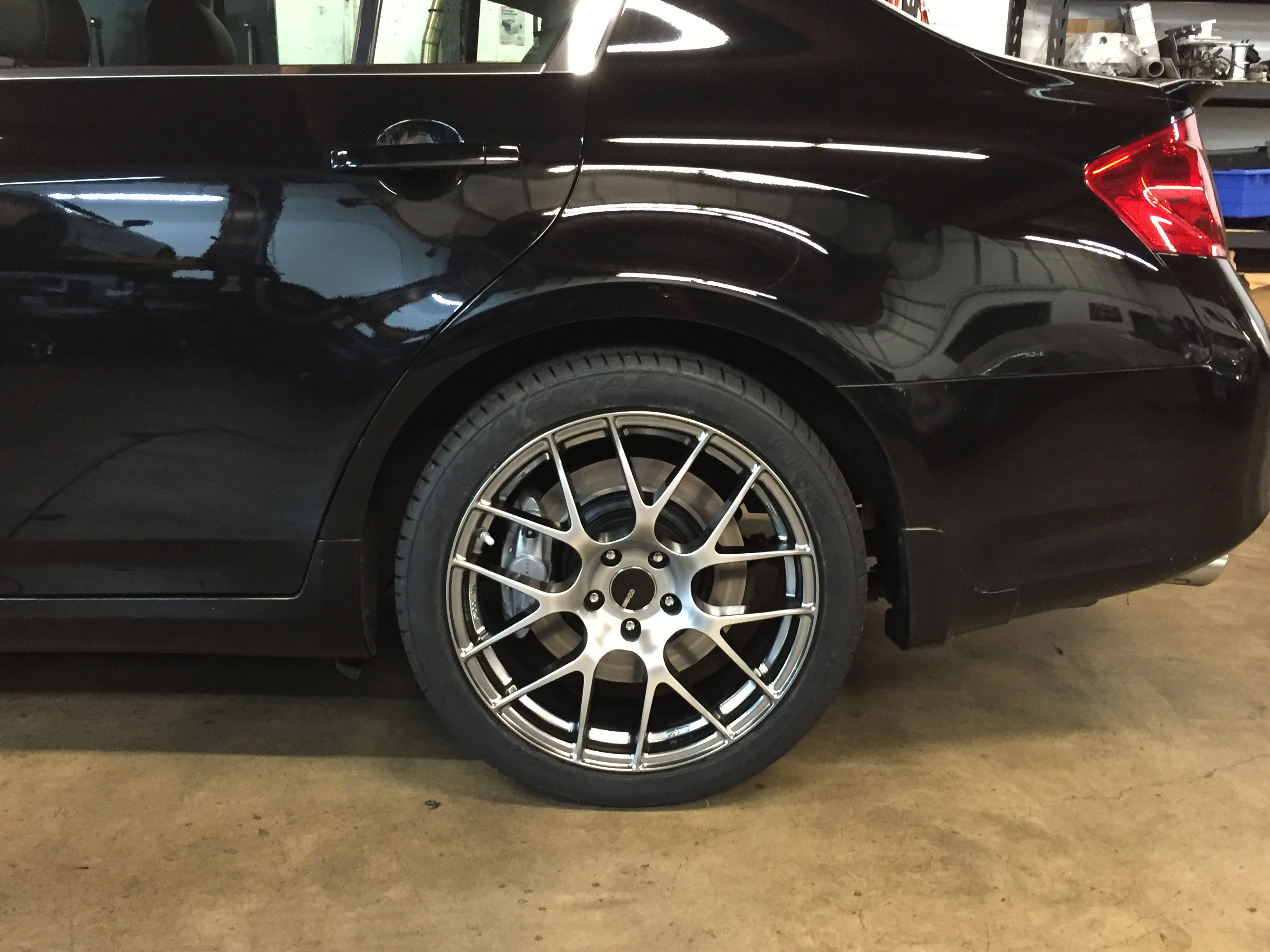

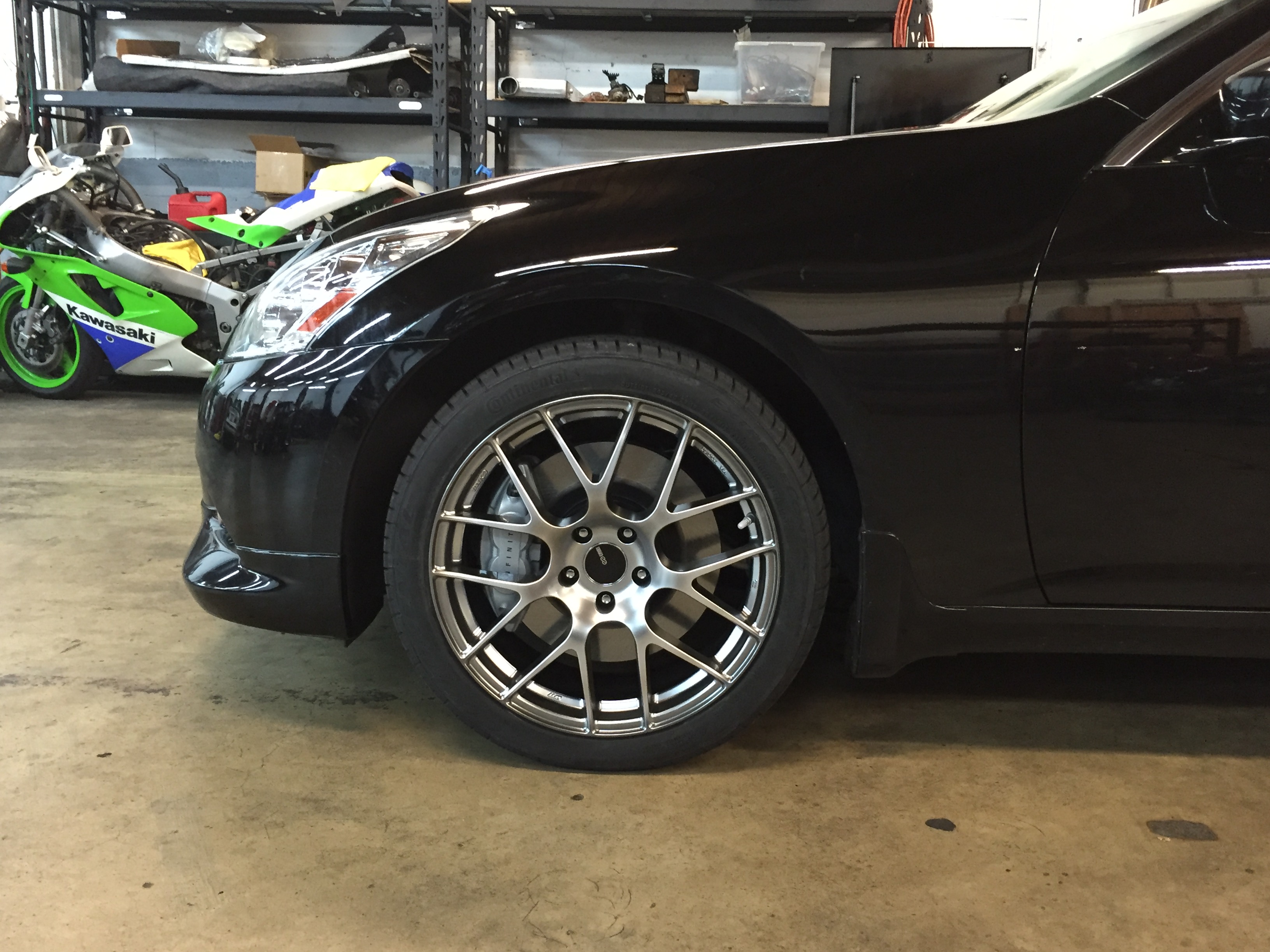

Install is done.
