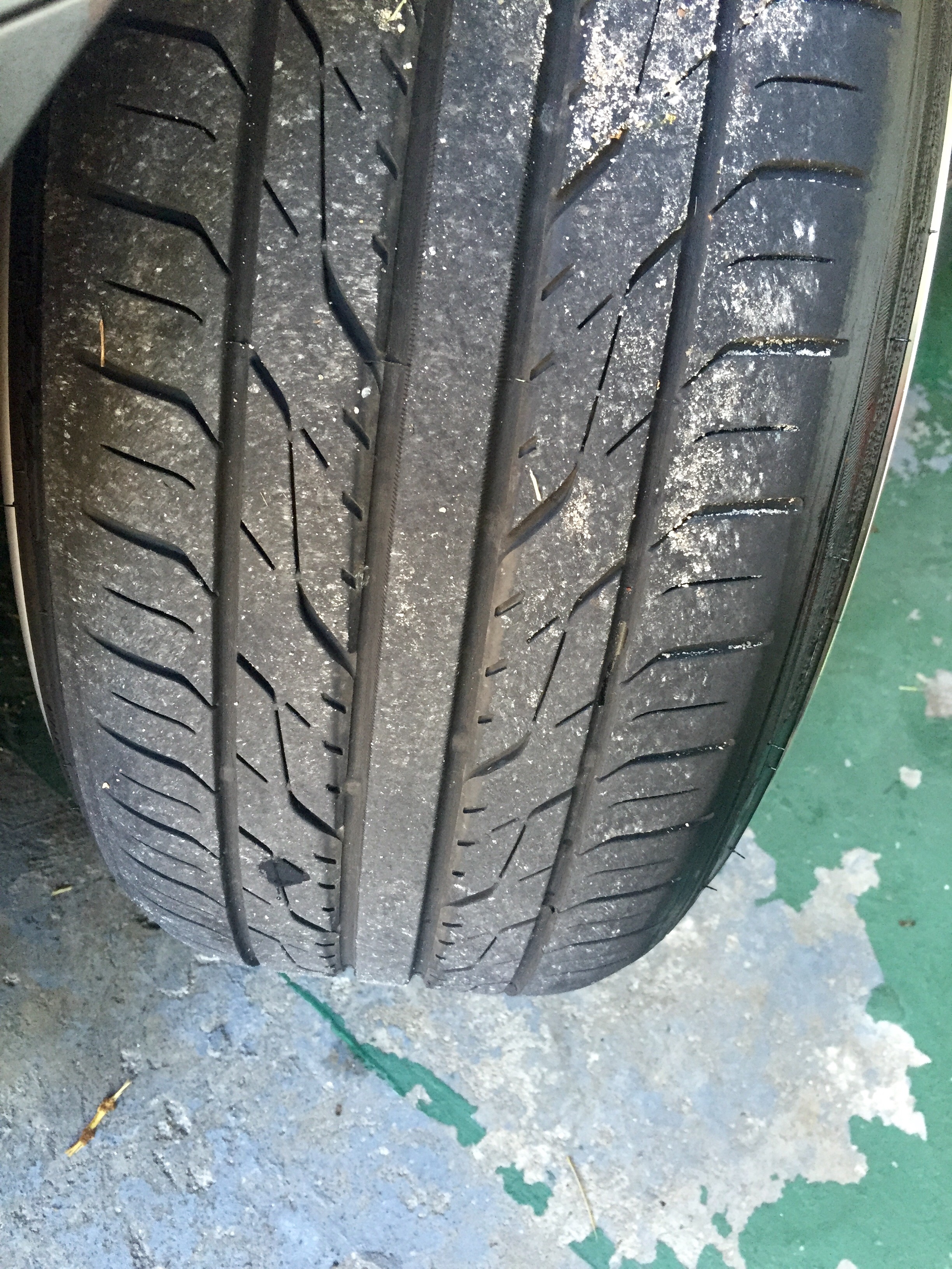

Let me put it this way...I'm dropped low with no camber kit in the front. I'm running -3.5 camber in the front and 0.05 toe in. I have about 15,000 miles on my tires, and they still look good.
A rotation at 10k would be nice.
Old Aug 21, 2015 | 03:26 PM
Got any pics of said tires??
Here you go sir. I just took this pic this morning.
Old Aug 22, 2015 | 01:52 PM
Pretty good I must say, what tires are you running?
Lego Maniac (IIRC) was running camber in the -3s and his Pilots were shot at 5k w/ toe in spec
I'm running Toyo Extensa HP, but I plan to run Toyo Proxes 4 Plus next time around. They're rated better in every way...including supposedly being good for 50k miles (which I'll be lucky to get 20k-23k).
I do have a confession. I flipped the my tires with about 5k miles when I switched wheels out. Regardless, the tires would have held up decently.
Old Aug 22, 2015 | 11:04 PM
That's funny you mention those tires, I actually had both those previously. The directional Extenzas were OK, not great but for the price not too bad. The Proxes 4 Plus I just replaced since I had a flat in the back (without TPMS) and drove a bit too long and crushed the sidewall. I got about 30k out of them and they still had another 10k I'd guess. My camber is about -1 so even w/ my 295s in back the treadwear was perfect. I'm on Summer Nittos now and am much happier w/ the overall grip, but probably get about 1/2 the life.
