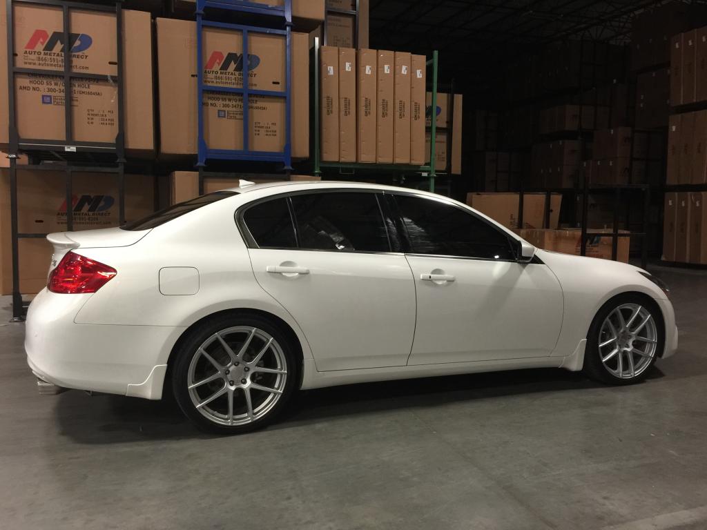

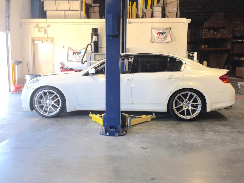

By the way, here are two pictures for reference. The first shows the rear way too low. For what I was going for anyway. The second shows how it sits currently. The rear is now too high but at least we have room for travel/adjustment now.

Old Feb 8, 2015 | 01:12 AM
Ok, I thought you just weren't able to get the adjustments properly set up. That top pic looks pretty good, but if it's not going to work for your daily drives then you'll have to resort to another option, on that pic of your spring, it looks like you have a bit more room to go down but not much, maybe a 1/4" and still be safe.
How much higher from pic one do you really need it to be?
Old Feb 8, 2015 | 08:33 AM
jsampsell's Avatar
jsampsell
Joined: Mar 2014
Posts: 203
Likes: 33
The stock height from ground to top of fender was 28.5 inches all around. Well, technically the driver's side was about an eighth lower but we decided to use 28.5 all the way around since we were putting in all new equipment. I wanted to go down a total of 1.5 inches. With settle factored in, we thought we'd shoot for 1.25 for our first round and then adjust as needed from there. Our first try on the front yielded a 1.5 inch drop instead of 1.25 but they are easier to adjust than the rears so we were going to go back and fix those after we got the rears dialed in. We didn't get around to fixing the fronts because of all the trouble with the rears, so the pictures don't even show the right height for the front. That's where I hope they end up after settling though. The rears in the top picture, however, are at 26.75. That's with what you said about having .25 inch left of adjustment. There's no way we could have gone up a full inch from there. That's what leads us to believe that the included Swift springs are just shorter than they should be for this application. The second picture, with the modified upper spring bumper used to get the additional height, shows the rears sitting at 28. Because we had the additional length, we now can go back up in adjustment to get the .75 additional drop. However, I'm concerned about the potential for the springs to shift causing them to pop out. The cone shaped upper rubber bumper that we cut was designed to make sure that the stock upper spring mount would not move. It was long enough down into the upper spring mount that no amount of flex/shift would allow it to pop out. Well, we cut the cone part off to make sure the top of the FA upper spring mount would sit flush to it. That means there's nothing but weight and compression keeping it where it is at the moment. Under the right circumstances, it could technically shift enough to pop out. I may be over thinking this but I just don't like rigging things. I prefer to have things installed as designed.

That's pretty much exactly what I ran into also there's not much room at all for further adjustment on the rear. Not without me losing any feeling of comfort at least. I would have preferred the spring be a little longer. I got it adjusted to where it usually works for me but there isn't much wiggle room.
