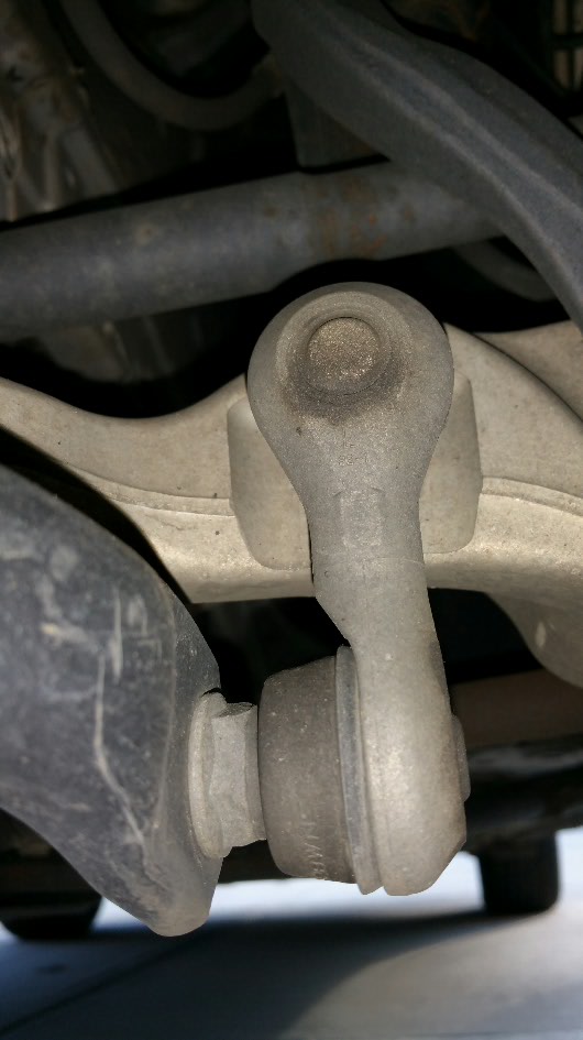

Originally Posted by Upscale Speed
I would imagine this could be a very solid setup coupled with Hotchkis sways and Whiteline rear end links and new Moog front end links.
Why Moog front end links? Are they stronger than oem, or are they shorter for lowered cars?
I trust Moog I've used their end links on several lowered cars in the past and never had one fail and in one case they were an obvious upgrade (much beefier than stock). IMO I'd rather try those than OEM. If they fail no big deal I'll buy OEM. They aren't that expensive.
Are the oem end links aluminum? Compare the oem front awd end link with the moog. It looks to be as stout or more, but perhaps moog uses better bolts and the pivot joints are greasable...Also if aluminum, the oem could be weaker I guess.
OEM
Need help with rear Fortune Auto 500 shock/spring install-k9si3yd.jpg
Moog
