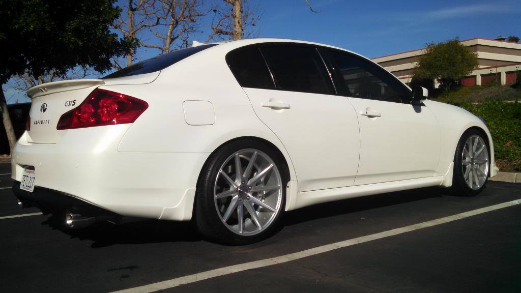

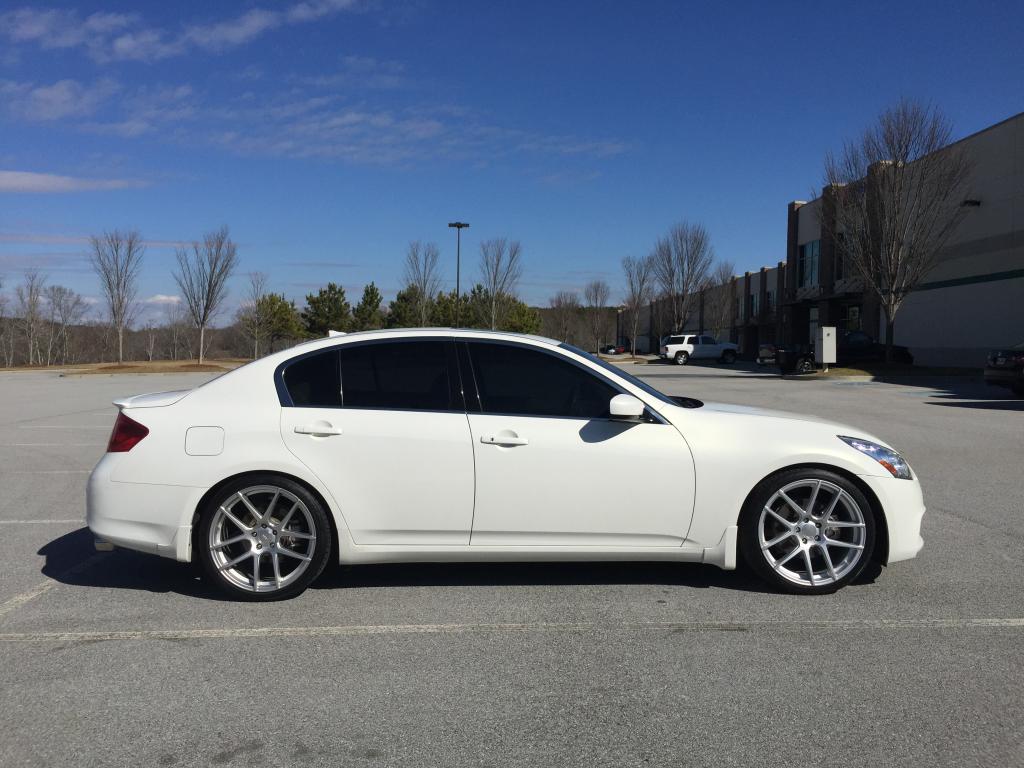

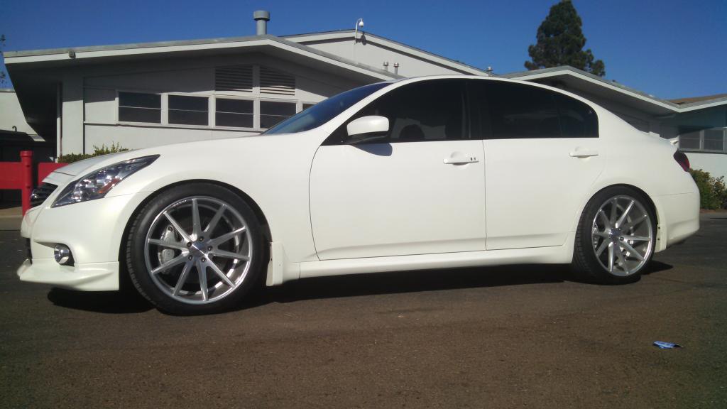

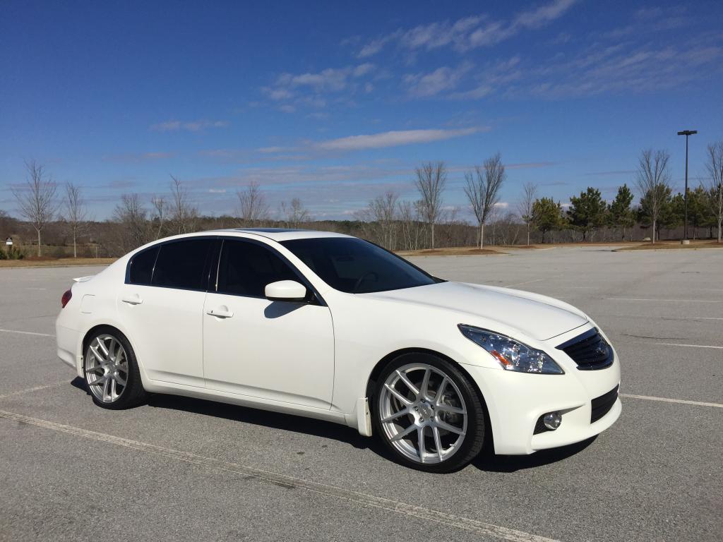

I thought I'd post some updated pictures of the max ride height on my car. The height isn't bad but it is still just a bit lower than I intended. Plus, if the springs settle any then I'm definitely going to be lower than I want. This is just for reference purposes. To show a better picture of what the height is like.

This looks damn near perfect to me, but I appreciate your passionate approach for what you want. Have you thought about thicker rear bushings? Rochester on here is trying that with his. He has Swifts and doesn't like the rear sag.
Personally I think it's the stock shocks. I have the Swifts but I also installed the Koni's and it came out perfect (in my opinion).

Furlow, it's not the shocks. He's on Coilovers with Swift springs, and has too short of a spring.

Wait a second, are you on 20's or 19's? What is the profile of that tire? I am glad this thread is here, that pic is way too low for me for max height. This is really really good to know as I will pull the trigger on F500's this month.
