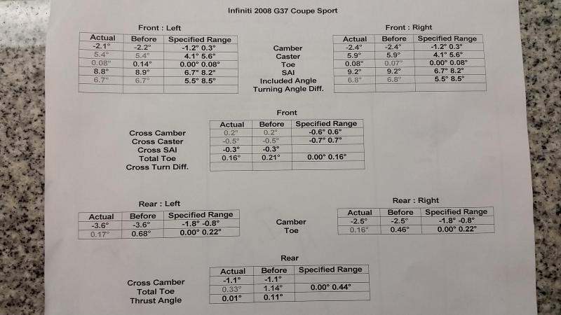

Anyone with Tein S Techs please post your alignment specs!
Can someone post their alignment specs so I can take it somewhere and they have something to go by? My front is wearing fine but the back is the problem. I have a rear toe bolt kit for each side on the rear and a rear camber kit. Turns out infinit used oem specs to align it and it ate up the rear tires like nobody's business !!

Sorry I didn't see this earlier. Not sure if you still need this but here are my alignment specs for my Tein S drop. Note that I do not have any toe/camber kits installed.
Hope it helps!
Sounds like you went to the dealership to get your aftermarket kit installed. Big chance they did NOT install your equipment correctly. The toe kit will require elongating the oem toe bolt hole otherwise the adjustment range will not change. Do you have a copy of the alignment spec sheet?
