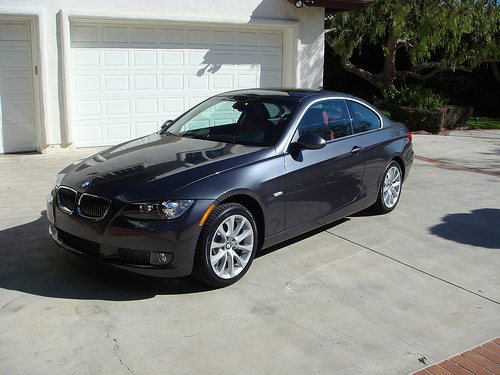

I'm just going to leave this here and let everyone interpret it on their own for now.
Interesting. Where did you find a pic of a 4WD 3 series :-)
This must be an AWD version. Here in Socal, I rarely see an AWD anything, so maybe my view of Audis/Bimmers is distorted.
Your statement is slightly contradictory. Most Audi's are AWD.
^ that's an AWD 3 series coupe. the AWD versions of the 3 series are "lifted" a bit compared with the RWD sport package models. i agree it looks a bit dorky but BMW must have a functional/practical reason to make the change...probably something to do with the AWD components.
i have a colleague with a 335i RWD sport coupe and another colleague with a 335i AWD sport coupe and there is an obvious ~.75-1" ride height difference. the AWD model more closely resembles what the G37S has in stock form, whereas the RWD has that nice hunkered down "euro" look.
