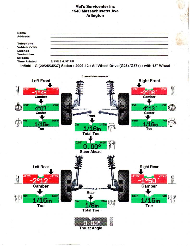

The RWD G37 seem to fare better with Swift springs, but all the AWD Gs with Swifts(including mine) had about -2.0 front and -1.8 rear without aftermarket camber arms.

I'm aiming for zero toe.

Toe is a much greater influence on tire wear as opposed to camber.
I ran -1.5* camber and 0 toe all around on my Subaru and I did just fine when I used to autocross heavily.

I just recently swapped over my OEM Dunlop SP Sport Maxx tires onto new wheels and there was no issues with uneven wear across any of the tires.
I have about -2 degrees camber with "0" toe.
This is with Swifts & 20mm spacers running over 1.5 years.
