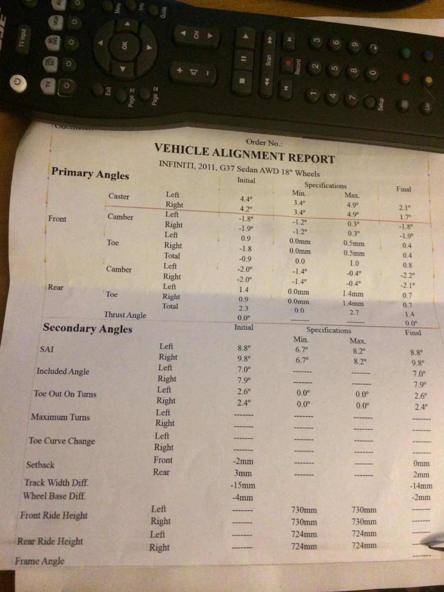

Alignment Specs With Swift Springs
Was a little surprised. Thought Swifts were considered mild?

Seems to be in range from a few of the other Swift alignments that have been posted. Range of camber seems to be -1.8 to -2.2 once the toe is in spec.

Exactly my rear camber specs, although my fronts fared better than yours.
IDK what to say. Get a camber & toe kit installed (for another big hunk of change), at which point you may lose a particular tuck that you like. Or just go with it and reassess tire wear in half a year or more.
But you're not alone. I was rather surprised at my alignment specs, too.

you did a little better than I did, but maybe your springs haven't settled

I got -1.7 front and -1.8 rear.
The key is ZERO TOE.
Tell the tech you want ZERO TOE.

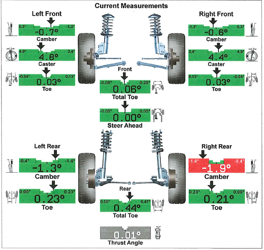

this is me on swift springs with SPC F&R, no spc toe bolt.
the passenger rear camber had to be set at 1.9 to get the toe in spec, since the toe bolt was seized on that side
