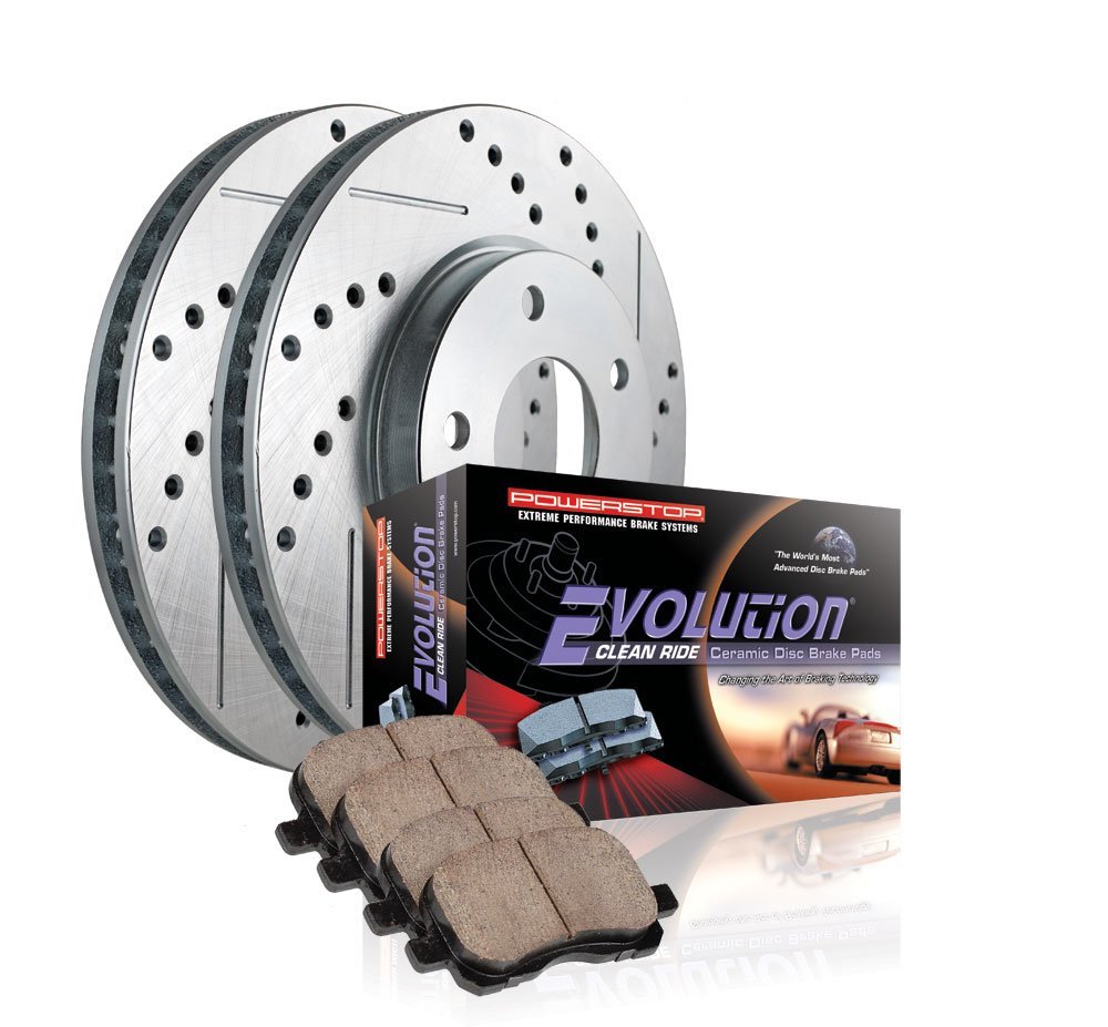

Nice man looking forward to your thoughts, I just did these all around on my sedan,
I have the sways already to, Love the way the make the car corner.
Attached Thumbnails I'm getting my Hotchkis sways and my new rotors and pads today!-brakes.jpg

Looks like a great setup. Let me know how you like the ceramic pads. They should last longer and have no dust.

Thanx man, I really like them and the dust is almost nonexistent. . Very little dust is any, But then again I was the car like every 10 days
