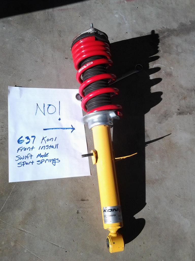

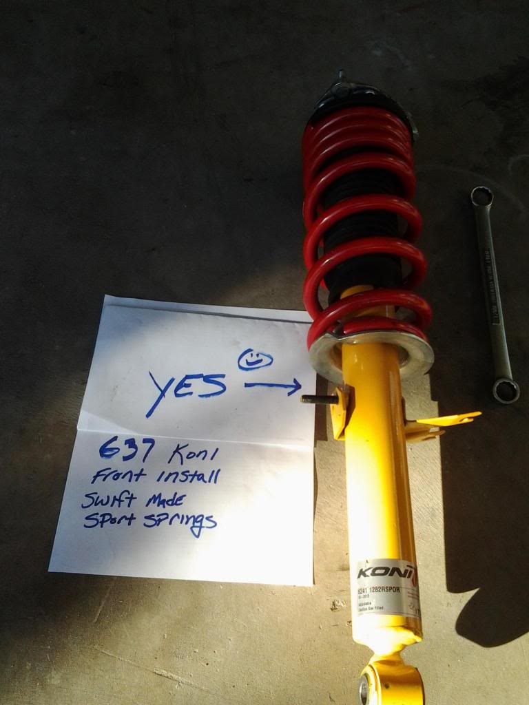

Originally Posted by Glover998
Sorry not into suspention stuff lol, can you just elaborate on this plz ?! thank you.
The lower spring perch, the silver 'cup' the spring sits in at the bottom, can be mounted two ways.
These are not my pics
Attached Thumbnails Lowering options-20130716_184424_zps07a98c26.jpg   Lowering options-20130716_182205_zps4801e2e3.jpg
Got it ! thank you very much..
