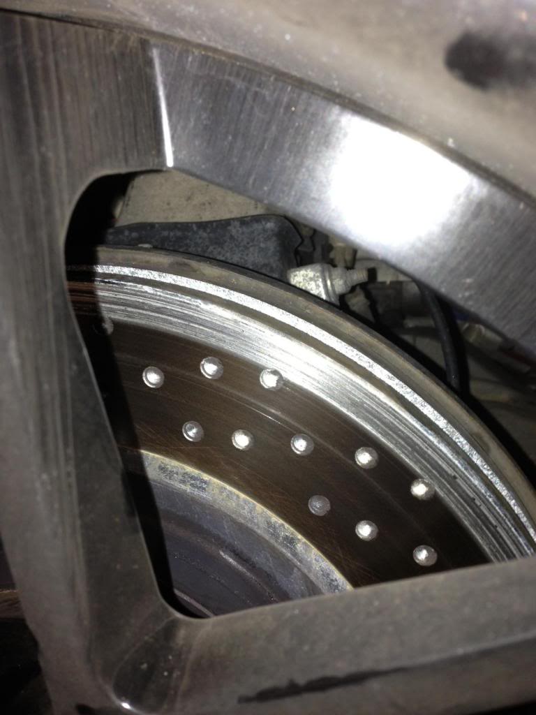

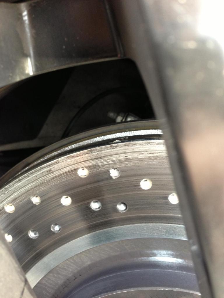

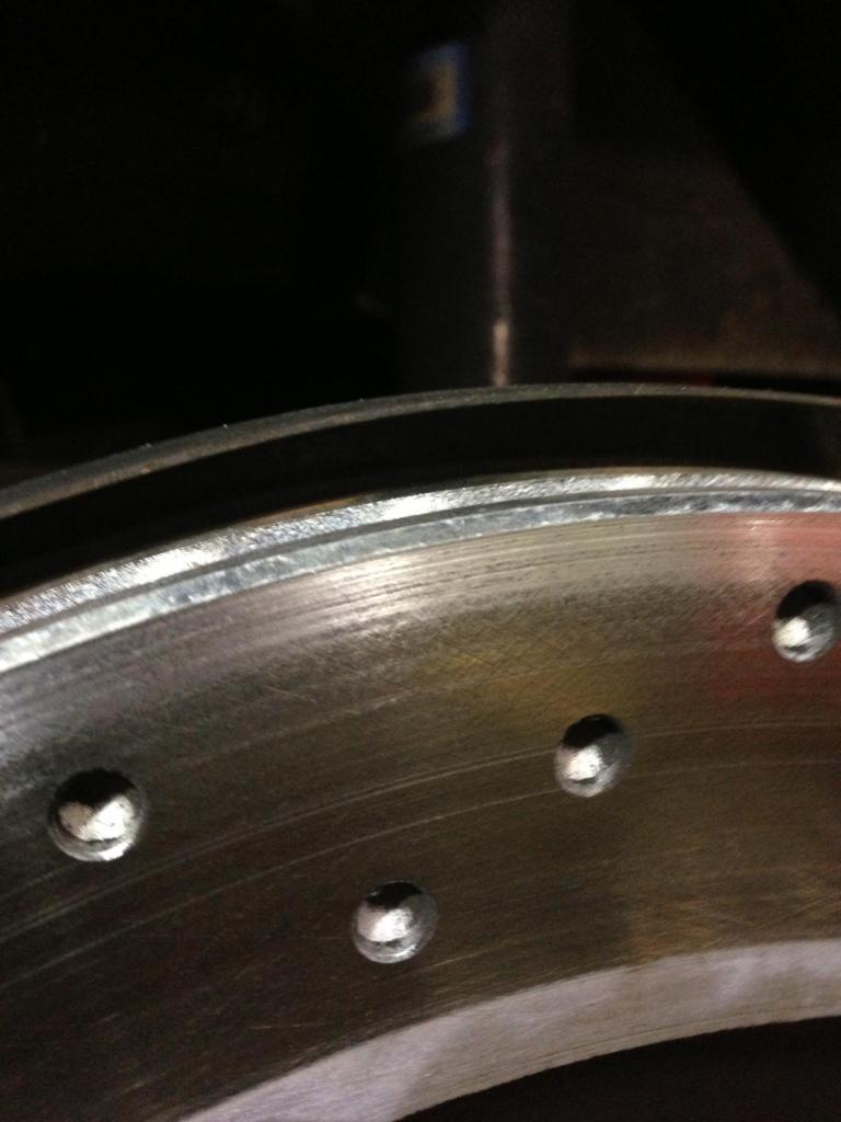

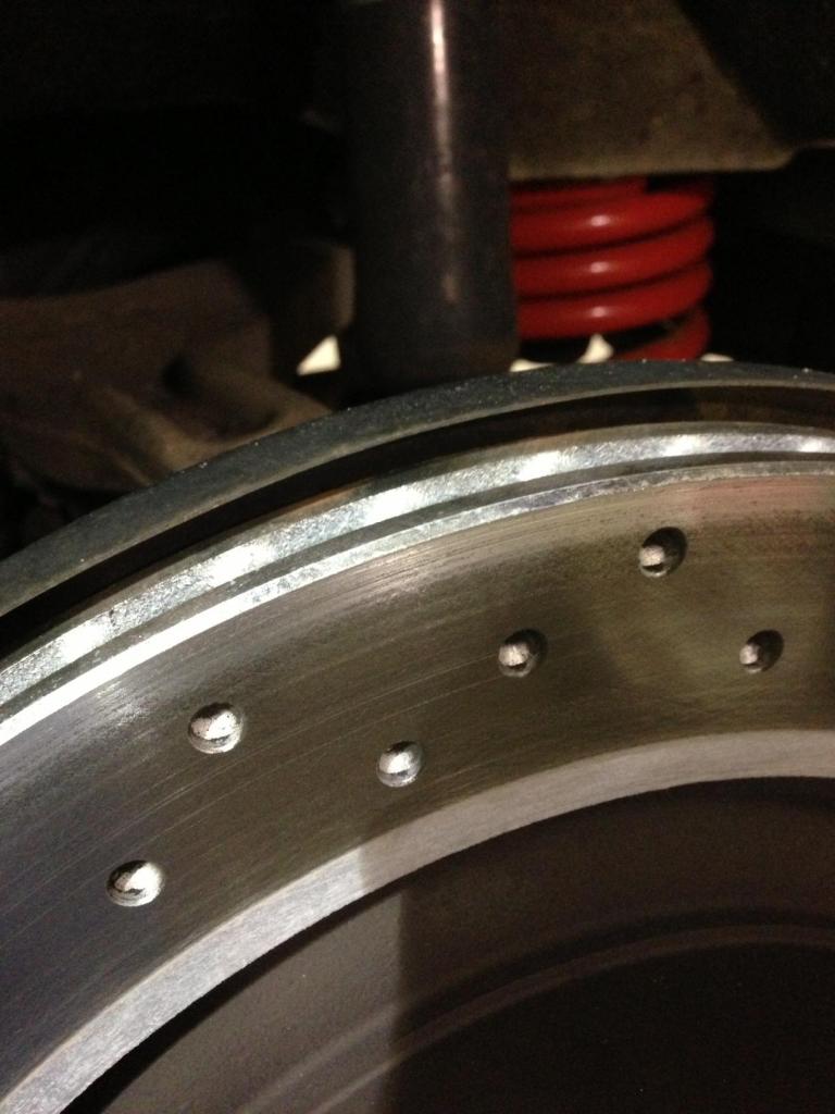

So I complained on the firestone website and received a call within an hour from their division rep in NJ who said to bring the car back and they'd check it out for free. They lifted it up and we took the wheels off and the first thing we noticed were grooves towards the top of the rotors....mind you these pads and rotors are less than 1 week old.

This is just a guess, but the wear pattern tells me the wrong rotors are installed.
The wear pattern is too high, like the rotors are too small.
Did anyone mach them to the originals?
