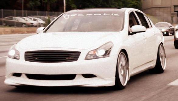

Im the one apexi was talking about. Ive got -4.2 camber in the rear. its completely maxed out. Attached a picture
Attached Thumbnails Camber setting? Need help on this one guys!!!-camber.jpg
