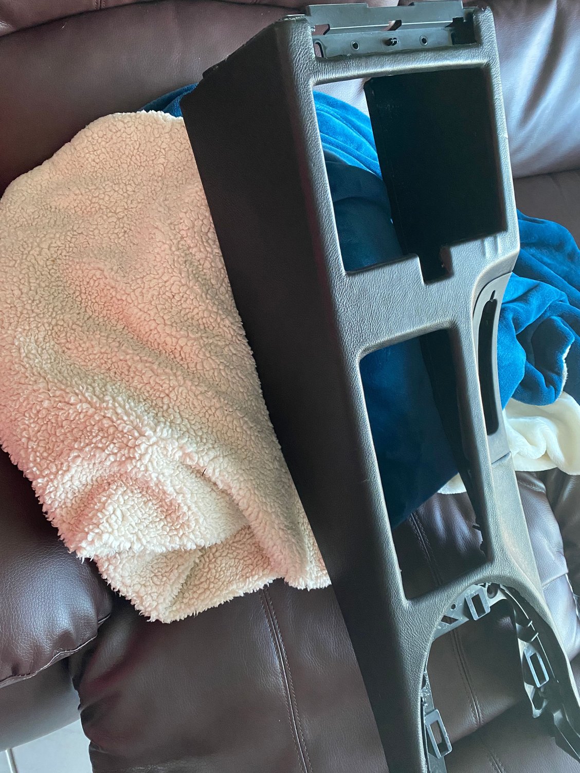

Finally got the carpet back in my car, floor is done! Either I did this really slow or it’s much more difficult and time confusing than it appears. I think the floors took me like 30-40 hours. Although I could probably do it in half the time if I had to do it again.
I am not happy with the sliding cup holder cover. I tried everything and can’t get it to stop creaking. I tried to run a thin fabric along the tracks but it didn’t elongate the problem (70% import meant tho). I’m doing some fabrication on it instead. I’m removing the slider, and using the huge cavity that it usually blocks in the back to make a place to hold my phone. Ever notice there isn’t a good place to put your phone in the car?
All I have left is to rig some brackets since I’m not using the original brackets that house the slider b/ it sits too low with them. I’ll upload pics of the finished product soon.

You’re not wrong that its a time consuming task. I have been also detailing each piece as I put it back in taking apart the components, buttons etc and cleaning them. Then getting it back together and fit well with the added 1/8-1/4” is a little challenging too. I’m getting closer to the finish line. I’m down to the driver rear quarter and rear seat. I also need to get the doors finished but I might need to get some more material. I didnt realize the massive cavity that are the rear quarters in the coupe. I ended up using an initial layer of the butyl sound deadener, followed it with the insulative liner, then bought some foam acoustic panels that I used spray adhesive to layer in, then filled the rest of the space with denim roll insulation. Made a HUGE difference. My plan is to get everything back together hopefully today or tomorrow.

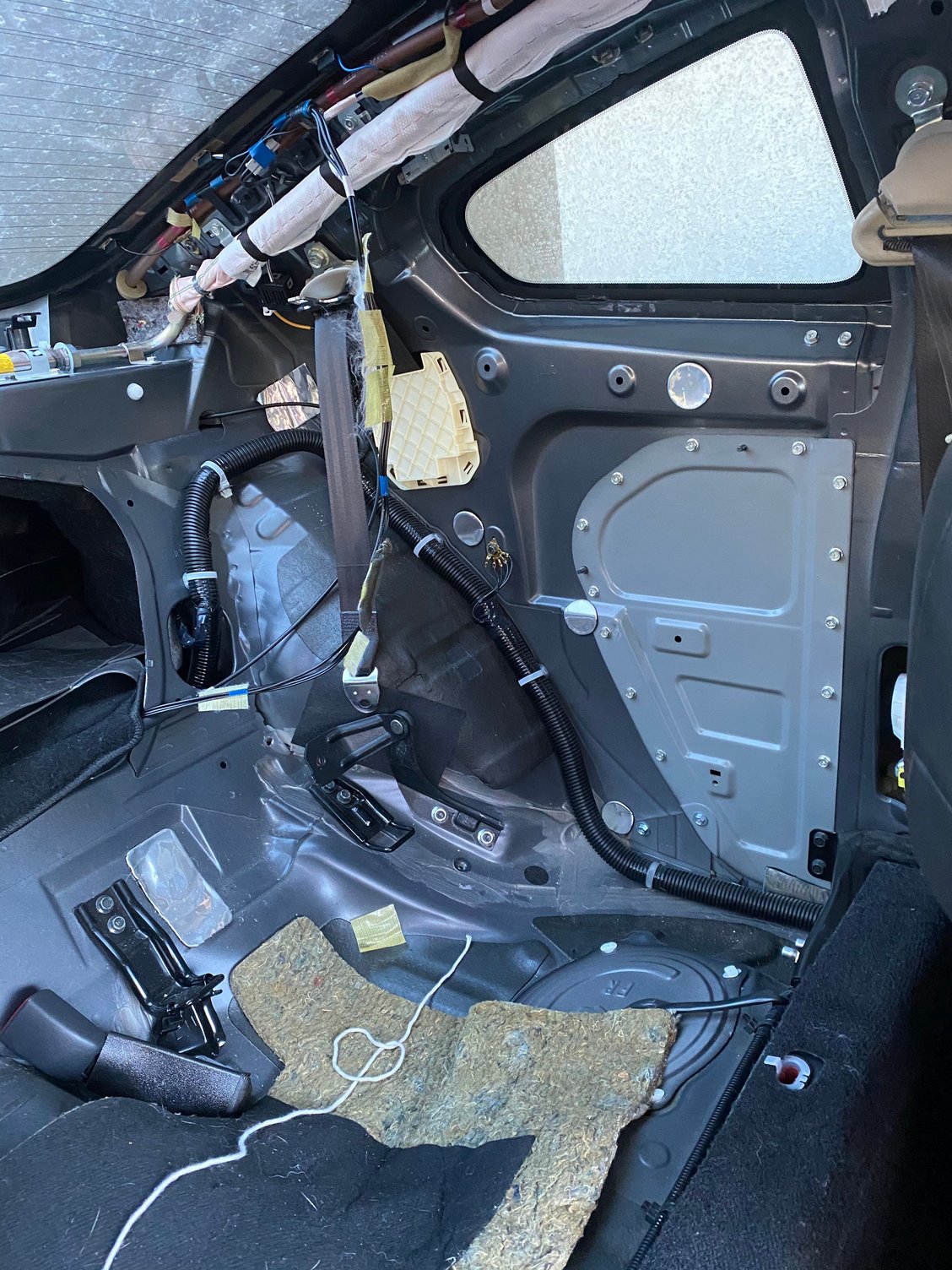

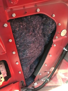

Oh wow. Glad I’m not the only one crazy enough to do this. I have been brainstorming on how to attack the the rear. I was wondering how bad it was under the qtrs and debating if I wanted to get inside or just lay mlv ok top. You have a pic of the inside? If you are laying mlv, you have any pics or suggestions on how to cut the rear pieces?
My driver side carpet did not go in that great. It bulges a little near the gas pedal. Also, the styrofoam foot support (maybe you dint have this if you aren’t 6MT?) is a disaster. It’s really loose and I need to address it. Not exactly sure how. Why styrofoam Nissan, ugh really??
I too am leaving the doors for last. I may need some more CCF since I messed up so many pieces I have a lot of scrap. I probably have enough MLV still.
Here is the rear qtr we are talking about. And that rope is my tied to my trunk latch b/ it stopped working at some point and I don’t know why

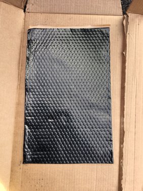

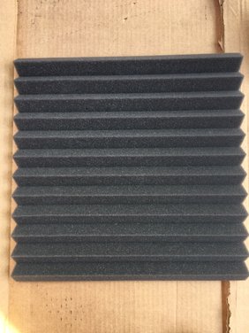

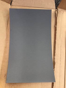

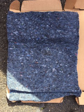

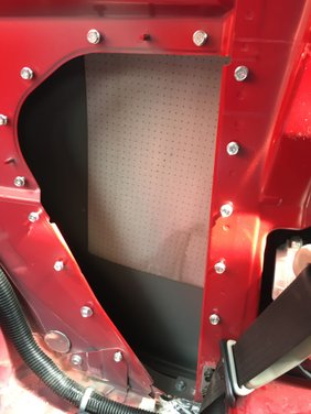

I think you really have to open up that panel to get inside the rear quarter, it is a massive amount of empty space and it stretches all the way to the trunk. I went at it from both directions. Fortunately I have long slim arms and hands that I had decent reach the whole way through. I used the Noico products both the butyl sound deadener and their 150 & 315 mil liner (for the most part only used the 315 in the trunk). It took a bunch of time and material to do the quarters but absolutely worth it. I generally try and waste very little, even when I am cutting odd shapes I found places to to fill little gaps. Here are the various steps I took:
Inside Rear Quarter
Noico Butyl Sound Deadener
Noico 150 mil Liner
Foam Acoustic Panel
Denim Insulation
All lined and filled.
I also then lined both sides of that panel with both deadener and liner, it completely filled the area and it makes all the difference. I got everything back together this afternoon and turned on the stereo, the car is completely dead quiet (except for the doors).
I know what you mean about the dead pedal, it was a giant pain because those stupid plastic clips that hold the styrofoam screw in which I didnt realize so when I took it out it stripped and the styrofoam was jacked up. I actually ended up cutting pieces of my Noico adhesive liner to reinforce the styrofoam. Once the carpet went in and all the other panels were in place it is nice and firm. The only other advice I can offer is to test fit panels before you stick things in place permanently just to make sure things fit back ok.

@KidJai06 Great stuff. Thanks for the info. I guess that answers my question and I’ll be opening that up too. As far as the trunk, I feel that if I get a good mlv seal around the backseat I can ignore the trunk. I’ll lay some cld in it but I don’t think it needs the full Mlv/ccf treatment if I stop the noise from backseat. What are you thinking for trunk?
I also tried to fix the footrest by placing cld to remake the broken slats that go into the clips but it didn’t really work for me. My clips are also stripped.
I wish I could a heavy duty 3D printed one like Rochester said, but I have no clue about that.
I’m trying to make some brackets for this stupid cup holder now. Hoping to finish tonight.
The leather wrapped center console is Dope. I will need to have the armrest done by a pro tho. That’s real upholstery work. I wasn’t originally going to do the center but given it all connects to the dash having a change in material would look bad.

I did the trunk just as I did the rest of the car, with the exception of using the thicker (315 mil) liner. If you take out the side carpet liners in the trunk you can actually see how the quarter panel cavity connects over the wheel well all the way to the tail light. There is little to no deadener from the factor for such a big piece of metal. I have future aspirations of upgrading my stereo so I want as much of the sheet metal as dead as I can get it. I admittedly geeked out a little when I did a knock test on the stock side vs. the first side I deadened. I have to say I am pleasantly surprised by the Noico products, especially given the price. I think when totally done I'll have about 108 sqft of the butyl deadener, 90 sq ft of the 150 mil liner, 20 sqft of the 315 mil liner, 10 - 12"x12" foam acoustic panels, and 4 - 2'x4' rolls of denim insulation. Putting me at less than $400 for the entire car.
