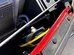

Horns are a super easy way to upgrade your car by replacing the generally weak sound from the OEM horns. Overall cost for this upgrade was less than $25 and took about 1.5 hours on a fairly difficult install (relative to other horn replacements). I highly recommend this for anyone and it’s easy for anyone to do.
Here's a link to my write up:
https://oppositelock.kinja.com/diy-h...ers-1841458146

My question to anyone here is how the OEM ones work. Unless the factory wiring starves them from amperage they should work the same connected to factory.
As far as I can tell, the oem wiring isn’t a big enough gauge so it doesn’t provide enough power. That being said, I don’t understand wiring at all, so I could be wrong. All I know for sure is that you need at least a 16 wire connected to the battery and a larger relay for the full power to the HELLAs.
