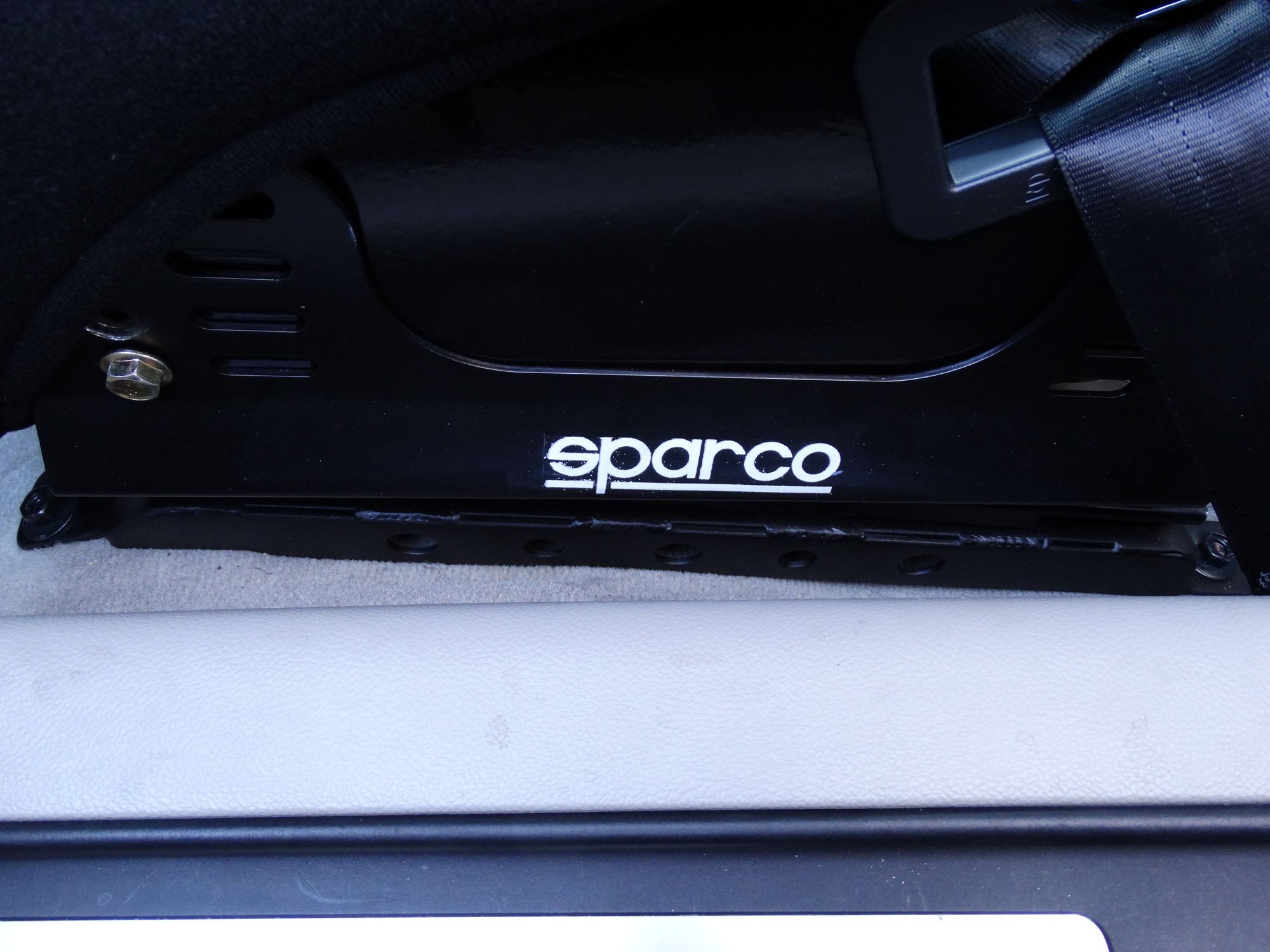

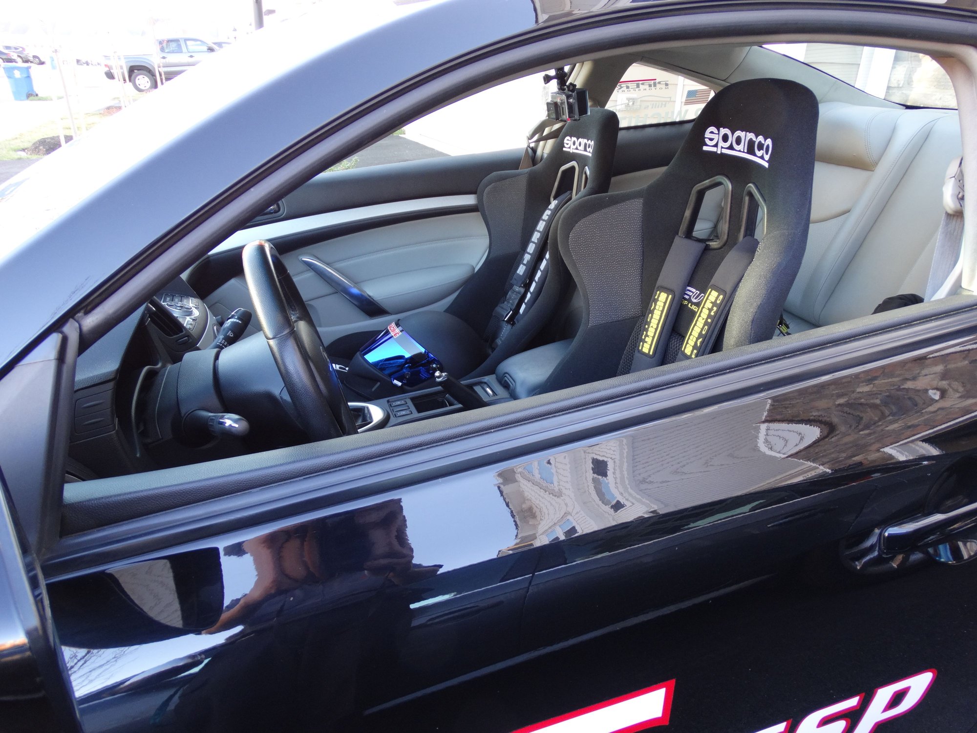

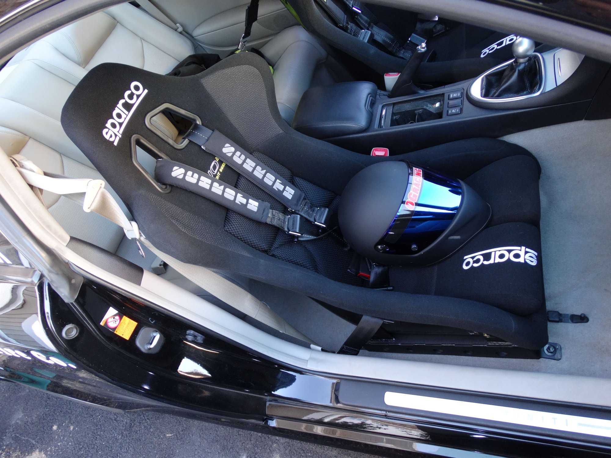

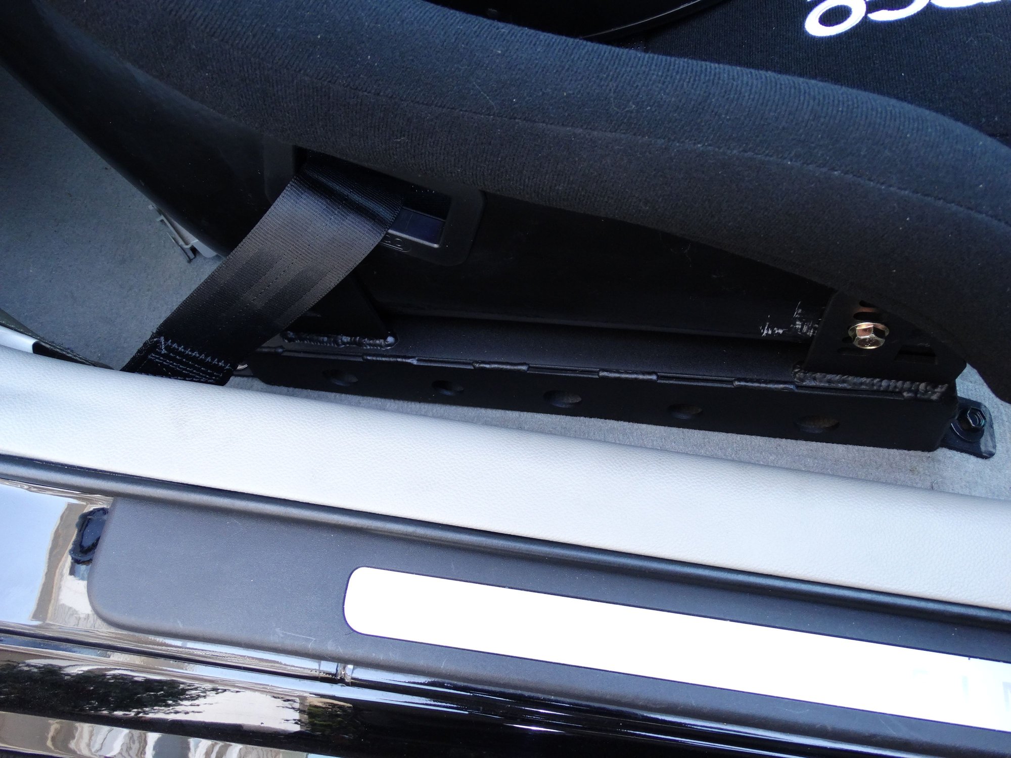

Driver's seat is on Sparco double locking sliders.
Driver's side sits a bit higher than the passenger.
Passenger seat is fixed mounted.
Clean welds!
Another shot of the clean welds.
Schroth Rallye 3 ASM harnesses keep the driver and passenger held in.
