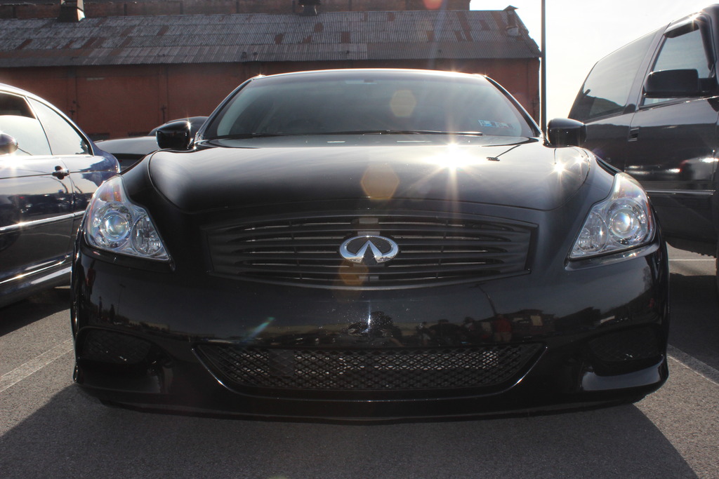

Old Apr 21, 2015 | 04:25 PM
blackstorm's Avatar
blackstorm
Joined: Aug 2008
Posts: 11
From: Easton, PA
Thumbs up
I just painted mine 2 weekends ago with matte black plasti dip. Honestly, you can remove the grill if you want it to be perfect, but i thought it would be too much work after i looked up a vid on youtube of some guy taking the grille off. I just shoved my fingers behind the grille to release the front emblem from the grill.. Then I used 3M masking tape and taped off all areas around my grille and headlights and went to town. I followed a plasti dip vid on youtube by some guy named Fonzie doing a VW Jetta. I hit it with a light even coat every 20 minutes in my garage, about 5 or 6 coats in total, then let it dry inside overnight and it came out perfect...

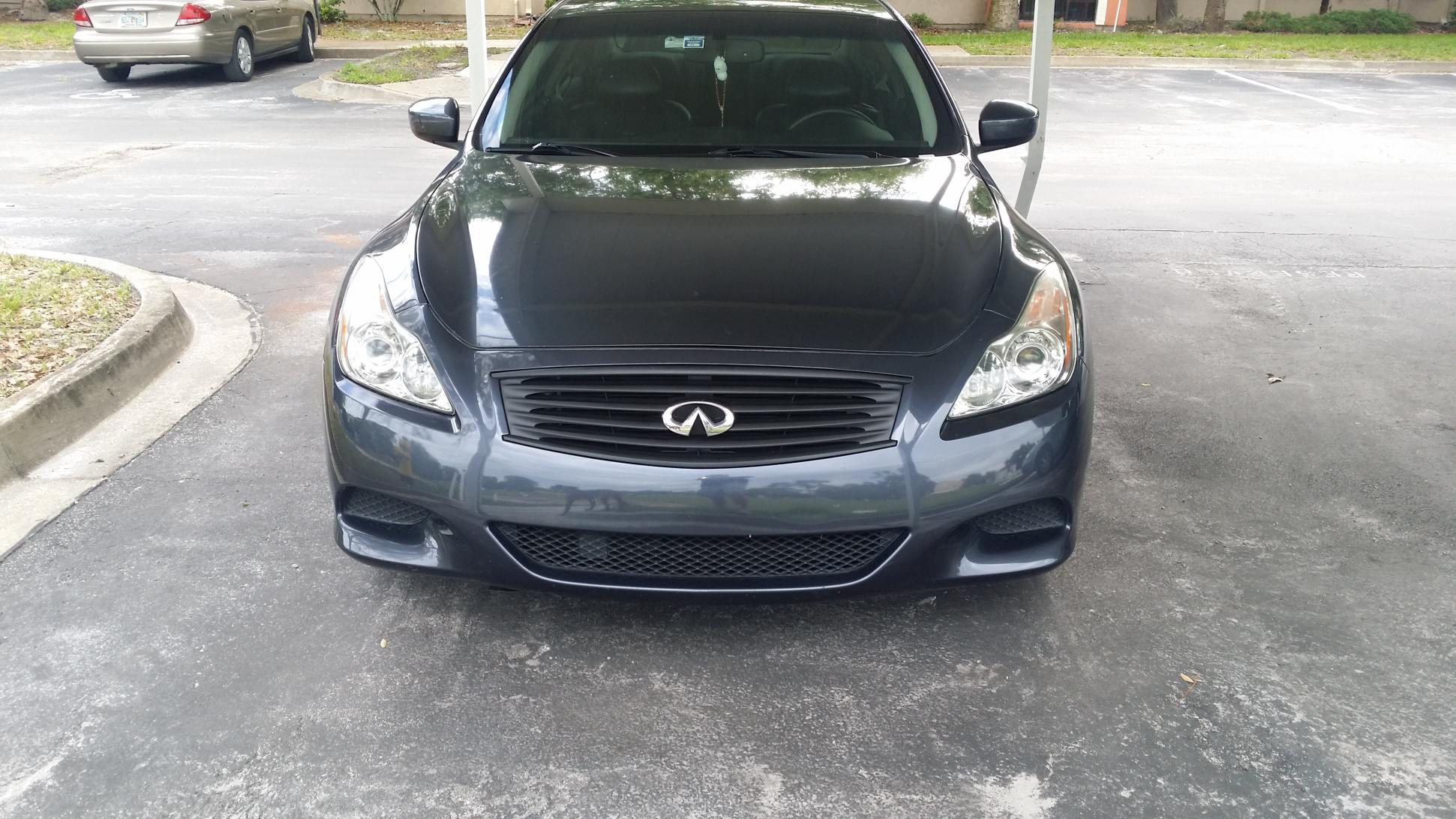

Old Apr 22, 2015 | 08:57 PM
buggzg37s's Avatar
buggzg37s
Joined: Apr 2015
Posts: 11
From: Melbourne FL
Thanks for all the input I ended up going with plasti dip just encase I didn't like it but it came out really good.
Old Apr 22, 2015 | 09:09 PM
properdropper's Avatar
properdropper
Joined: Aug 2014
Posts: 242
Likes: 30
^^^^ looks really good man! your G def looks a lot better with a black grille like that!! props
