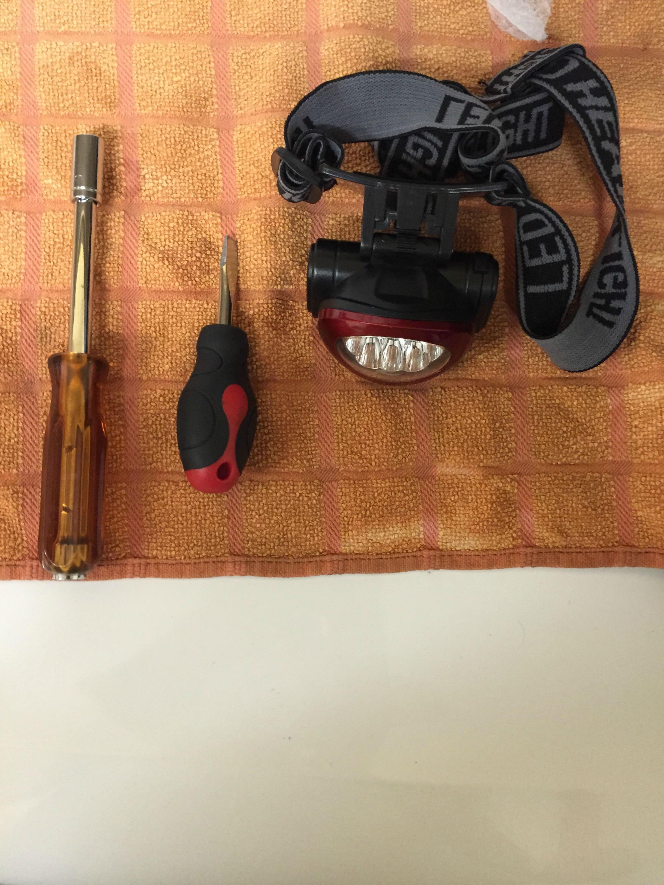

Tools: Flathead screw driver, 5/16th's screwhead, headlamp flashlight

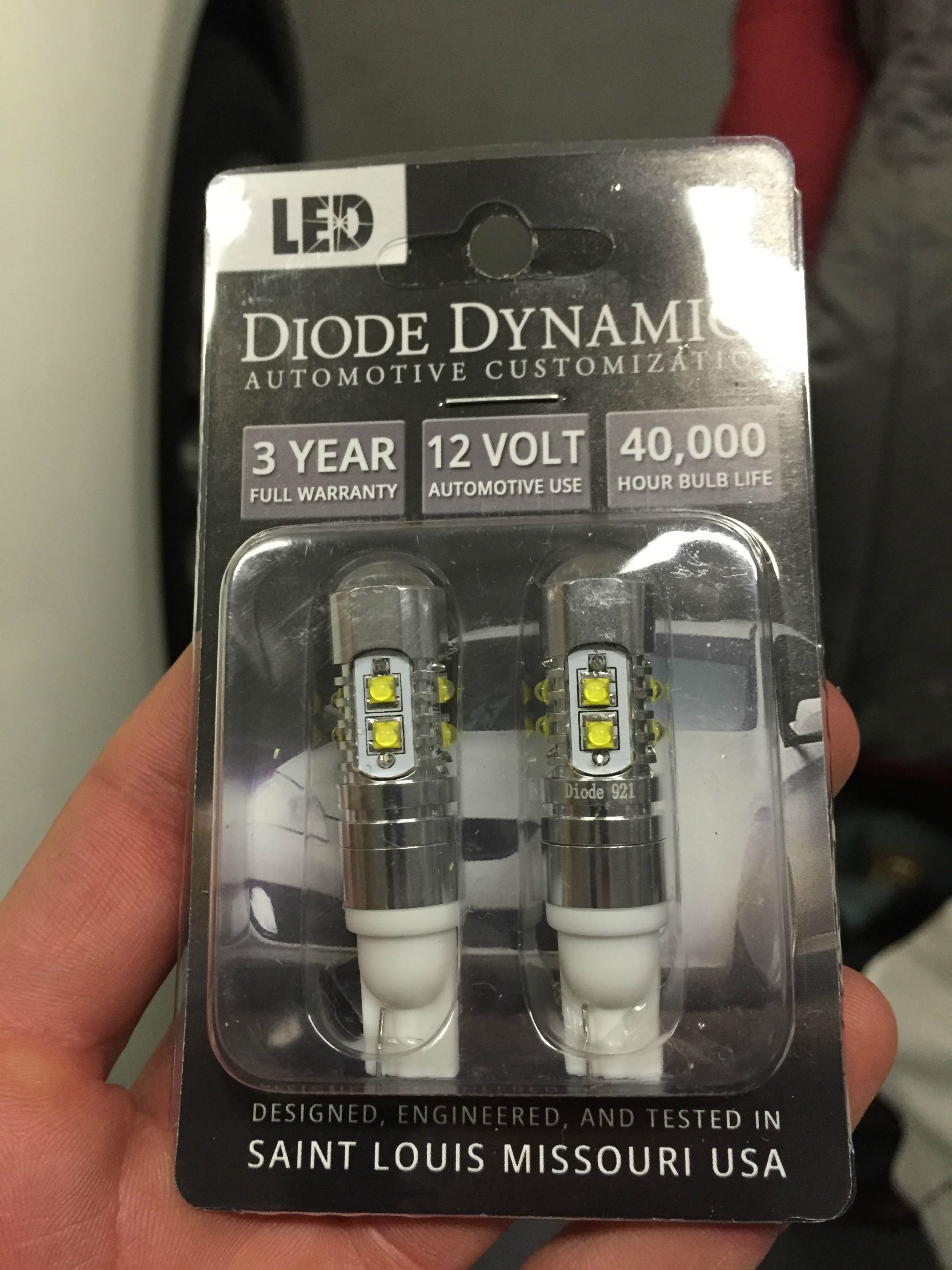

Quality: The bulbs are great quality. They're massive and solid. They don't look or feel cheap at all. It feels great in the hand and you can tell its not something cheap.
Review: Diode Dynamics XP50 Reverse LEDs-it5nsfp.jpg
Comparison between stock and XP50

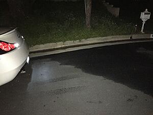

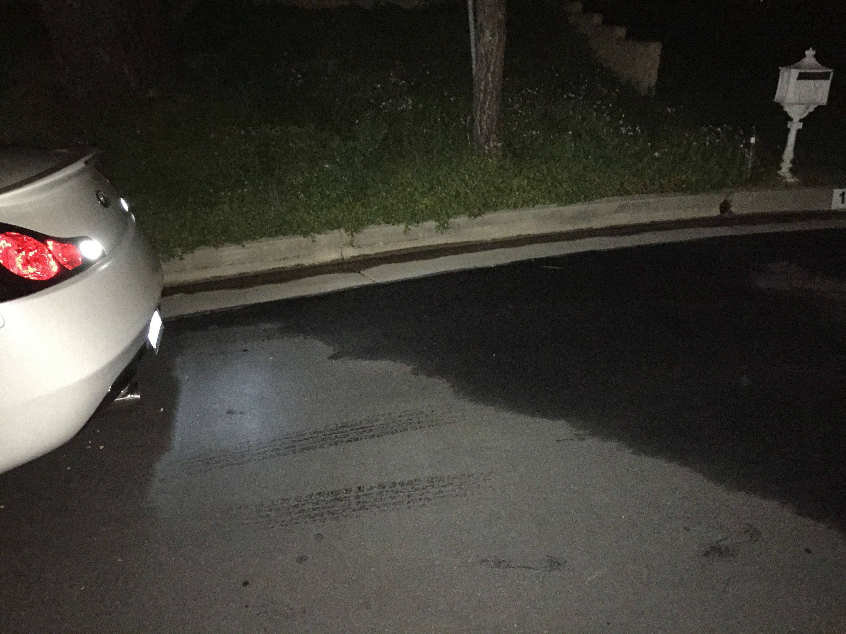

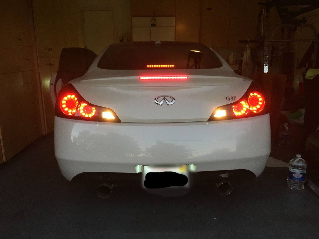

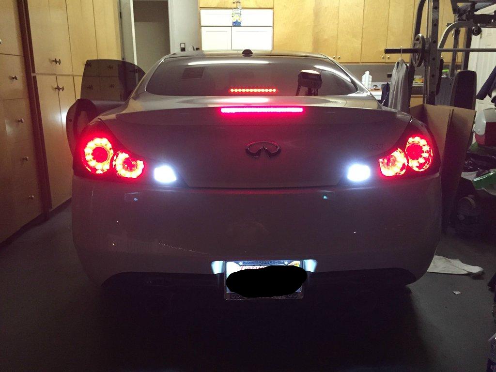

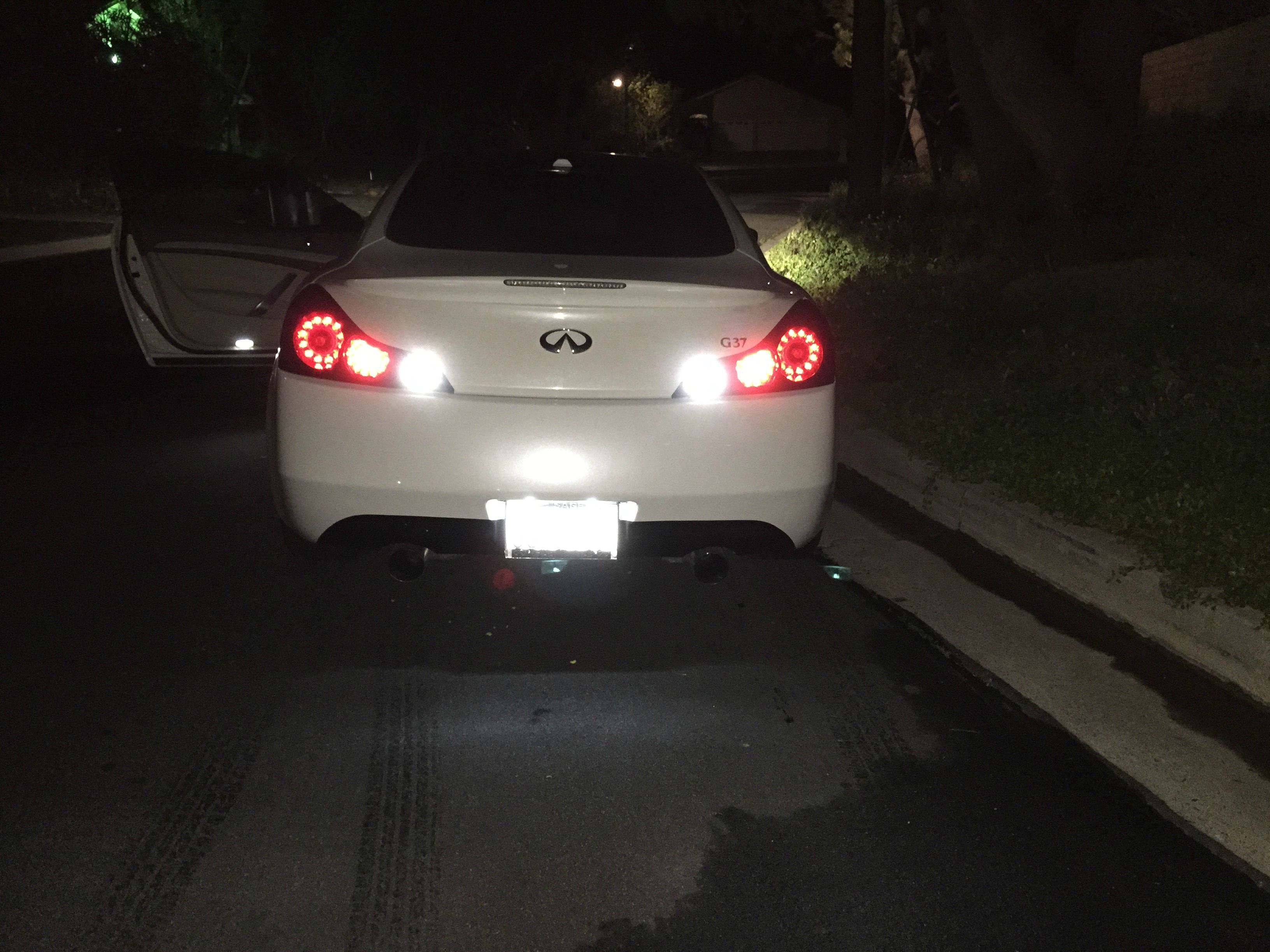

Brightness: I'm not sure if it was my unreal expectations for a $90 reverse light, but I was expecting something brighter. This is not to say that these bulbs are not bright. They're definitely high strength LED's, but I was expecting something more. Maybe my expectations were unrealistically high, who knows. They do help at night, though. I've had to roll down my windows considerably less since I started using these.
Before:
After:
Outside Pics:
Review: Diode Dynamics XP50 Reverse LEDs-jdeoe7m.jpg
Review: Diode Dynamics XP50 Reverse LEDs-tcusypi.jpg

They are not as bright because they are pointing down inside the housing. Since they point down and not outwards towards the rear, they lose a ton of output due to incorrect angle of projection.
You need an L-shaped led that points the projection beam to the rear.
