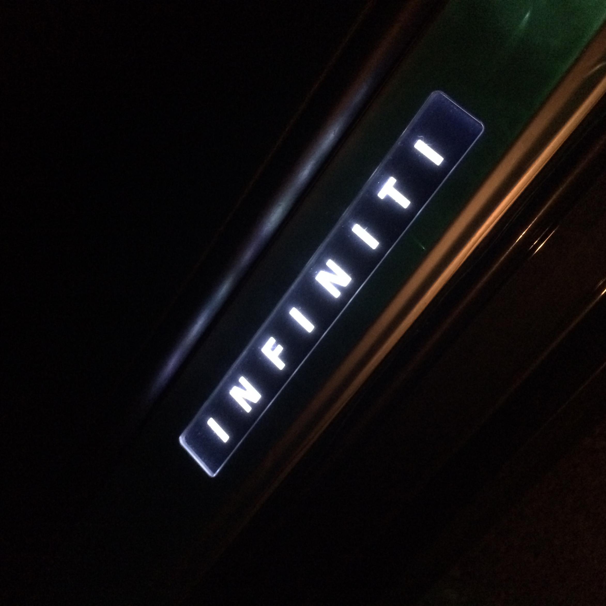

They sure do look nice. Can't turn them down for $99 + free shipping
Please pardon the terrible iPhone pics. I'll need to snap some photos with my Nikon
