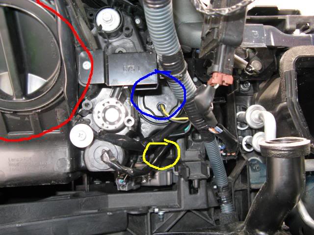

Your best bet is to remove the driver side front wheel and the wheel arch cover. Then try to reach in and flick the lock.
Here is a picture looking in from behind the wheel well. You can see the hood latch.

if the cable didnt fall off it could be pinched. happened to me on the passenger side. try pulling the cable manually with some pliers to see if its snug tight while some one else pushes up and down on the hood by the clip. if its loose i'd go with modme's post
