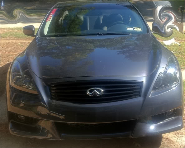

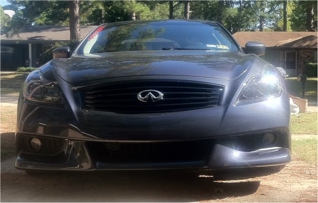

Without the chrome.
Old Nov 11, 2011 | 02:30 PM
  #419
biron's Avatar
biron
Joined: Jul 2011
Posts: 159
From: Bay Area, CA
^^^ looks better. did you use plasti-dip?
