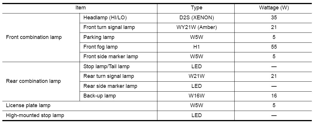

the citylights come on with the regular headlights and stay on when the fogs are turned on
Originally Posted by Mike6mt
What bulb size are those?
fogs: h1 citylights: 194
This might help...
