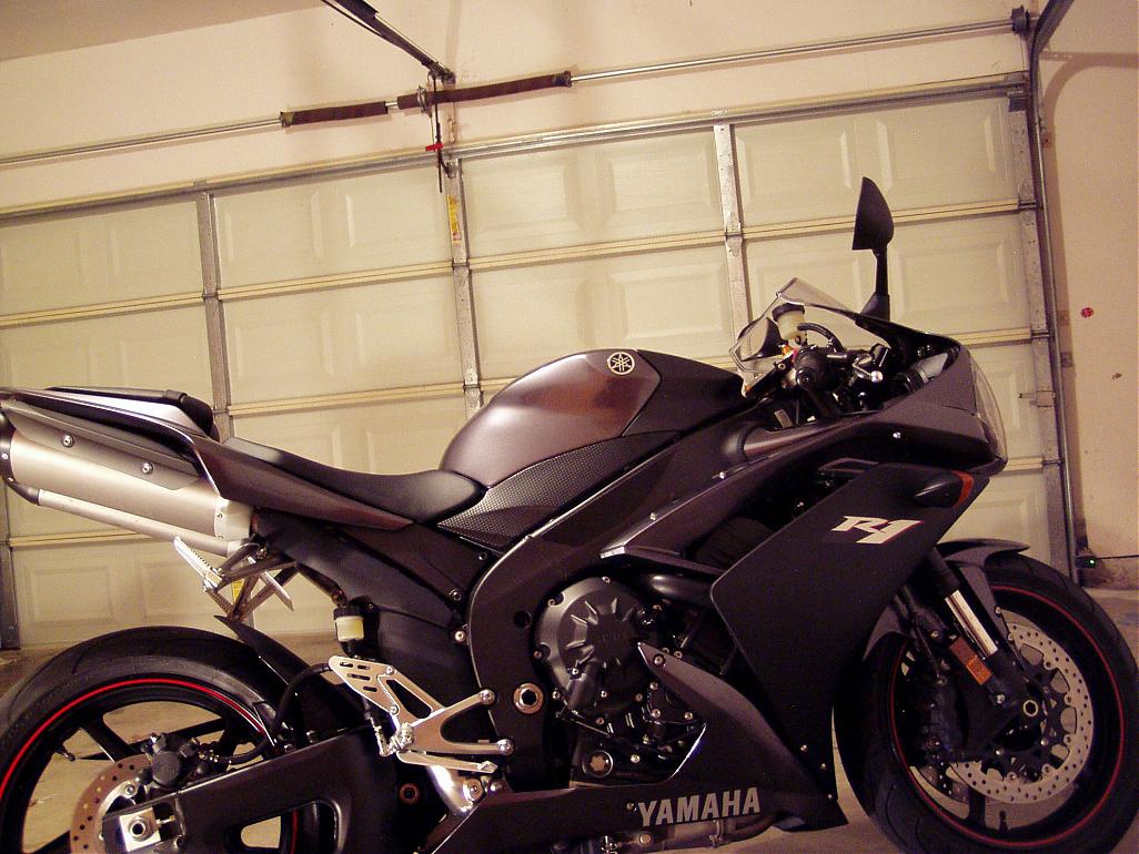

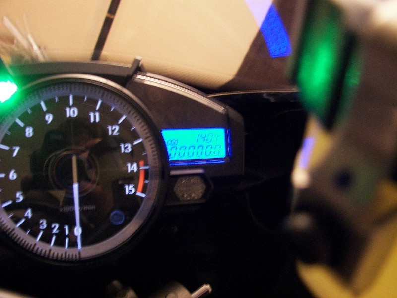

UNV-IT46's Avatar
UNV-IT46
Posts: 3,985
From: SoFlo
Originally Posted by speedracerg35
here ya go:
all lights on
just citylights
my r1
nice R1 here is my 07
Attached Thumbnails Who has changed their Parking/City Lights?-mud-guard-removed.jpg   Who has changed their Parking/City Lights?-still-a-virgin.jpg
