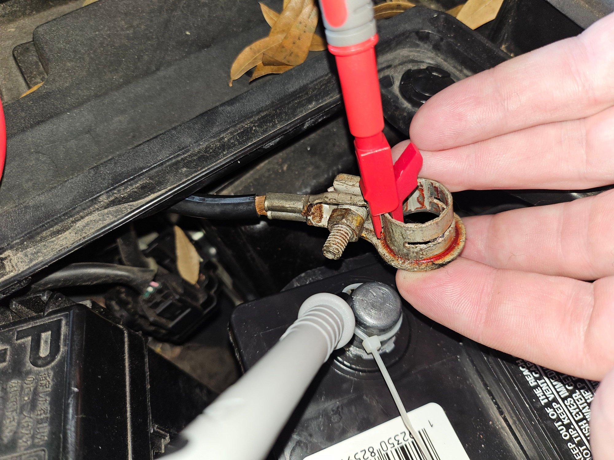

I may have been premature with my diagnosis. I might have pulled the fuse in question before the car had "gone to sleep". With the fuse plugged in, i get a draw of .16A for 30 minutes, then it drops down and fluctuates between 60-110mA. Is that normal/within range? I saw 50mA is desired but not sure if this is close enough. Im replacing the battery terminals today as they are a little corroded and am monitoring the amperage throughout today for random spikes, but I maybe back to square 1 😞

Make sure you pay attention to the condition of the ground wire. It's a small one and it has a LOAD sensor going through it. Slight corrosion will start to deteriorate the cable and being that it's the only wire to the battery you want to make sure that this is in good condition.

Are you
referring to the ground wire directly connected to the battery?
