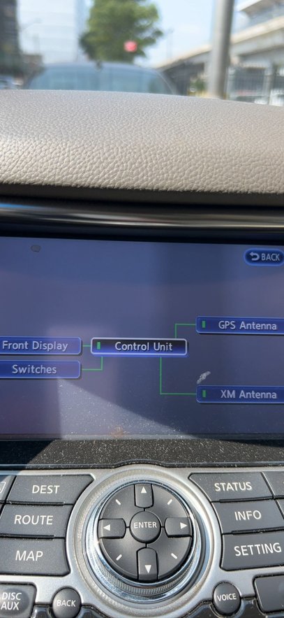

I put the nav in diagnostics mode and all the systems are green. Would this still indicate the control module is still bad even though the system is showing it green? See attached photo. Front display and switches is also green. It’s just cut off in the photo. Thanks!

"Control Unit," in your pic above, refers to the AV headunit in the center stack, NOT the AVM or SONAR control unit(s). There should be a separate screen for those systems:
The U1000 code indicates that the respective modules have lost network communication (CANBUS) with the rest of the car. If you do not have the above screen, then you have two (2) possibilities: bad module(s) or a wiring issue in the harness assuming power and ground are good.
