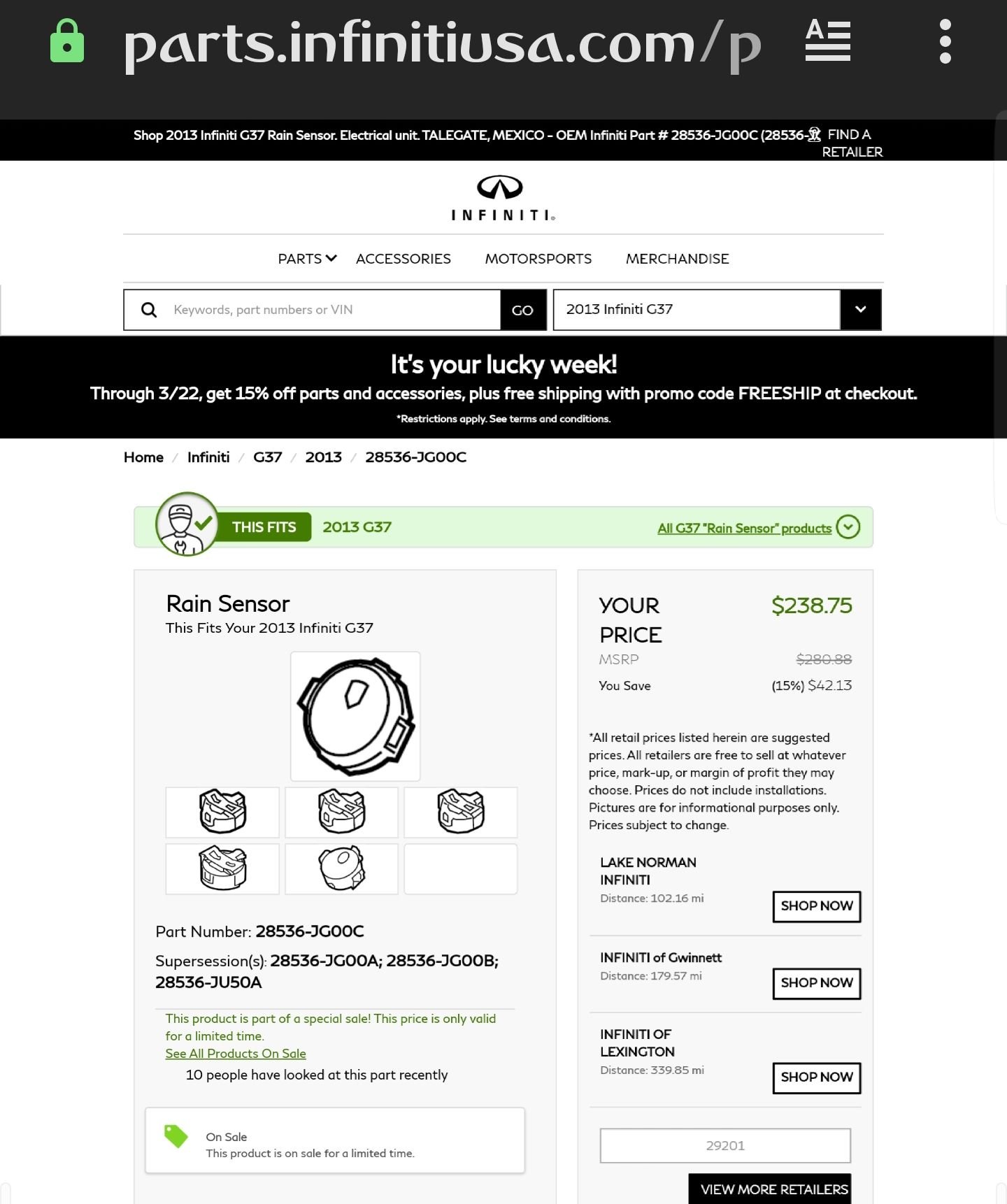

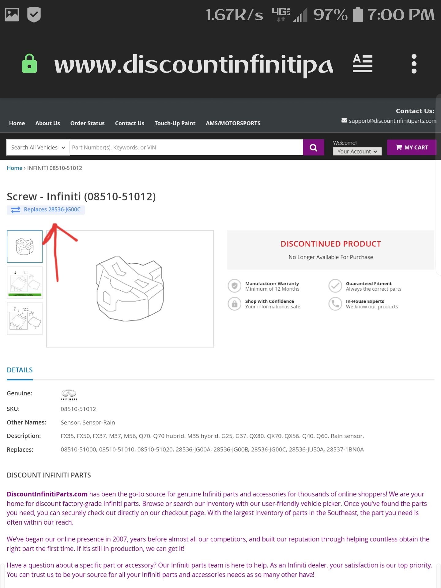

After further checking it is still available. It seems that discountinfinitiparts.com's web catalog is wrong. When I enter the part number for the sensor it comes back with a p/n for a screw which replaces the sensor (?):
But the parts.infinitiusa.com website shows it as available:
I apologize for the confusion. Usually the catalog at discountinfinitiparts.com is spot on- not sure why their catalog is showing incorrect results.
