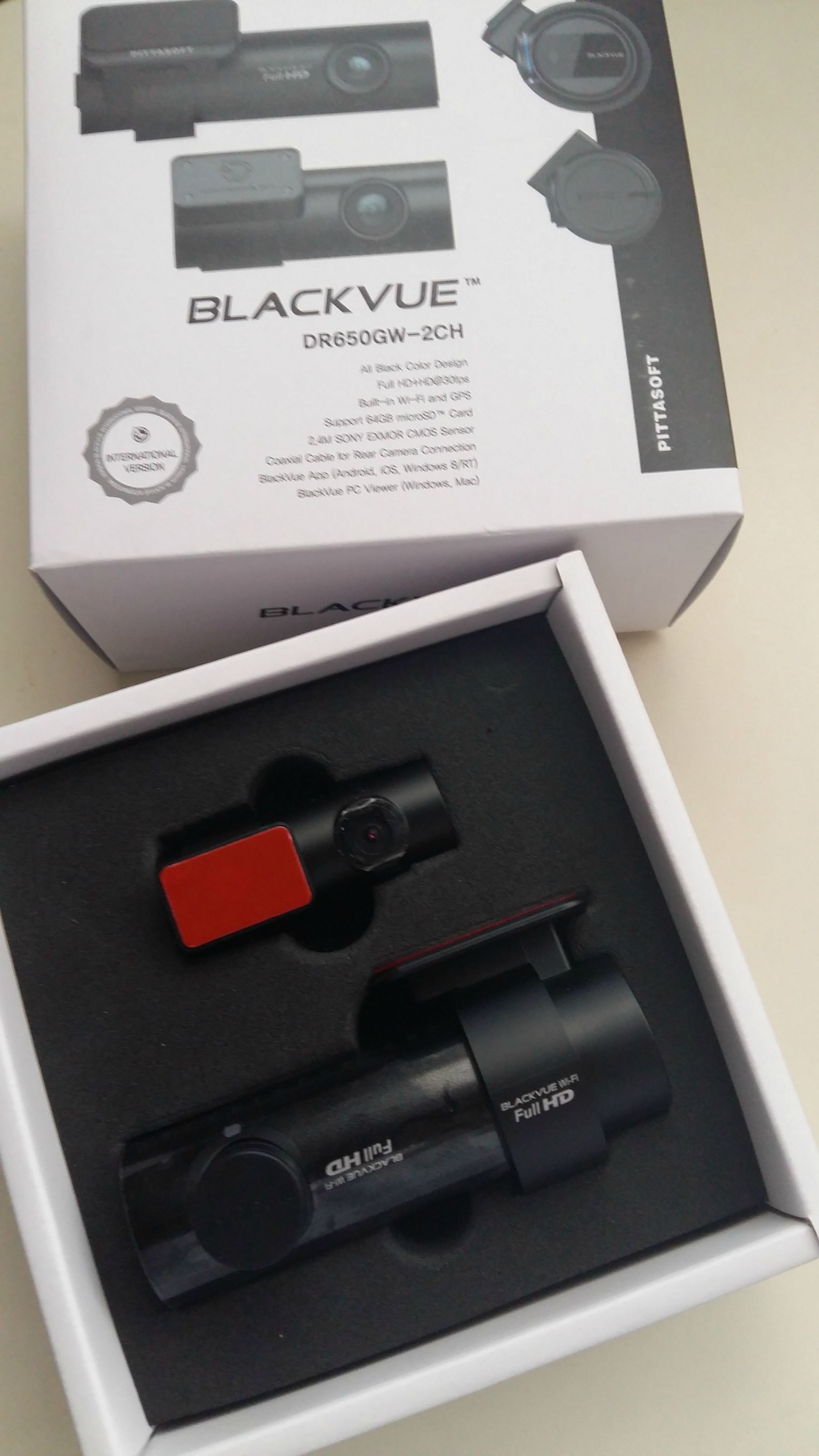

A Blackvue DR650GW-2Ch to be exact. http://amzn.to/293mk6x
Had a bad history of idiots hitting me (and claiming I reversed into them) and dinging my door in the parking lot.
So I decided to finally pick one up after getting my new Q60 last week.
Will install and post so videos maybe next week. Going to do a hard wire install by tapping into the fuse box.
