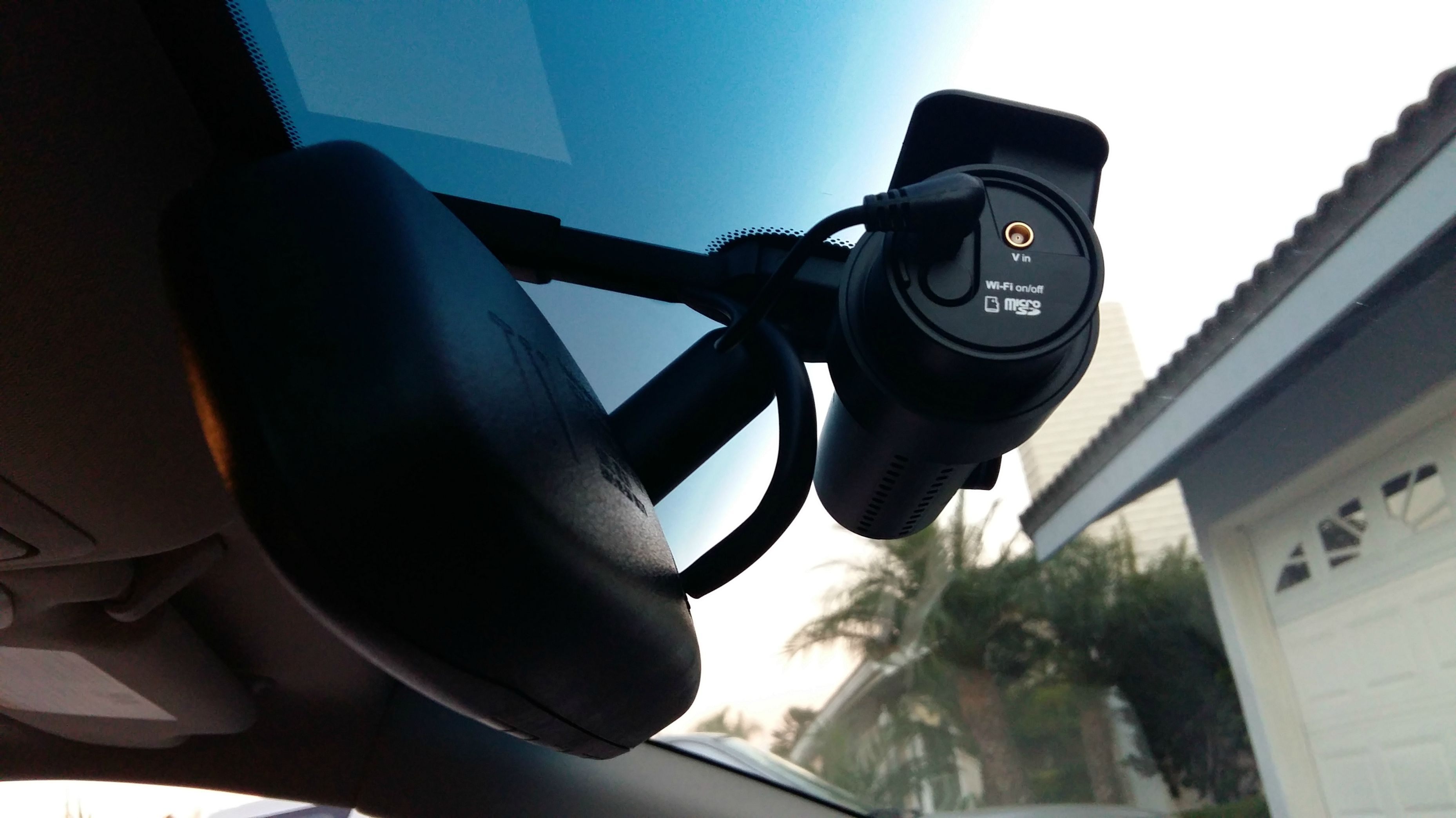

Just installed the front cam. Had to tap into a different fuse since there were some large plastic crap in the way on the other fuse. I tapped into the (Meter fuse 10A) and the (Socket fuse 20A).
Took a lot of zip ties. Tons of extra cable slack. Had the neatly fold the wires and tuck it under the fuse area. I installed the power magic pro controller under the steering wheel. Also, for the ground, I just loosen a 10mm bolt near the foot rest where other wires were grounded to and slid the ground wire into that bolt and tighten.
I routed the wires under the homelink plastic thingy and across the headliner, down the pillar and all the way to the fuse box. Didn't have to pull any panels, just carefully tucked it in. When all said and done, looks very clean and professional.
As for the rear cam, maybe next week. lol
