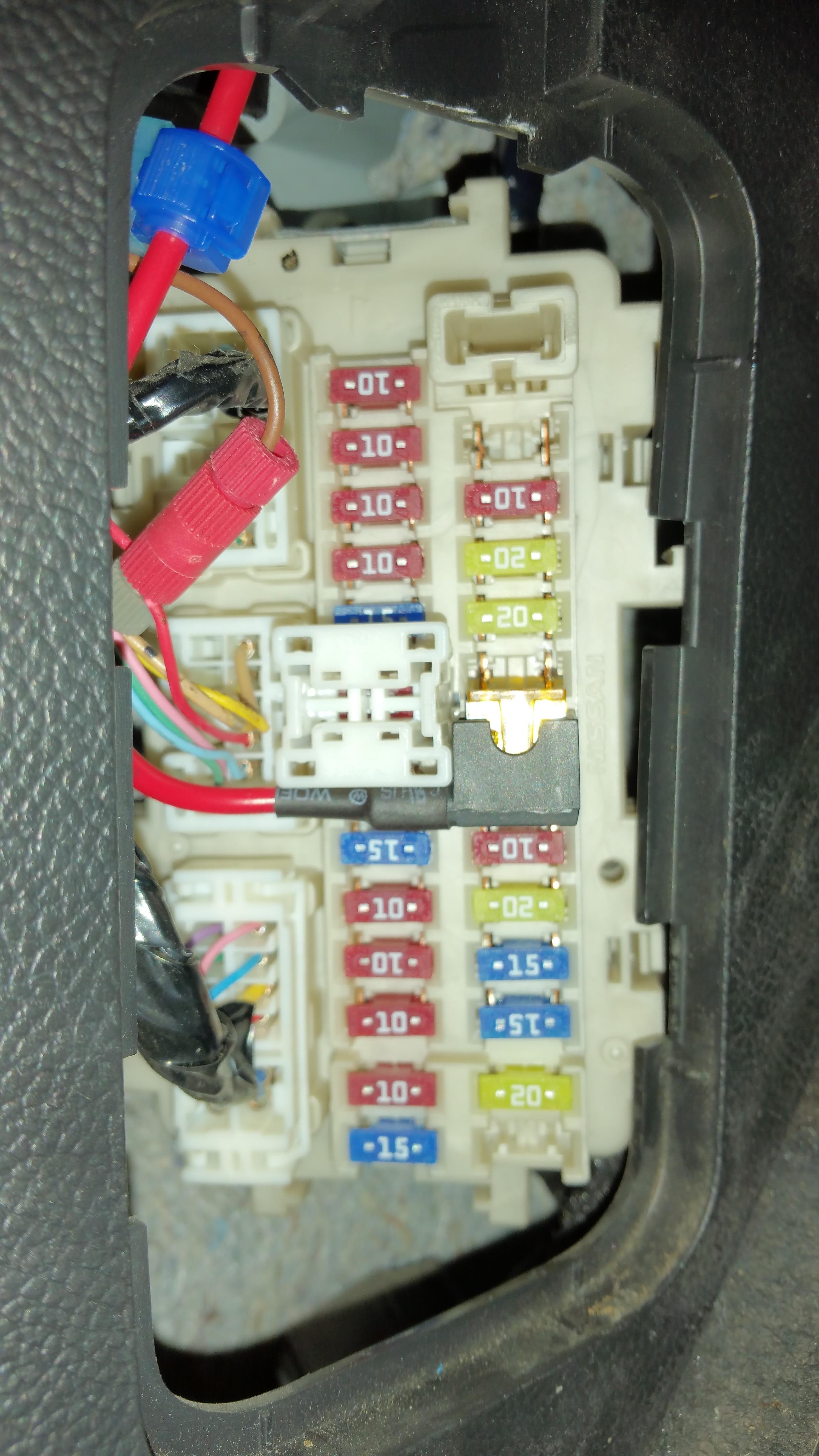

It made the install very smooth and very easy.
You essentially remove the existing fuse.
Then you insert the removed fuse into the fuse tap.
Insert the new fuse and you are ready to go.

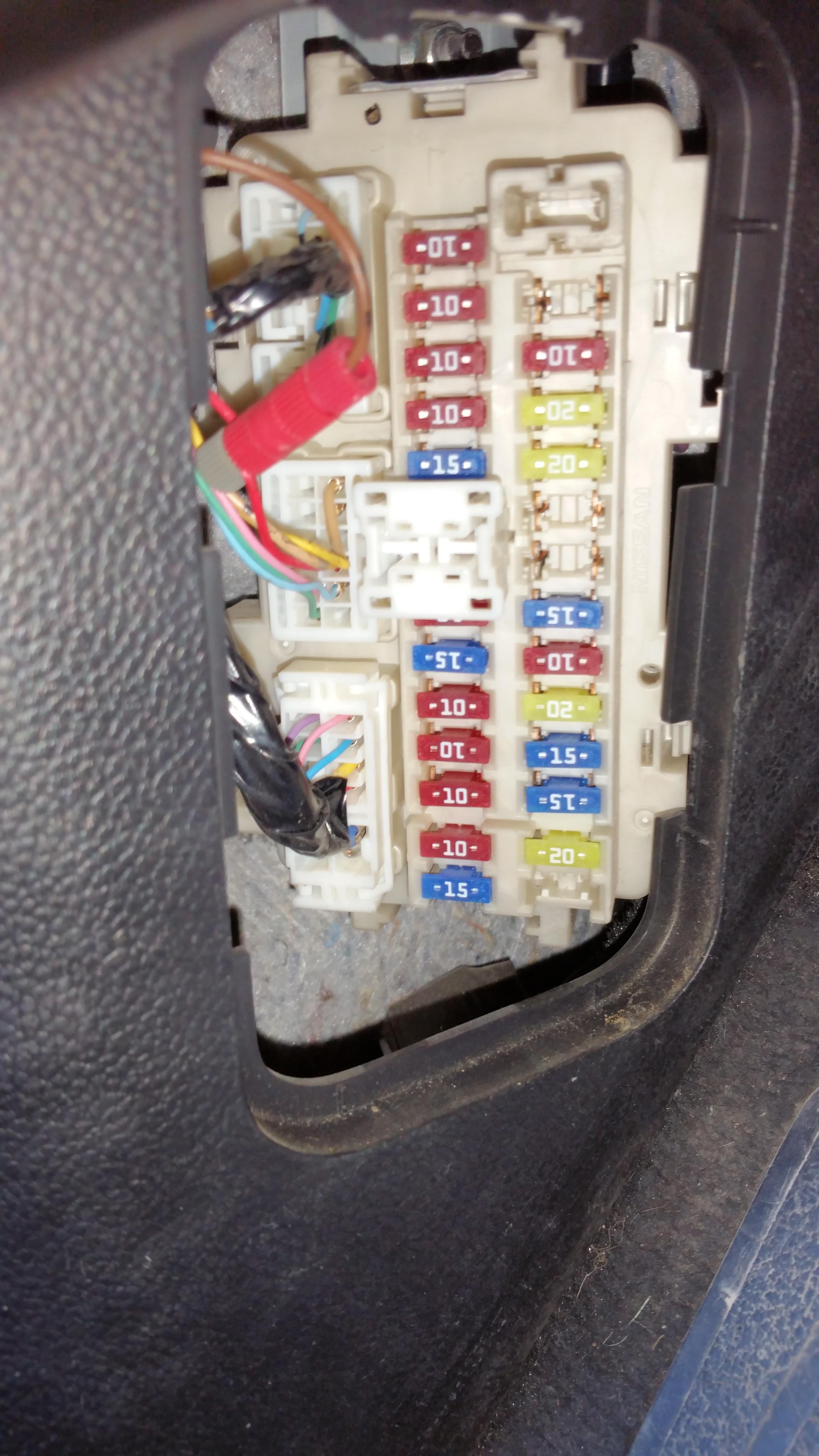

Original fuse box

Fuse tap installed

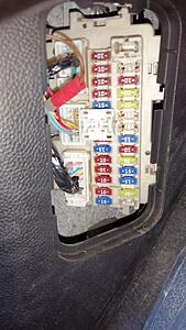

Fuse box closed... No buldges or awkward wiring sticking out
