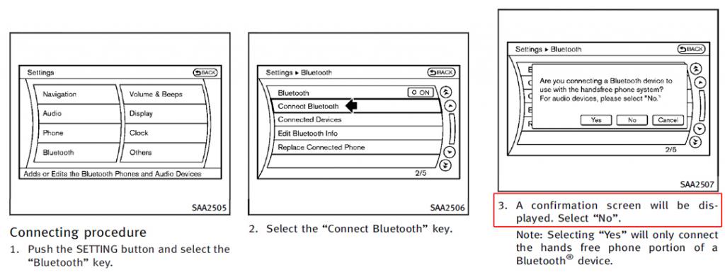

Here you go..see if this works for you. I outlined in red.
You do it one time selecting "yes" to connect as handsfree phone device. Then one time selecting "no" for audio device to stream audio files.
Old Sep 23, 2014 | 02:56 AM
irwins's Avatar
irwins
Posts: 21
Worked like a charm. Thanks man!
