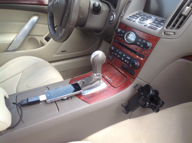

Old Apr 25, 2014 | 12:37 PM
crawdad8796's Avatar
crawdad8796
Joined: Apr 2014
Posts: 15
Thanks for the advice
Following the advice here, I was able to integrate my iPhone 5S. I have a 2009 Convertible with Nav. I used the small Apple lightning adaptor and the Scosche adapter. I can now control music, including Spotify and Pandora, charge from the Infiniti proprietary iPod connector, AND see track information on the display screen. I'm a happy man!
I just ordered the CableJive dockXtender which will hopefully allow me to plug in my phone when mounted to my Smart Tap phone mount. I wish the Infiniti cable was longer.
