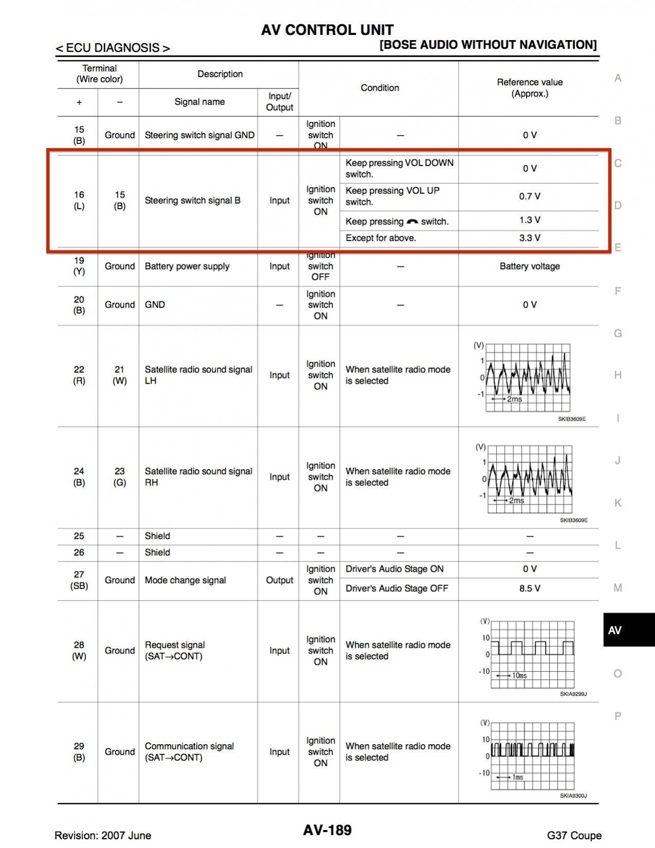

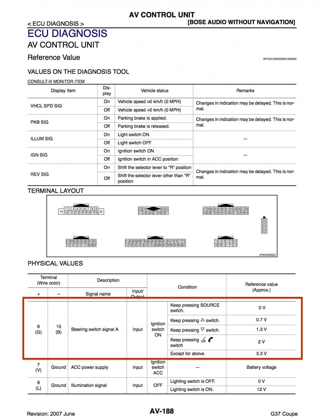

Now, this last idea would be pushing the limits of my knowledge....Possibly add in an Arduino microcontroller, or a raspberry pi to the mix, and then use that to interface with the existing buttons on the steering wheel and/or dash. Maybe skip songs playing from the tablet with the buttons on the steering wheel.
As for steering wheel controls, I think there is a cheaper and easier alternative. I haven't tried it myself, but it has good reviews. Once I finish up my other mini projects, this will be next. Check out this link:
RcJoyCon - Control Car PC with Steering wheel controls
Then look into your Factory Service Manual under the "AV" Section and find the wires going into the back of the AV control unit that carry the steering wheel control signals. Here is where I would splice into on my 2008 Coupe
Attachment 102332
Attachment 102333
