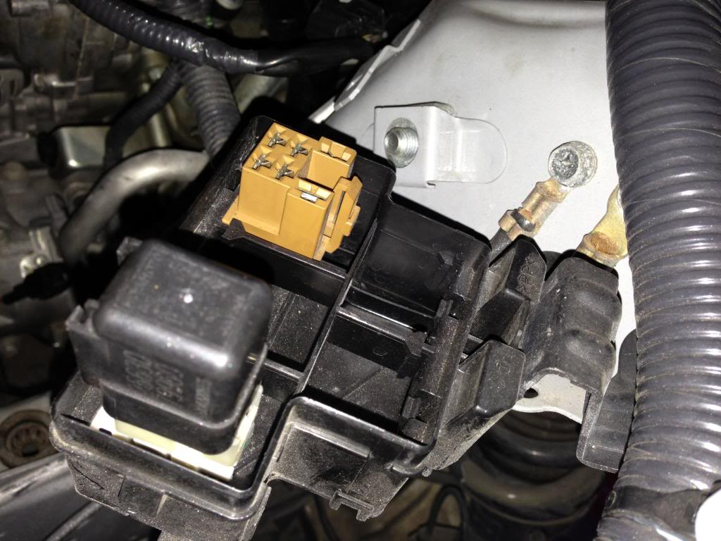

hey guys,
First of all register on this forum in 2010. I had a Maxima and purchased g37s wheel from a guy here. Long story shot sold the maxima and purchased a 2010 G37s from auction got a good deal. but there are couple things that were stolen of the car. I got most of them figure out but my AC doesn't work. My mechanic said it missing a relay. so this is what is seems like it could be. i don't have the cover for it went to dealership and they wouldn't tell me unless it get it diagnose from them. Can you guys check on your car what relay it is for. while it was at the dealership the guy told me there are 3 relay in that box but mine only have two. the box is located on the driver side next to the intake. Here's the picture guys.

I dont think youre missing a relay there. I've seen other G37s with a blank brown slot like yours. Another member used that empty relay socket to power foglights.

Here's a picture of it. The middle relay and the blue wire were added by the member for foglights. So yours looks right.

that really helps. I got the AC figured out as well the out side temperate sensor is not working if you jump those wires together the AC clutch kicks in so i have order a new sensor it wasn't snowing no outside temperature inside the cabin as well but never knew its contacted to the AC. Just in future if someone cant figured it out.
