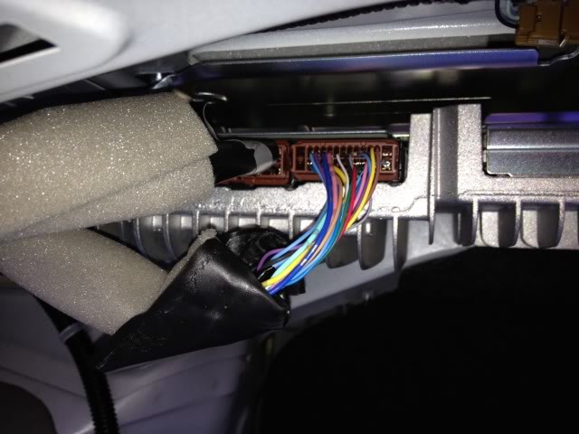

So I went through this whole post and I was all ready to go. Routed the power cable down the right side no problems. But when I got to the part where I tap in to wires 23-26, I ran in to a dumb problem ... I can't find the Bose amp.
EDIT: For you sedan guys, the Bose amps are mounted under the rear deck on the left side. Picture of the connectors below. The one you want to tap in to is on the right (that you can clearly see the wires). Hope this helps.
