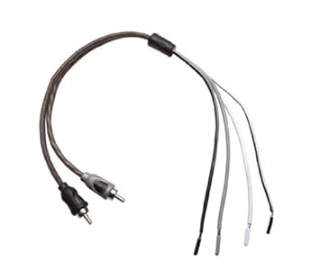

if your amp accepts bare wire, you're good. if it only takes RCA preamp inputs, you'll need something like this:

So I'll ditch the LOC and order that cable you showed. I'll try and post pics when the install is done.

Now that I think about it... Do I even need that cable? Couldn't I just strip any old rca cables laying around the house and have the same thing? I might go in that route if so..

you're going to dive into that harness to get the remote turn on anyway ... unless you want to run a line all the way to the fusebox in front. pretty easy with wiretaps - just strip back the sheath around the connector wires to give yourself some room.
you can do that , too (i did it for another car).
