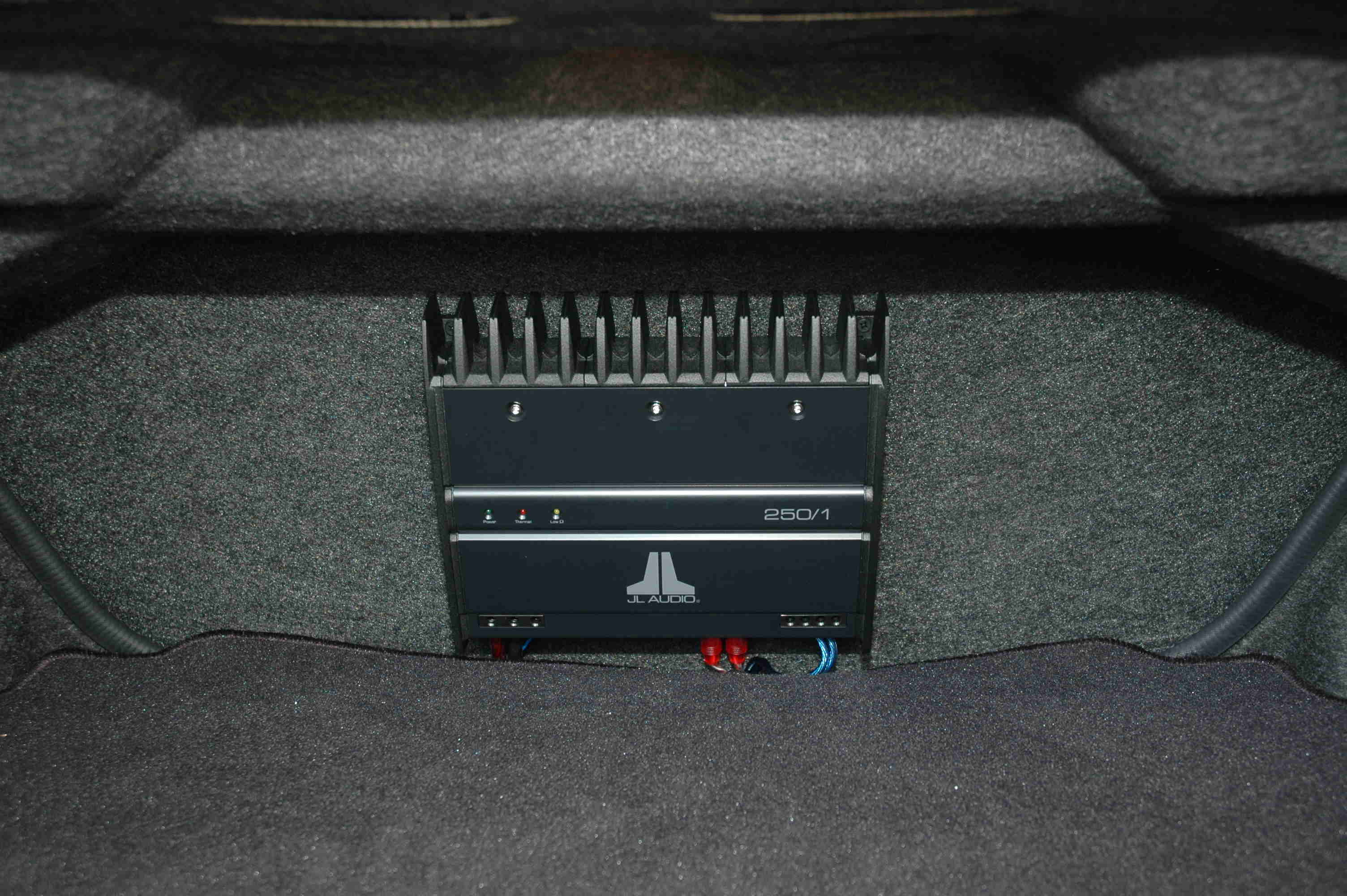

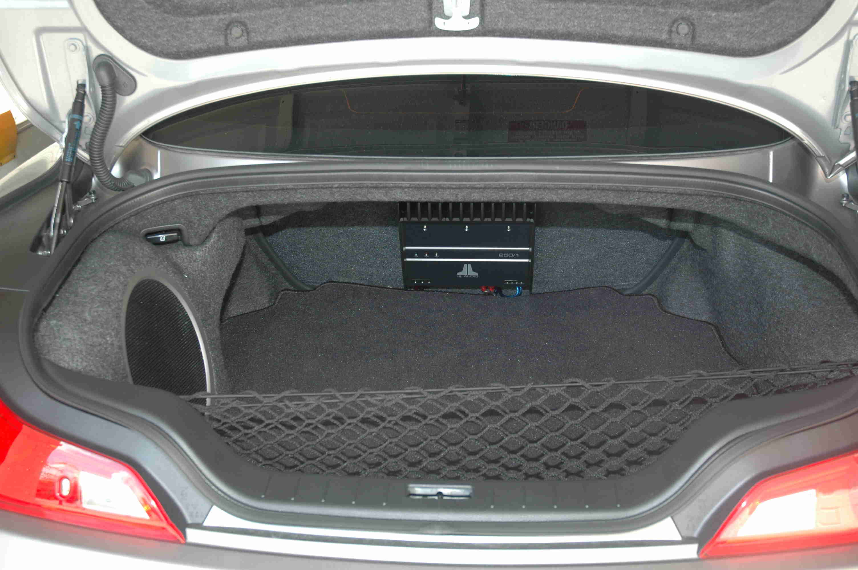

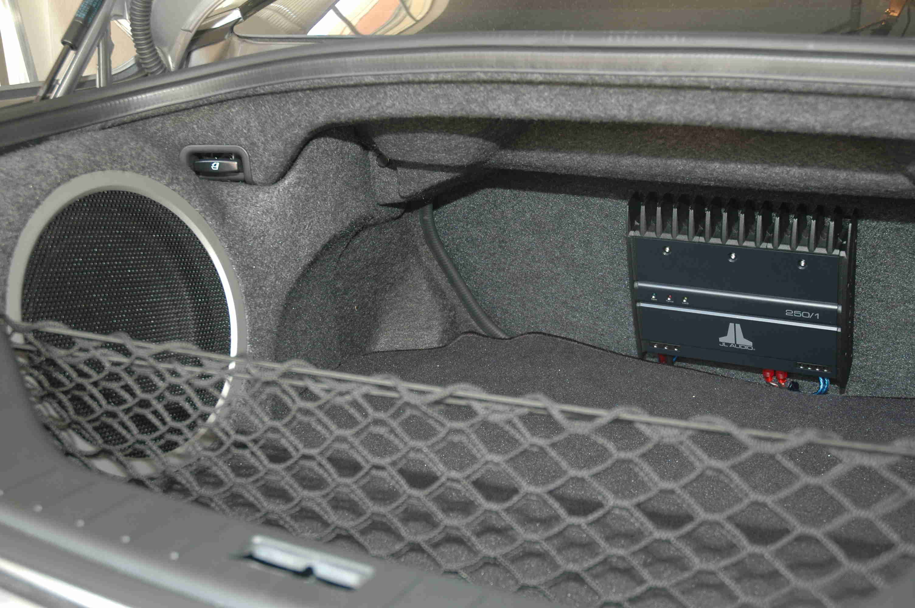

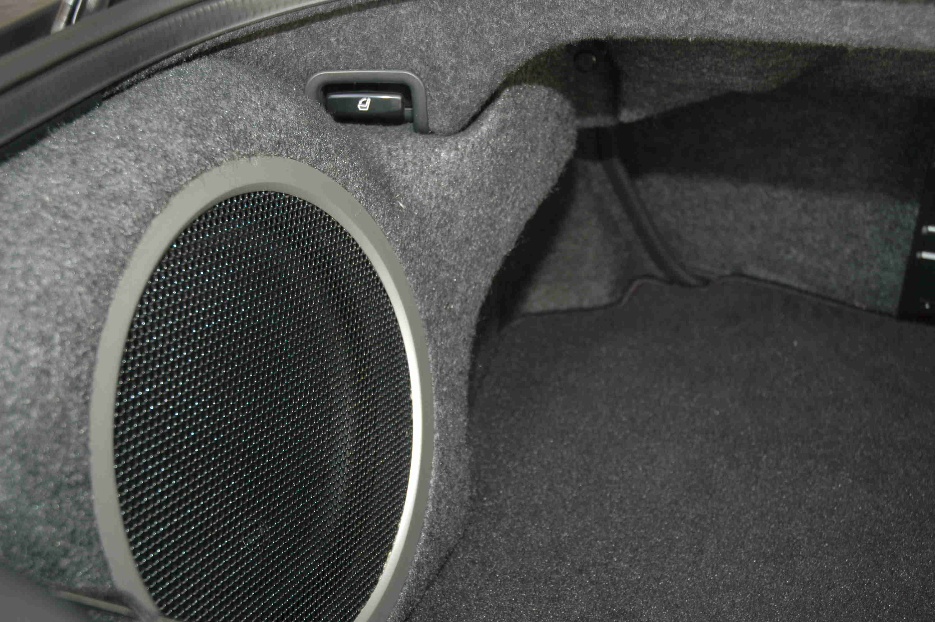

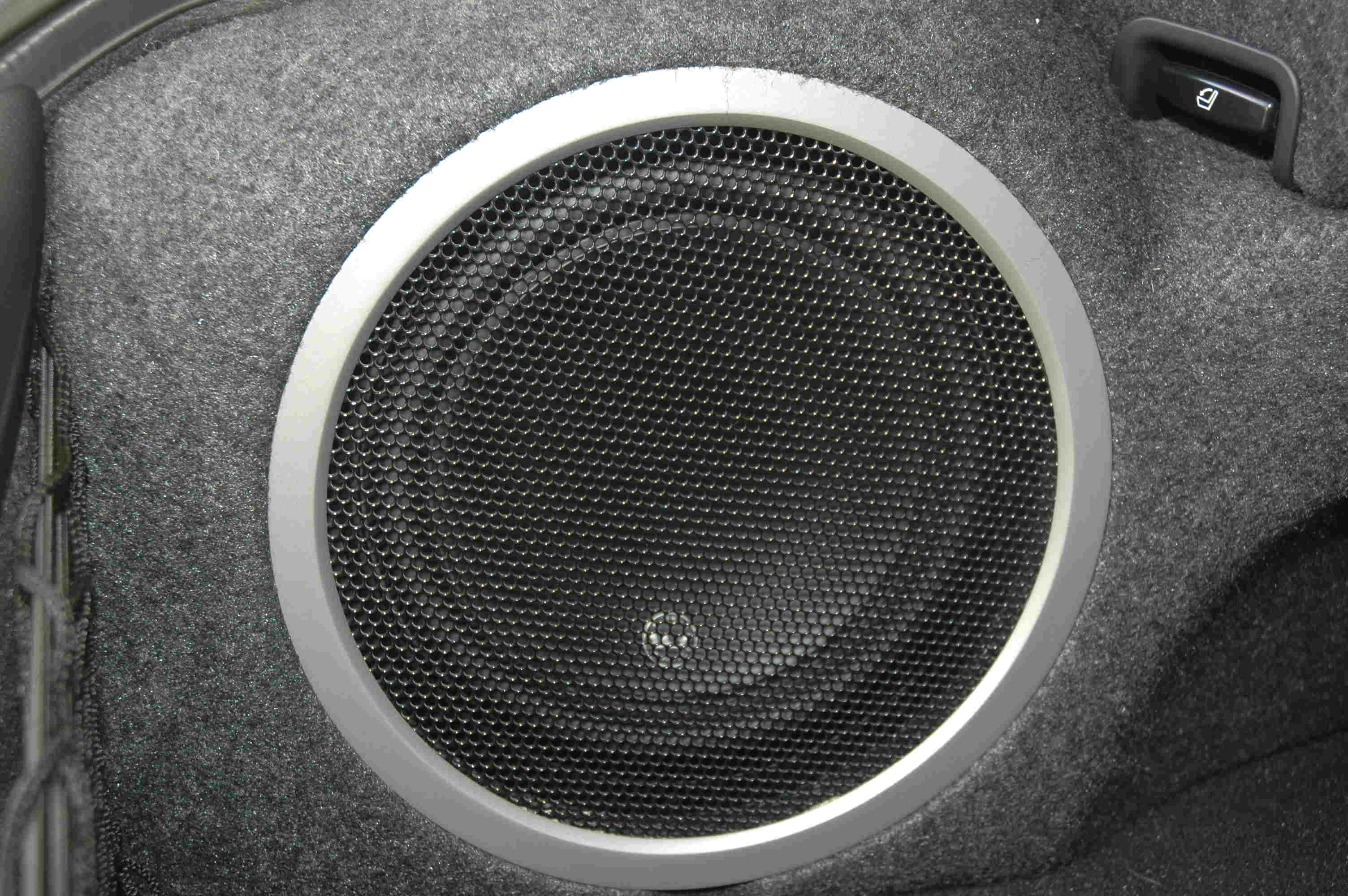

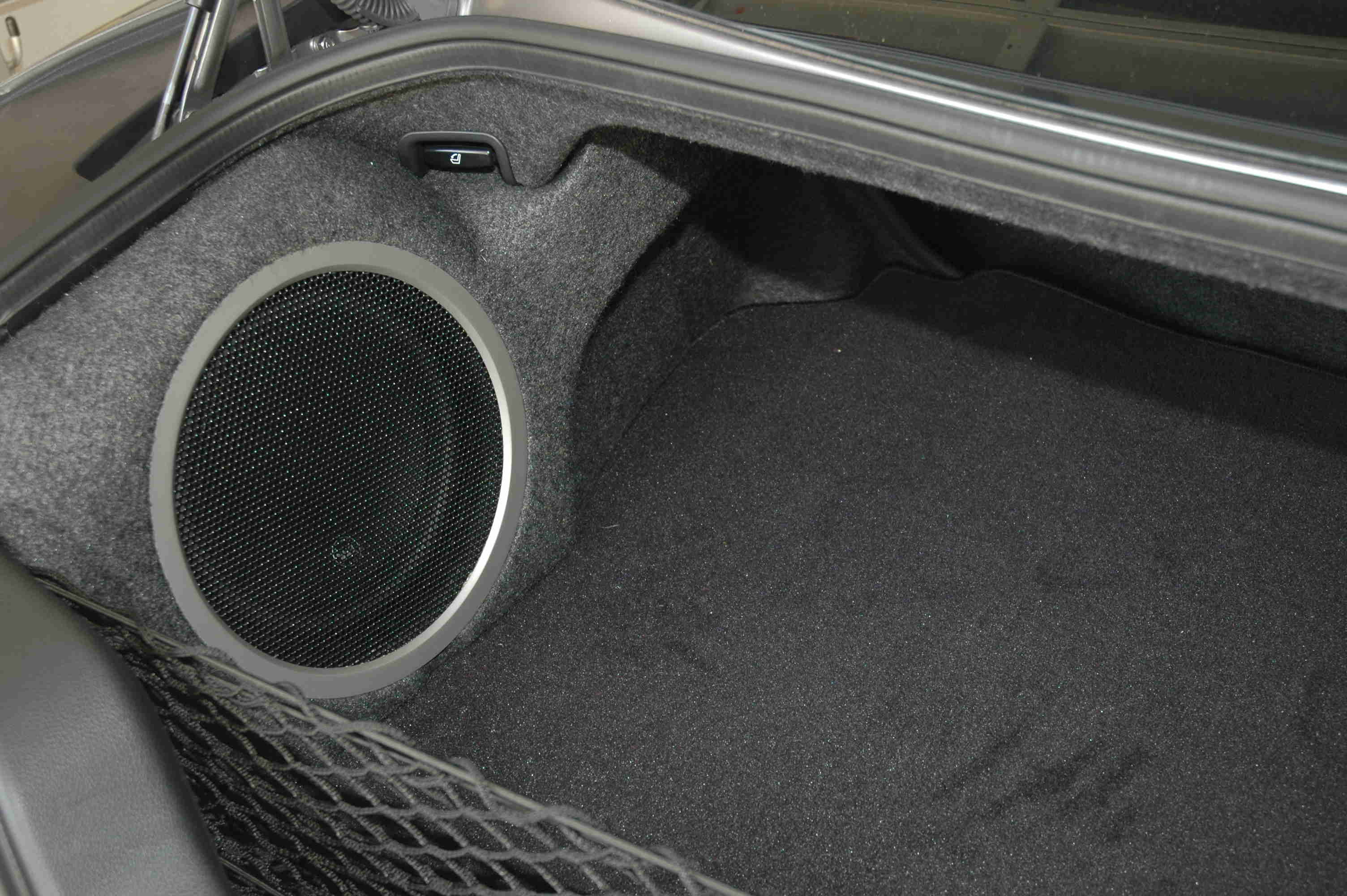

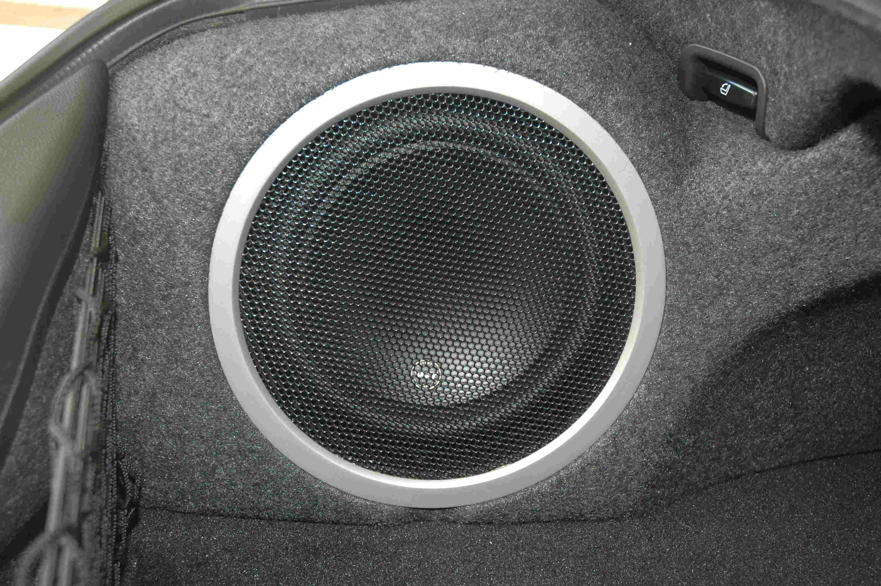

Here are some pictures from my install. Everything sounds good, but I have an issue with the sub turning on due to my amp install... used the signal turnon of the JL amp instead of the remote lead turnon. There's issues with the amp turning on at low volumes, as the signal is not strong enough to tell the amp to power on... it'll be fixed later this week.
In the meantime, hope the pictures help...
Attached Thumbnails 4080 Subwoofer Enclosure-sub_0001.jpg   4080 Subwoofer Enclosure-sub_0002.jpg   4080 Subwoofer Enclosure-sub_0003.jpg   4080 Subwoofer Enclosure-sub_0004.jpg

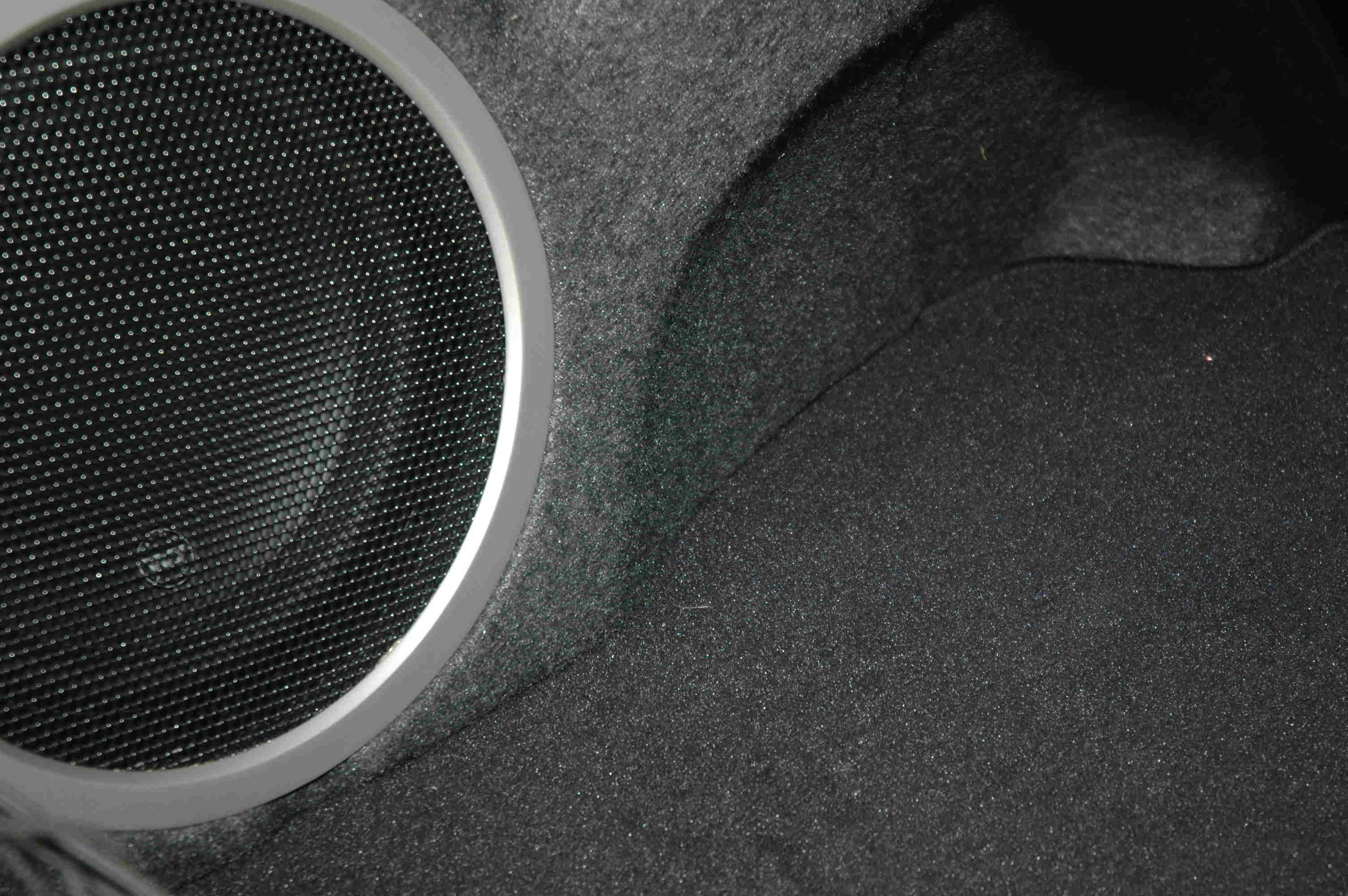

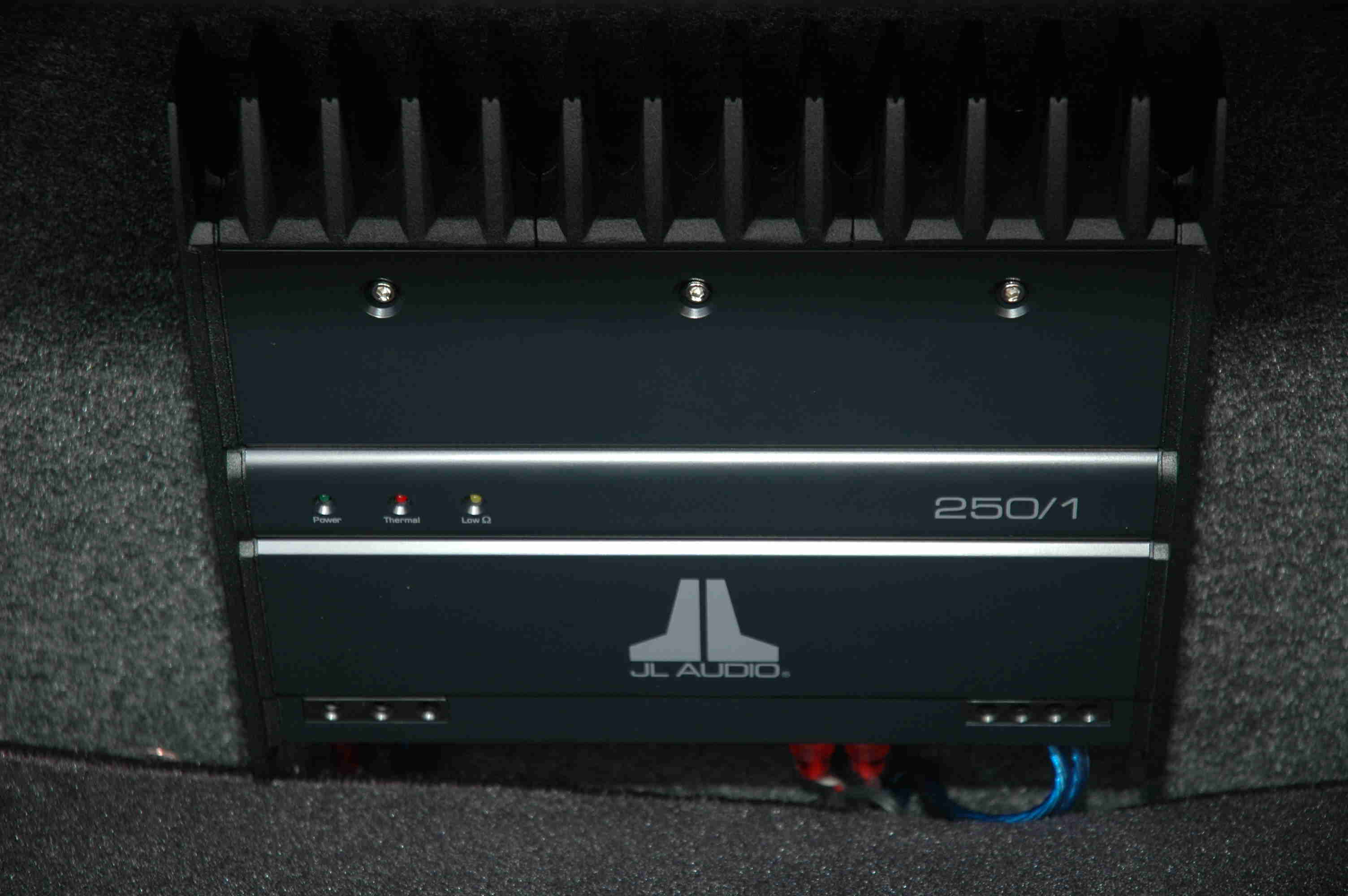

some more...
Attached Thumbnails 4080 Subwoofer Enclosure-sub_0006.jpg   4080 Subwoofer Enclosure-sub_0007.jpg   4080 Subwoofer Enclosure-sub_0005.jpg

looks so pretty haha

Looks like a good install
Love the look!! Want to get one installed in my G37. Did you just run in off the rear speaker lines and how does it sound? Anyway we could get a picture of how you wired it up underneath.

Just wire it properly to the 12v... it's explained in the manual how to do it. The speaker level sensor works well about 70% of the time... the rest you have no bass, until the song hits a certain note, it turns on, then kicks in...
As far as sound is concerned, you really don't need more than the 250/1v2. I had to turn mine down a lot, as well as tweak the frequency. The people that installed mine listen to too much bass. Either way, I really don't think you need more than the 250/1 unless you're really switching all of your other speakers... it's pretty close to overpowering them as it is.
I have one of the older 250/1... which doesn't have the bass ****... It's just a matter of time until mine goes on ebay and I get the v2.
Ohh and sorry about not having pics of the whole step by step process... i've passed the years of running wires myself... I just had my Sound Advice people do it.
