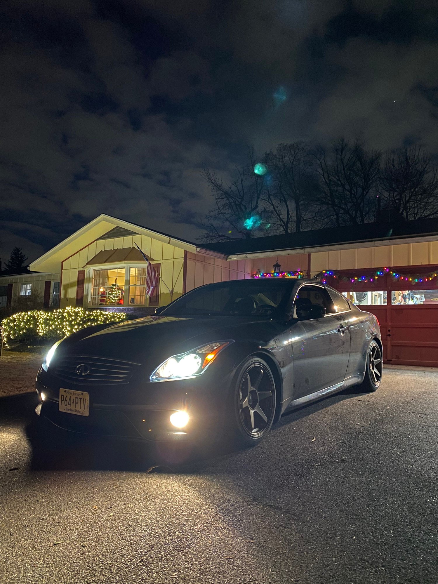

Only difference from summer is I run a 245 in the winter instead of a 255

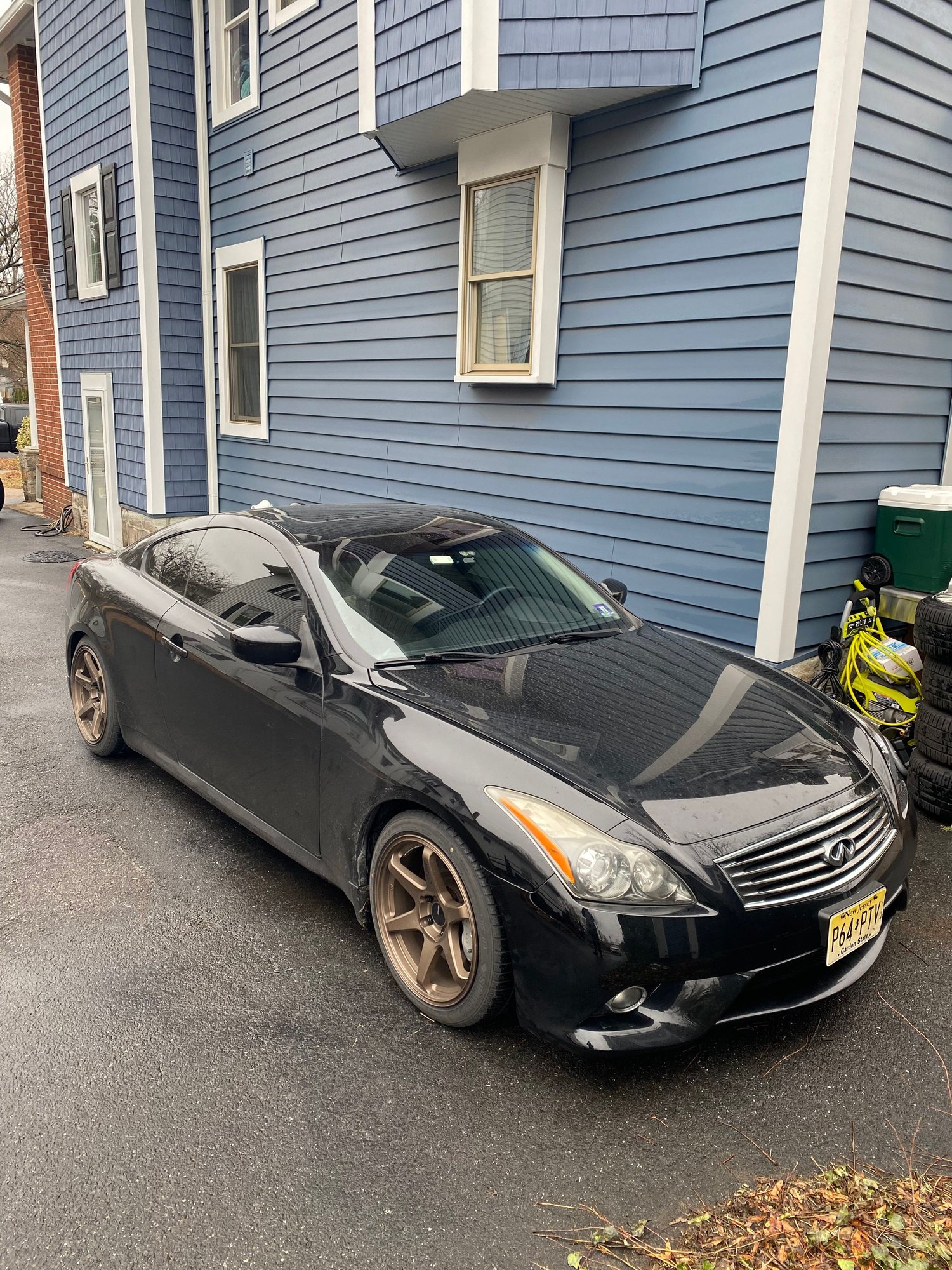

Enkei T6R 18x9.5 38mm
Originally Posted by DaPointyCactus
Does anyone know if Enkei 18x9.5 38mm offset T6R will fit over stock big sport brakes on a 2013xs coupe? i am looking to order them for black friday but am not finding clear answers as to whether they will fit or not. TireRack says they wont but fitment industries says they will. Anyone know of anyone running these without a spacer?
UPDATE:
I bought the Enkei t6rs 18x9.5 38mm, I love them they fit no issues with tire rub or the akebono big brakes. The first two pics is them on stock fitment, the other 2 are on bc racing coils, still no rubbing issues. Stock Fitment 18x9.5 38mm
Stock Fitment 18x9.5 38mm in the front
Fitment 18x9.5 38mm on BC Racing Coils

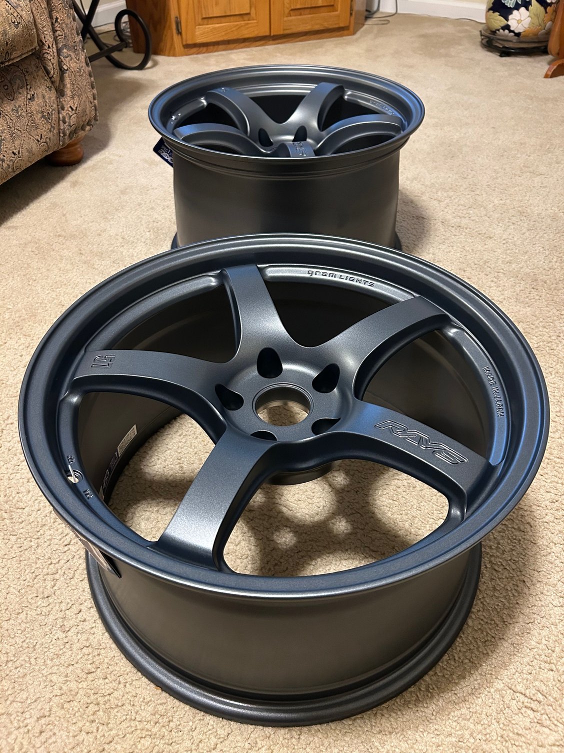

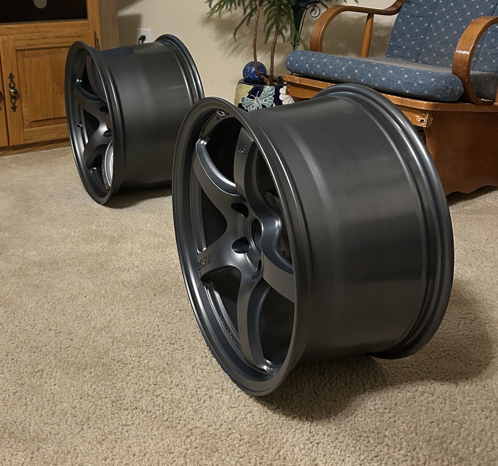

My wheels came in yesterday (yes Gram Lights in the living room)! 18 x 9.5" +22 in front, and 19 x 10.5" +22 in rear. I ended up purchasing a wheel fitment tool and those were the offsets that made the most sense. My follow up question is in regards to tires.
Do any of you have recommendations as to what tires/ sizes I should run? I want a relatively meaty fitment like the GTR is running above. I went to a local tire shop and they suggested Michelin Pilot Sports, 225/50R18 in front and 265/40R18 in rear. Would those measurements get me a similar fitment, or are there other sizes/ brands/ configurations you'd suggest?
As always, thank you so much for the feedback, I'll take all the ammo I can get. I'll follow up with pictures again after install to share what the finished product looks like
