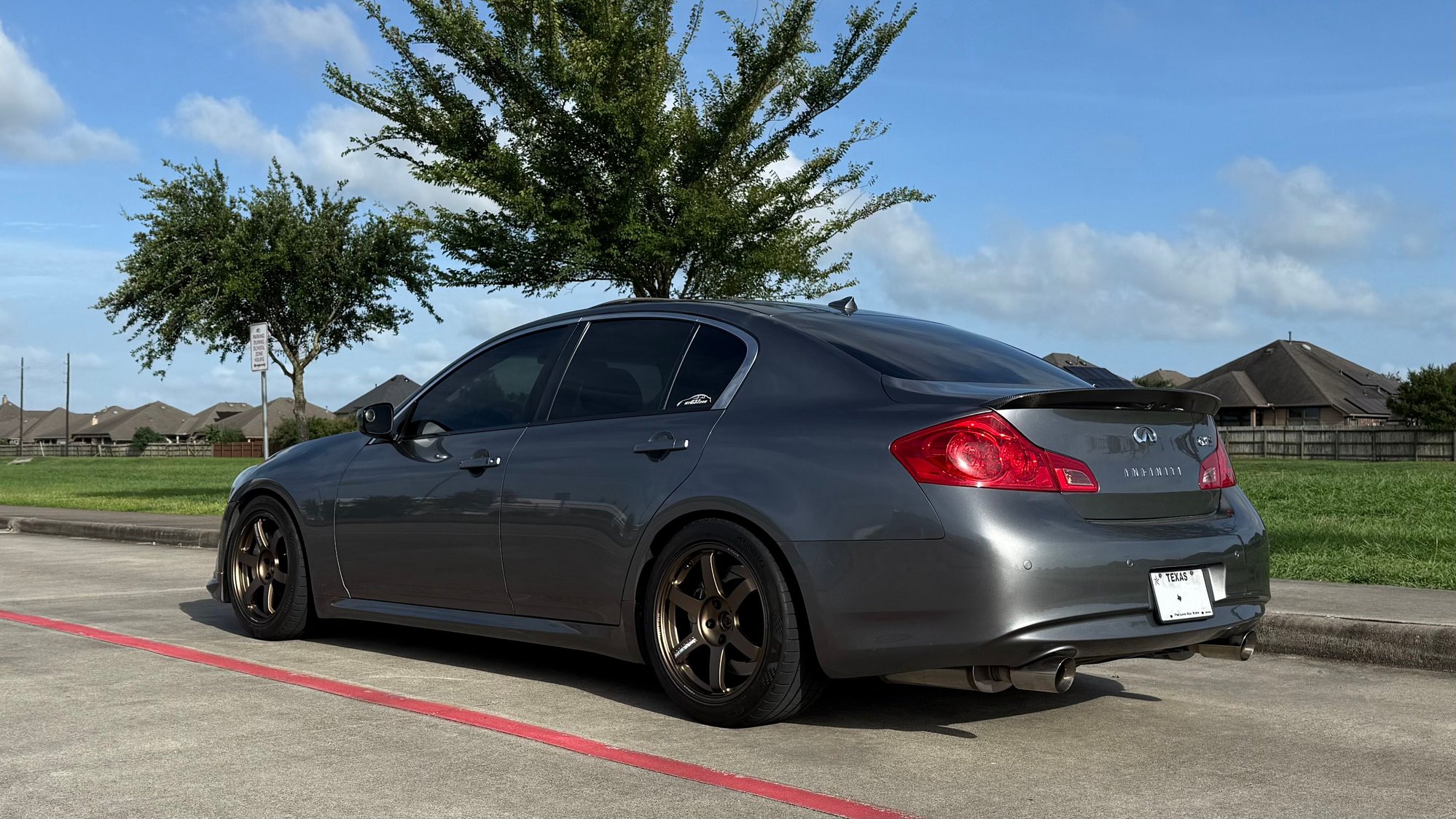

Whelp, I did not expect to post a different setup in this thread again so soon (or in general). I ran into some issues with my powdercoated 57CRs. Because I believe the issue was with the powder coaters and whatever they did to my wheels, I no longer felt safe running them.
After contemplating my options, I decided I've owned this car for way too long to let go now. And even though I've done most of the mods I've wanted to do, I have yet to fully enjoy it. Will I regret sinking more time and money into this car? I hope not lol. This car is handling amazingly at autocross right now, so there's that!
Wheel: VOLK RACING TE37 SAGA S-plus w/ 37 center caps in Bronze (Almite)
Tire: Kumho Ecsta PS91 265/40R18
Weight: 19.46 lbs, 47.49 lbs w/ tire
Clearance: Clears Akebonos. Rear wheels rub fender liner with 2 adults in the back
Spacer: 3mm front (for fitment reasons only)
Bittersweet for sure, and the faces do look flatter than I prefer (especially in pictures. Face 4 has more concavity, but only comes in +30). But I can't be too upset as these are the dream wheels of every JDM kid in high school. The specs are the exact same as the CRs, so I just included pics of the wheels on the car.
If anyone's interested, below are images of the damaged 57CRs. For context: the wheels had less than 4,000 miles, only 1 autocross event, did not hit any potholes, or wreck the car (obviously). These wheels have a load rating of 1,521 lbs, the same as the OEM tires for the car, and these wheels are advertised and used in motorsports. I'm still not 100% sure what happened, but I think whatever the powdercoaters did in their whole process ruined the heat treating and weakened the wheels (and you can see how they didn't even mask the mating surface, and took them 2 tries to get it right). This is from my biased opinion, so take it with a grain of salt. And maybe I'm completely off in my assessment. I could've gotten 2 defective wheels at the same time, but that seems very unlikely from Rays.

Old Jul 12, 2025 | 07:41 PM
  #160
projectpanda13's Avatar
projectpanda13
Joined: Nov 2016
Posts: 1,295
Likes: 389
From: Atlanta, GA
Originally Posted by ctng37
new setup looks awesome.
