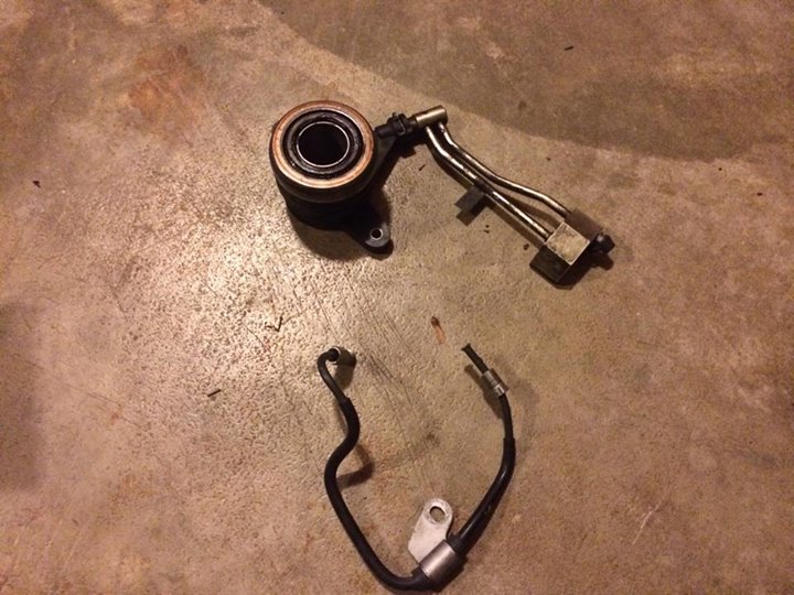

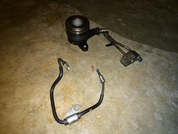

So I have an issue, my g37 has a performance clutch from Z1 and it kept causing my stock Slave cylinder to blow (first two pics). So to solve the issue I purchased that aftermarket HEavy duty concentric replacement csc from zspeed (3rd picture) after the installation, the clutch feel was so soft basically day and night difference. Basically it would not engaged till the very very bottom of the floor and it literally half an inch or less of feel...I drove it around for a bit but it never seemed to gain more pressure...so I bled the clutch and purged it of all air and still it's the same issue...I know there's no way this can be "normal" do I was hoping someone could help bc I have trouble at times getting into first gear and reverse from startup (sometimes)...any help?

No, the issue is a flaw with the Zspeed csc eliminator. They are notoriously hard to bleed, and some air is almost always left behind. Jtran Motorsports in Houston has lots of experience with that particular bit of equipment. They like it, but I've heard them discussing how difficult it is to bleed correctly.

i hope your right...the method i used to bleeding 3 times already was the pedal pumping and turning of the clutch nipple under the transmission....if i use a gravity bleeder will that solve the trick? whats the best method theyve found???

Gravity bleeding is what, leaving the nipple cracked open and keeping the reservoir from going dry? I wonder if reverse bleeding might help -- filling it up from the nipple side instead?
Not sure the spring would actually help in this case.
To clarify a bit, how far does the pedal have to be depressed before it gets harder to press? 1", 2", 5" , etc?

Yes that's gravity bleeding with a gun that sucks out the fluid and I actually attempted to do the method you suggested with an oil can pump from the bottom up but it wasn't strong enough so I have up on that....and in regards to the pedal let me put it this way...when the pedal is up, let's say when it hits the floor, that's 100% of the way....so half way in would be 50%...so basically I don't feel any pressure until it is about 90% to the floor ...so way further than halfway....it does engage and it does have pressure...just extremely minimal :/

Sounds like air in the system. They had to bleed a nismo 370 3-4 times before it started working right.

Understood. That's air in the line. From the fully up position (pedal completely off the floor), I get resistance after about 3/4" of depression. Never actually measured, but it gets hard almost immediately.
You some some significant air in the line. If you're going to reverse bleed it, you must make sure absolutely no air is escaping around the threads of the bleeder. A layer of teflon tape on the threads may help. Also no air leaks around the suction point at the bleeder.
Maybe do the gravity bleed first.

well i finally got it all fixed up and good as new....so basically after my stock slave gave out, i eplaced it with a heavy duty CSC. I called the manufacturer and I was told they are hard to bleed so i bled it several times. The clutch would feel good for about a day or two and then randomly lose about 80% pressure. So I ended up buying a new Master Cyclinder replaced it and solved the issue. Everything turned out great and im loving my car again haha THANKS EVERYONE!
