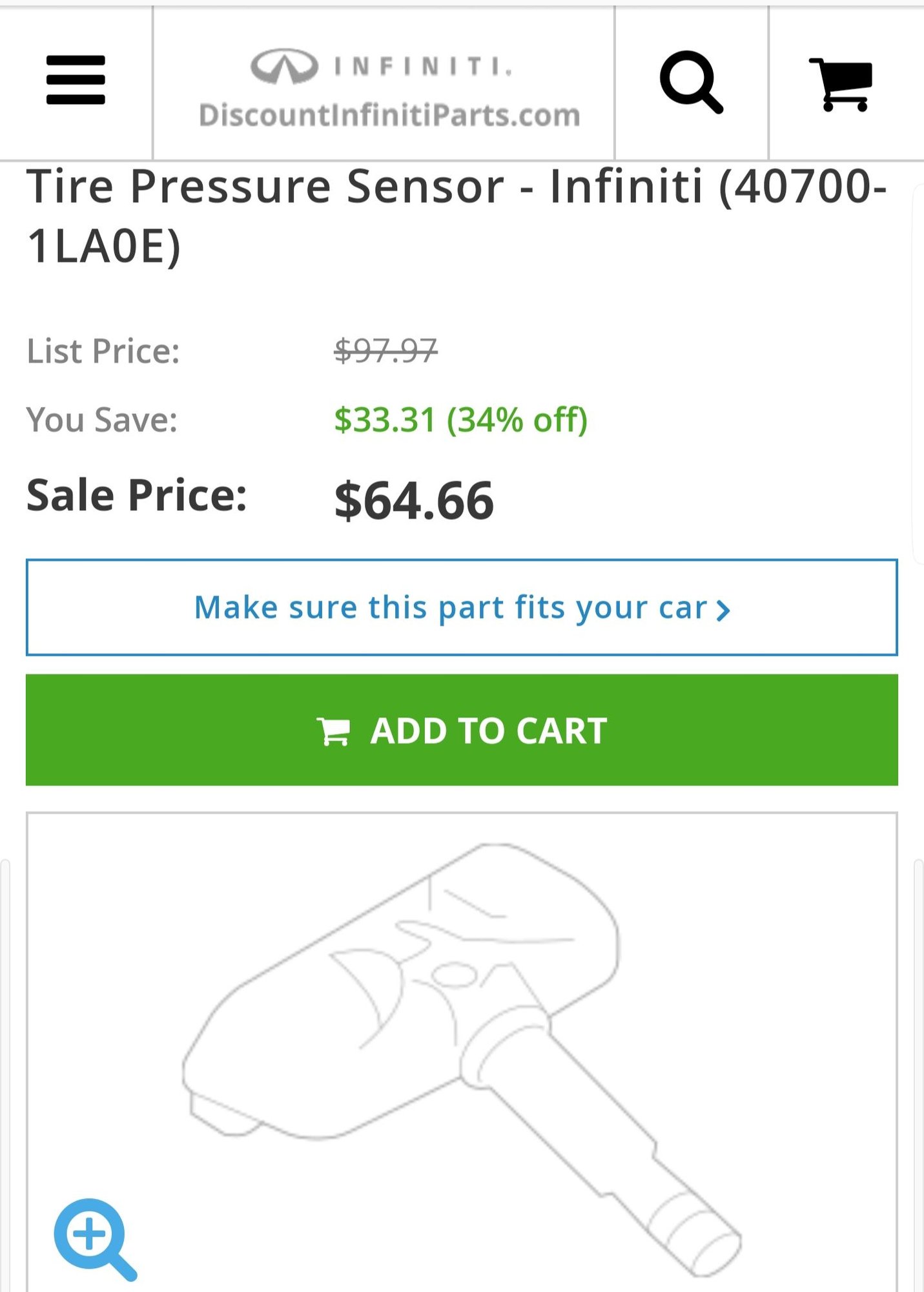

I almost always deal with discountinfinitiparts.com for parts. Prices are reasonable and customer service exceeds top notch. Real Infiniti dealership in Atlanta metro area.Just a suggestion, no affiliation.
I found the sensor for $65 (TPMS Sensor- New): IF you want OEM:
You might find them cheaper elsewhere or even on eBay.
Good luck!
