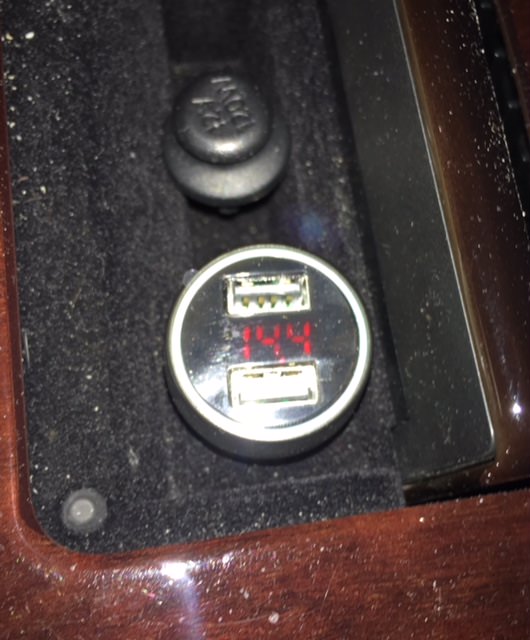

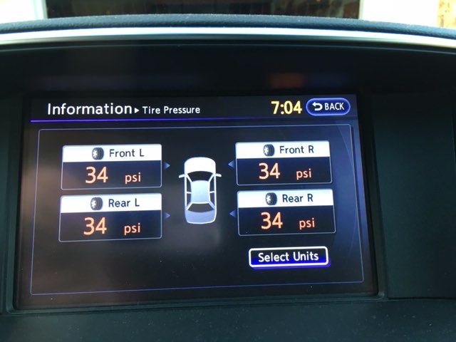

My Q70
TPMS Pressure/Temp and Battery Voltage Kit-6fvfq1f.jpg
TPMS Pressure/Temp and Battery Voltage Kit-hhqmuux.jpg
