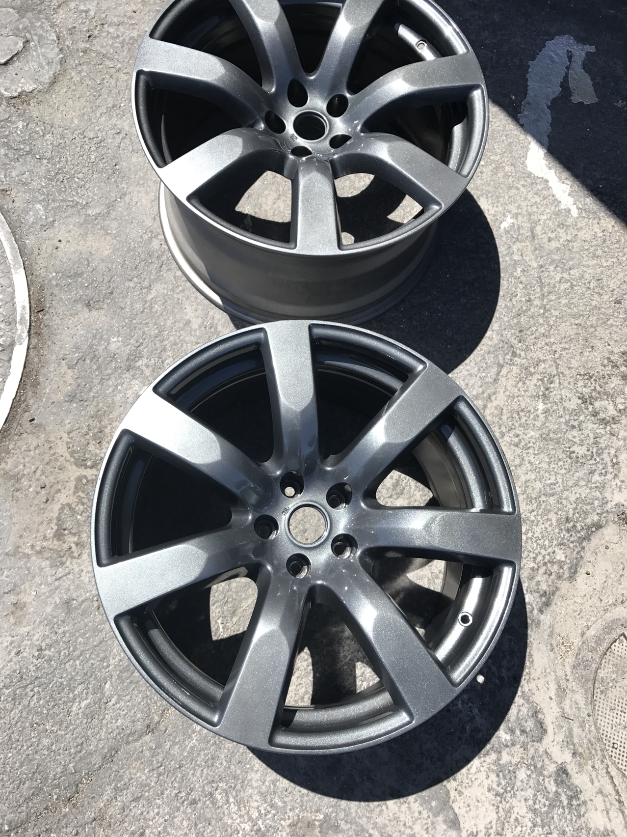

I'm running R35 set of rims on my G

Not 100% sure what the GTR wheels use, need to check the lug seat inside the wheel, if it's flat then you'd need OEM. Here's a black or chrome OEM gorilla lug nut in the OEM mag style.
It seems that #73128TBC is the only one that is available in black, and it's black chrome

OEM lugnuts for those wheels. Gorilla makes them, too. Here's a link from a quick search:
Gorilla® 12mm x 1.25 Toyota/Nissan Lug Nut from Brandsport Auto Parts (#GRLA-73128T)
You really running that GTR rear wheel on a G37 Sedan? I could see a square setup with GTR fronts maybe. But that deep dish... that's weird. Can't possibly imagine how the offset would work.

Square setup. All fronts ftw. As for the OP QUESTION, GT-R wheels don't use oem lug nuts.. U have plenty of options available for these wheels. I am running R40 lug nuts.
Really? That certainly opens up a world of options. GTK
Thanks for the clarity, it seems that the Rays have wheels that have both types in their lineup so it's hard to pin down
