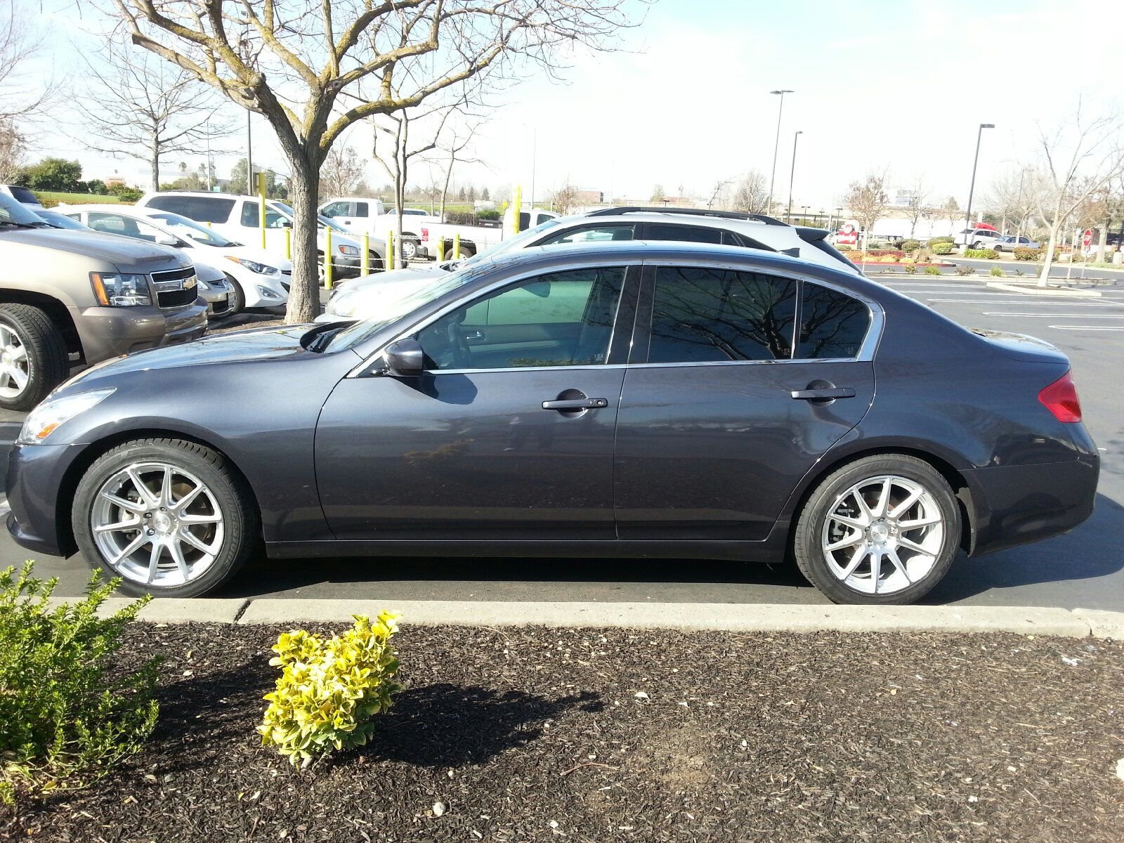

I went with Niche Essen wheels (square setup - 18x8, +40) with 225/50 tires.
Although I would have prefered to lower my car and go with 19 or 20 inch wheels, for various reasons I did not lower it, and pretty much had to go with 18s.
Hope this helps with your decision-making.

Good look Ryan, looks like OEM "plus", well done.
Thanks for the compliment.
With the constraints I'm dealing with, that's the best look I was hoping for.
Maybe at some point I'll be able to do a mild drop and get a set of staggered 20s - the look many have here that I'm sooo jealous of!
