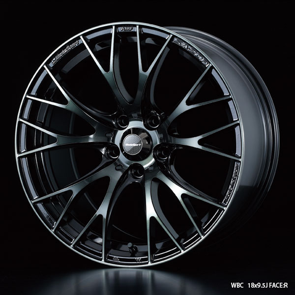

I've been searching high and low for the right wheels in the right size with the right finish at the right price. Most have either been discontinued or only come in either a polished or matte black finish and I really wanted to keep the price down. I could go with say some Volk ZE-40's but I'd be out $4K before tires.
There were quite a few of the Wedssport wheels I liked, especially the SA-72R's and the SA-15's. The 72's don't come in 19" sizes and the SA-15's don't come in a color I like. I like the dark chrome versions but hate the blue inner portion. The gunmetal version looks bronze to me and would not work well on a Graphite Shadow IPL.
I saw the SA-20R's when they were first released and they've grown on me. I can get them in the WBC (black chrome) finish which is similar to the stock IPL wheels. They also come in the right width, 9.5". The smallest offset they have is 38mm so I'd have to run a 5mm spacer up front and a 10mm in the rear to get what I believe would be the perfect fitment. They weigh 21 pounds in that size which is a good reduction over the stock weights. They look "similar" to the IPL wheels but will have an R-type face meaning nice and concave.
Here's a pic:

Yea or nay? Price is very good IMO a far less than $2K although I'll have to spend $100 to get the flush center caps that I want. Weds won't swap them out.

In the pic alone, the wheels looks pretty good but I feel once it's installed it'll be too busy for the lines of the IPL...if that makes sense.
Not sure why you don't think bronze would look good, to me that's a great color combo out there.
Old Sep 12, 2016 | 08:58 PM
What about SA55R in Matte Gray? The concavity is the R face and would be much easier to clean, and a 19x9.5 +24 would be a perfect coupe offset. I have the 18" SA10R in a 9.5 +38, have nice concavity and a very nice finish. They do have a lot of pockets to clean around so the SA20R would really take some time to fully detail, but they are a nice look for sure!

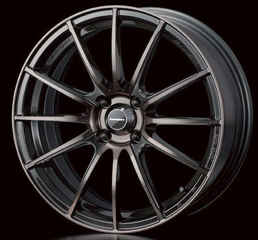

Here's the 15R, I've actually lightened the photo a bit.

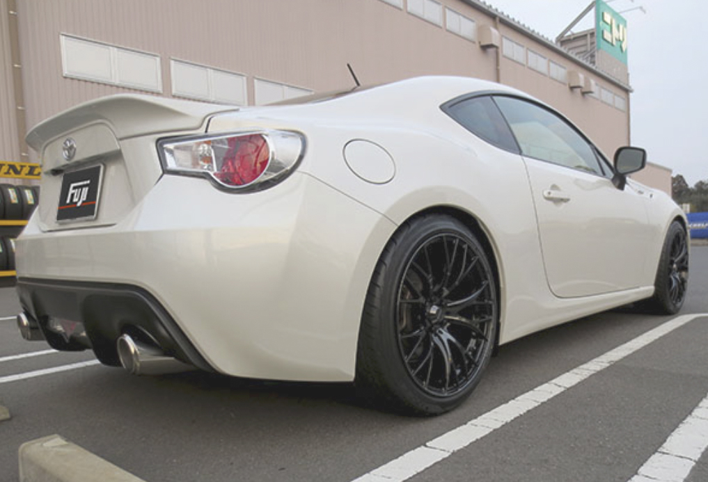

The 20R on a BRZ but in black.

I just found this image and it gives a really good look at the color and I have to admit I like it. I also like the idea of not running any spacers at all. I'll contact GYW and see what they can do price wise as well as what KamiSpeed will do. Bought a Fujitsubo exhaust for my Evo from them back in 2006 and they were great to deal with. Drove all the way from Naples to Orlando and had my stock exhaust, wrapped of course, sticking out the back window! That place was total eye candy. So much JDM goodness hanging on the wall it wasn't funny.
Anyway, the pic.

Keep in mind the only R face in the 19x9.5 SA15R is the +25 offset, but that would be the right one for your coupe so

It'd be 11mm more poke than I have now (stock IPL rim with a 20mm spacer) in the front and 1mm more in the rear. That amount of extra poke out front worries me a bit but they look good on Gentlmn Z's car and don't stick out past the fenders. I guess I could do the 35mm offset but then you get the F face and not the R. And then I'd have to run a 10mm spacer in the rear.
I plan on running PSS 255/40/19's which are 27.1" in diameter, .2" more in front and .3" more in the rear. The stock bridgestones weigh 27 pounds front, 30 rear while the PSS in the 255 width weigh 27 pounds so I'd at least save 3 pounds per tire in the rear. The wheels should save me four pounds each up front and seven pounds each in the rear. I can get four of them at Costco for under a grand.

11mm is going to be barely noticeable once the tire is on. This will also help your stance should you decide to go wider in the rear.
Love that color though
