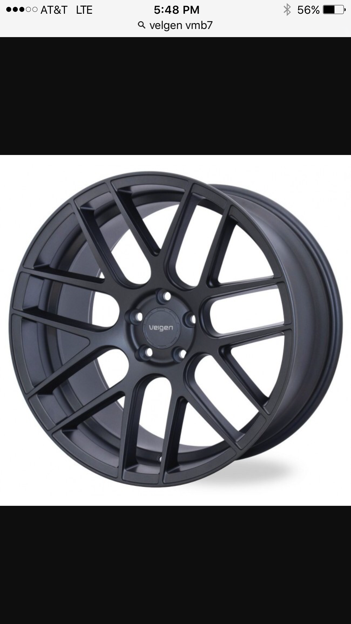

Hey guys, I recently got a 2013 Infiniti G37s Coupe and looking to get the Velgen VMB7 wheels.
Dealer said they have the following figment available:
20x10.5 5x114.3 45et
I was hoping someone could tell me if this would fit my car?
If not what size would you recommend?
Any feedback would be appreciated. Thanks!

Given the lack of info and obvious searching capabilities, you want to run that size as a square fitment?
If so, you may need some work to get those to fit in the front...camber will be a factor.
For the rear, those will be fine just choose your tires wisely...275/30 area

Front may have trouble w/ inside clearance, that much positive offset on a 10.5 may contact the steering knuckle up top. There are some coupes running 10.5 square , but with offsets in the +25 to +30 range. Check this thread for more pics/info. There's a coupe on page 8 member "Simpson" that should be of interest

Damn a 20x10.5 +45 offset in the front? I have that exact size in my rear with 275/30/20 tires with no issues. Are you sure that's the same size and offset all around for the front and rear? I'd double check and make sure it's not a staggered setup where the rears are wider then the fronts.

Run a spacer up front if you really want to run that particular setup.

Thanks for all the feedback guys. I've decided to run 20x9 front and 20x10.5 rear. Put a hold on getting wheels but will post a picture once I decide to get a set.
