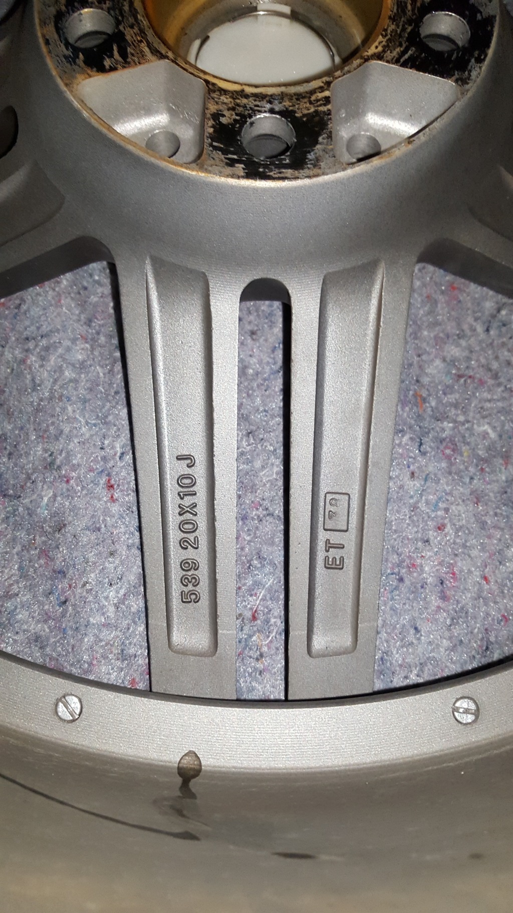

These are the wheels that came on the car when I bought it. I had to buy a spline lug nut key,and I threw my back out again. I think I'm gonna run to the dealer and have them get my the exact offset for the front and rears. I googled the info and it looks like the offsets are 20x8.5 with an offset of 35 and the rears are 20x10 with an offset of 38. I can confirm sometime tomorrow hopefully. I know the guy had to buy spacers to get the wheels to clear the akebonos.

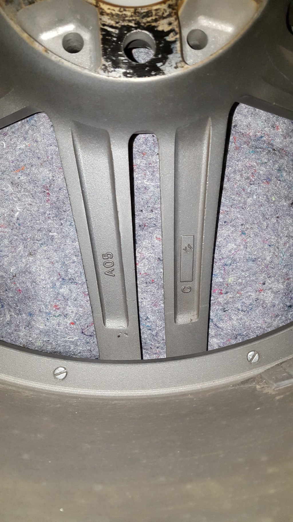

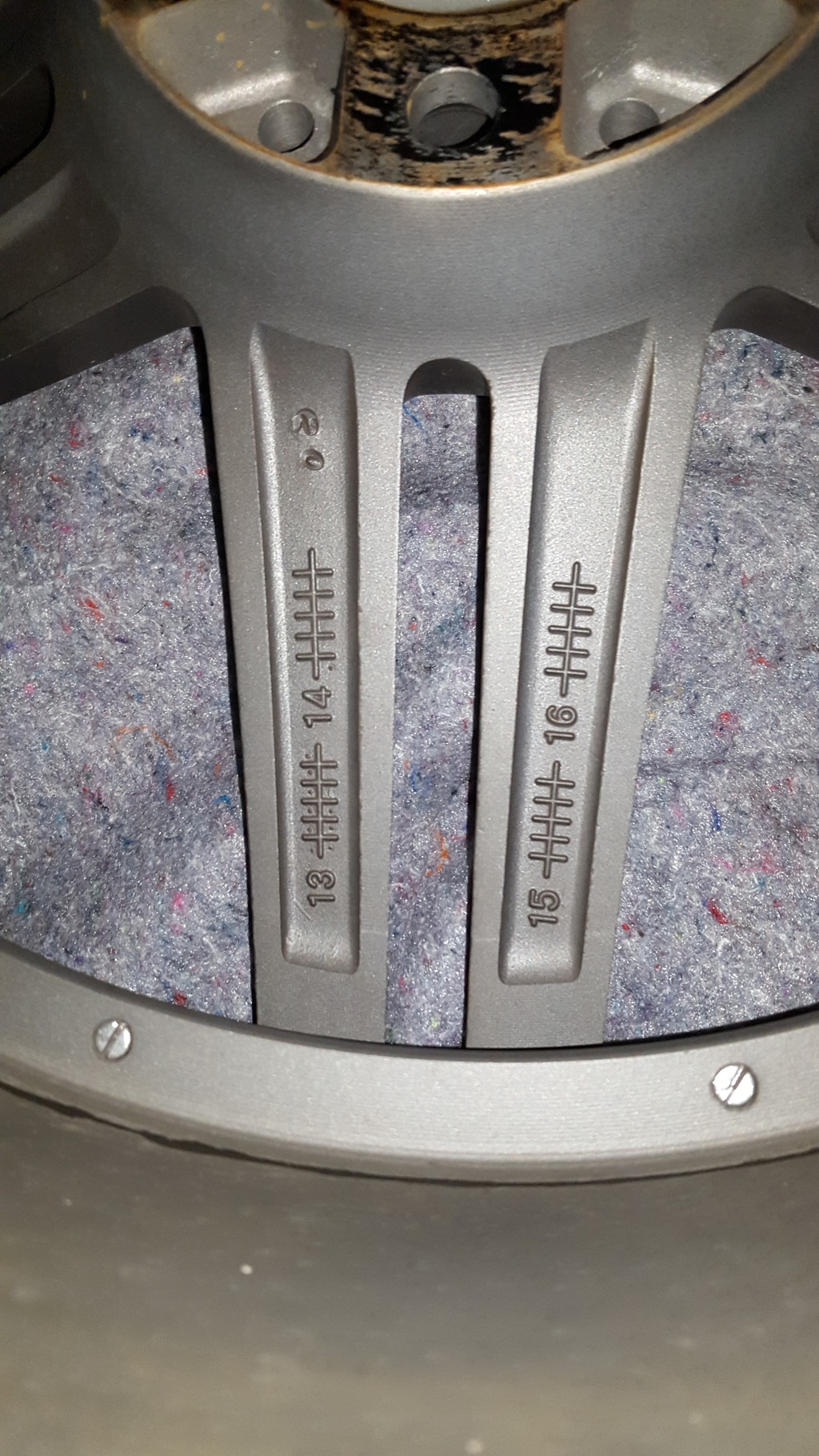

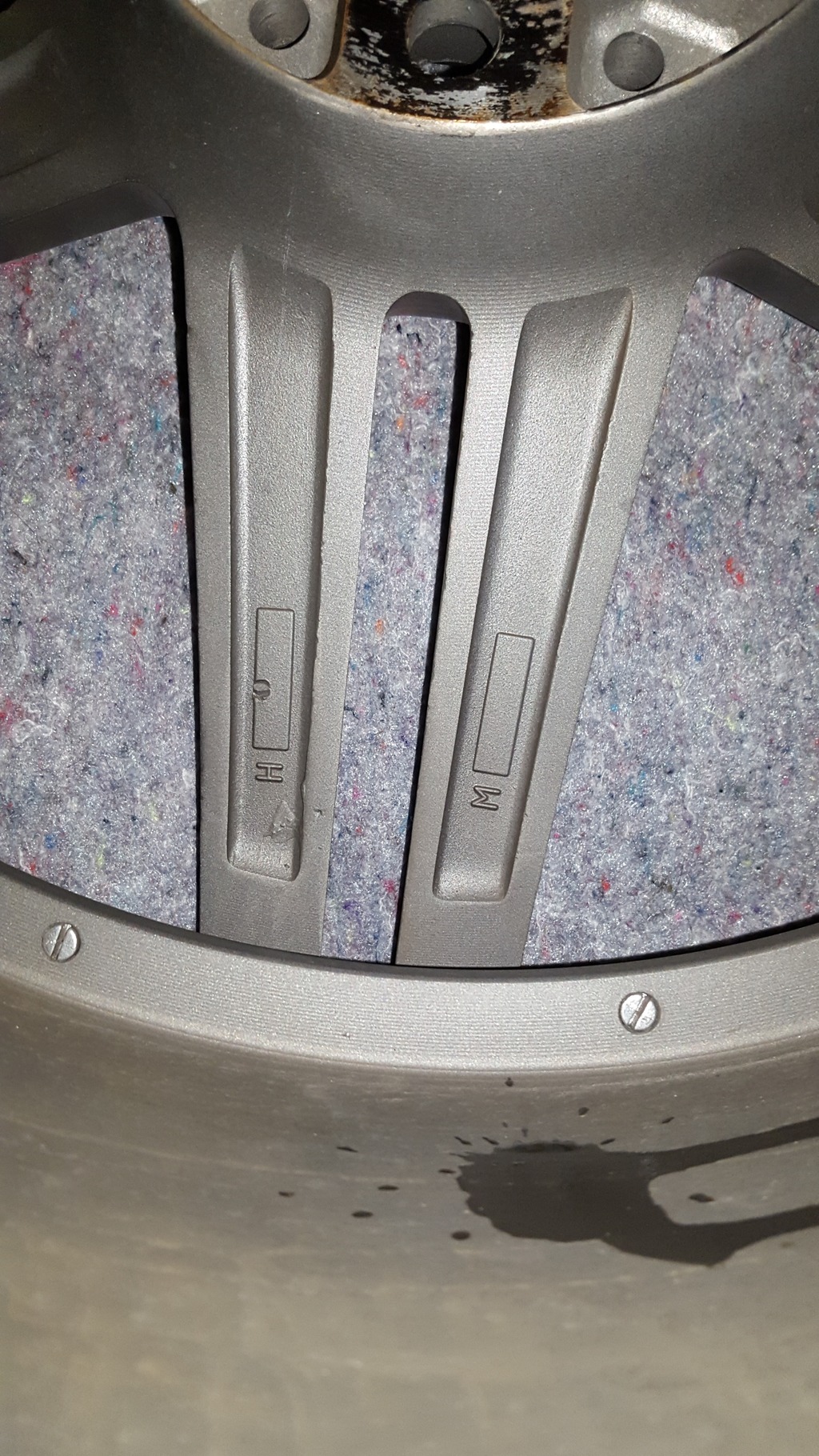

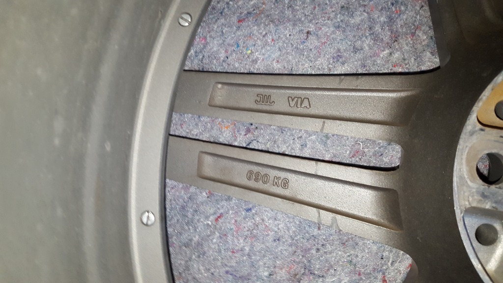

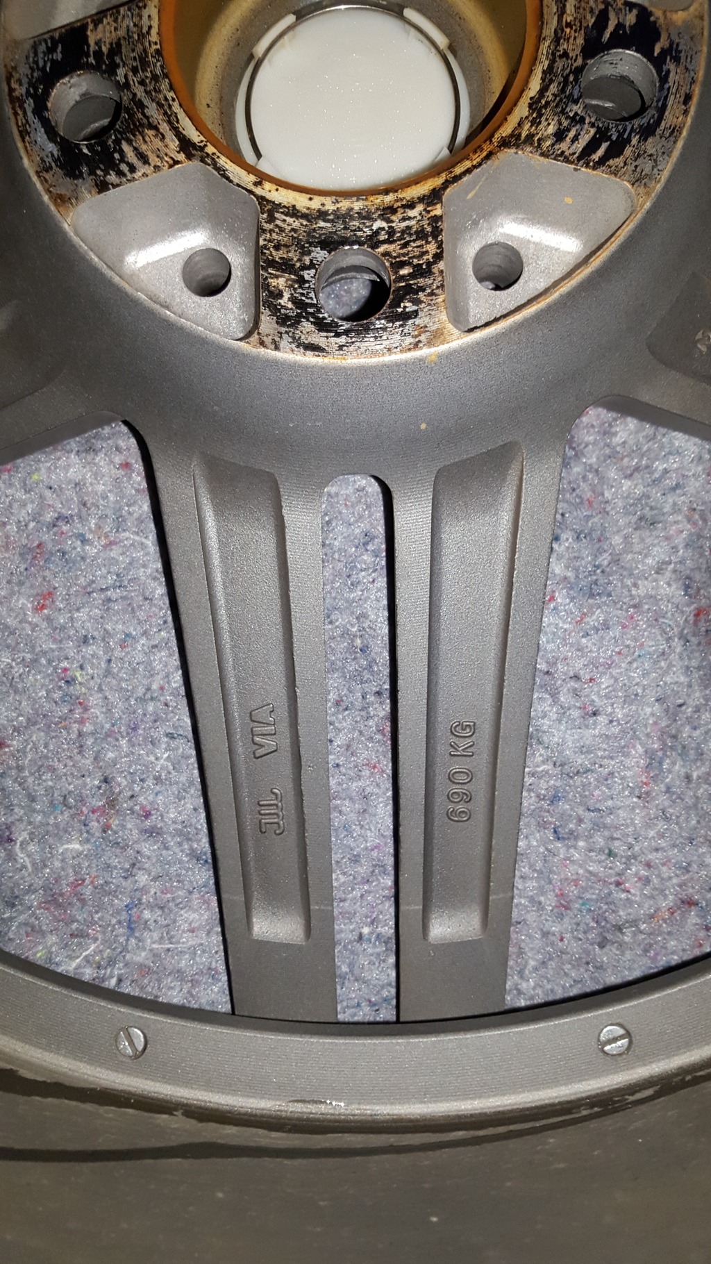

Finally got pics of the wheels. Not sure how to read all of this. Oh and I have 15mm spacers on the front wheel and no spacers on the rear.

Old Nov 5, 2015 | 09:43 PM
Likes: 4,951
You've got 8.5 +35 & 10" +38 (It's the ET number).
Should be good offsets for the 245/35/20 & 285/30/20 tire sizes for your coupe.
