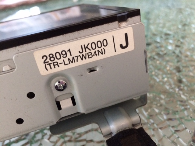

For a 2008-2010 G37 coupe or sedan (NON NAV) you need the low resolution display, part# 28091 JK000.

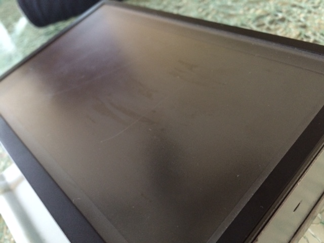

If your current display is NOT scratched I recommend buying a scratched one (cheaper) on eBay since you can reuse your old screen protector.

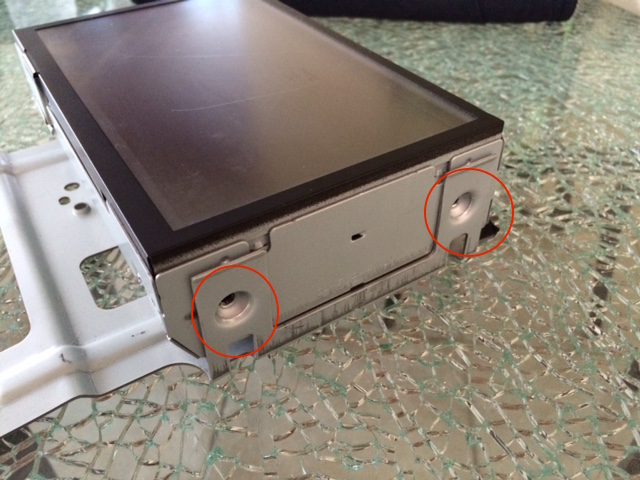

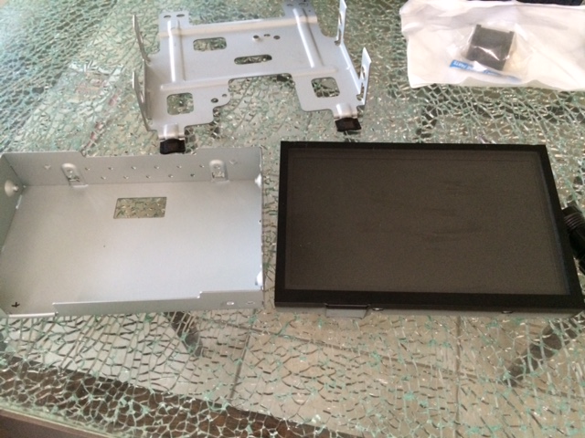

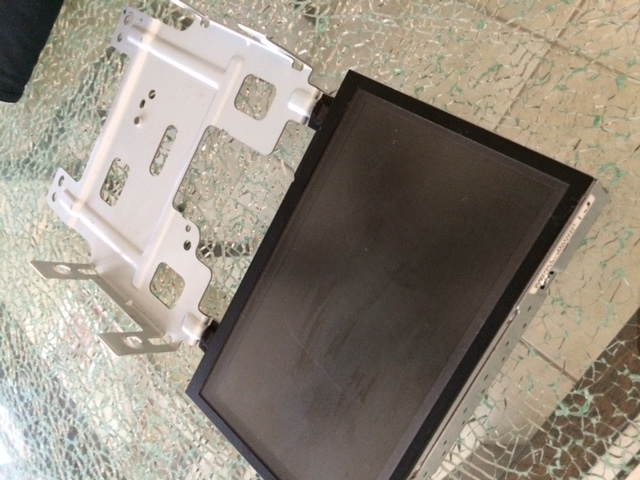

Display disassembly:
1. Remove all 4 bolts holding the display to the mounting bracket and remove from bracket. (circled on the second picture)

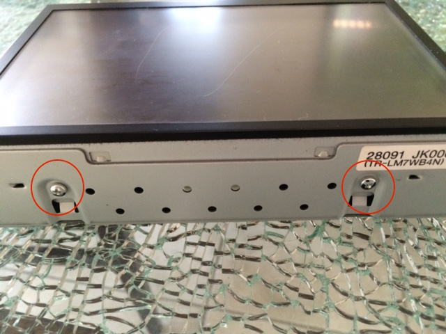

2. Remove all 4 bolts holding rear metal cover to the display and separate. (circled on the fourth picture)

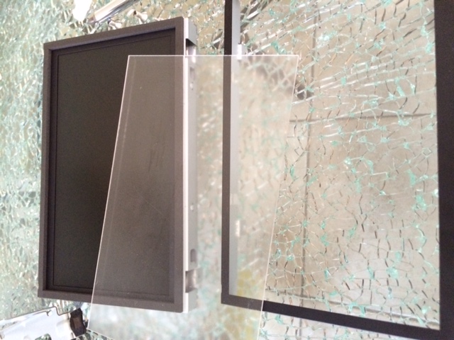

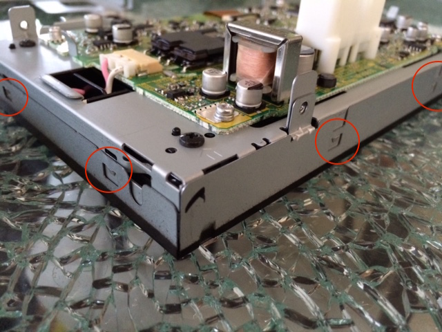

3. Using a small flathead screw driver, pry gently on the tabs holding the screen protector case. (circled on the 6th picture. Make sure to do this on a towel so you dont scratch up any display)
4. Finally remove and replace the screen protector with the non scratched one and reverse all of the steps)
