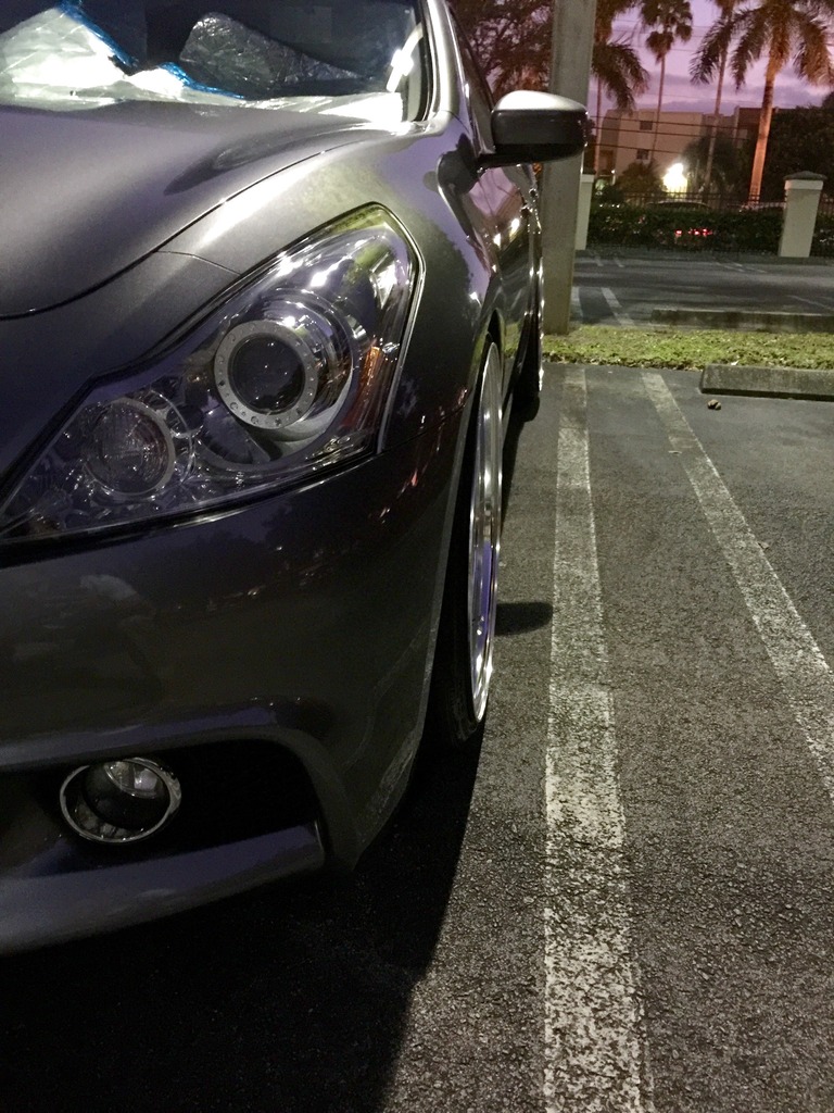

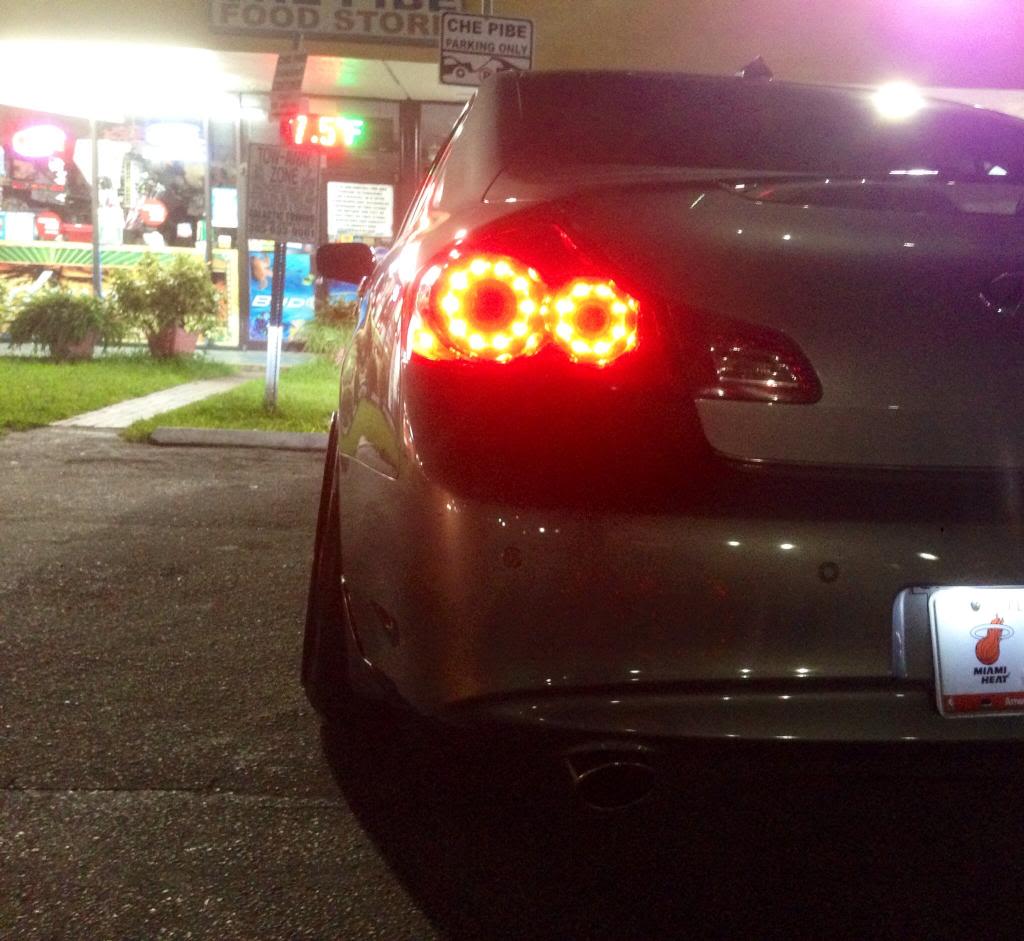

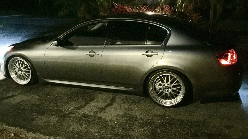

Here are my Work VS-XX
20x9.5 +23 running -3 camber
20x10.5 +32 running -4 camber
Both with great tire wear. Just get the toe right.

225/35/20 fronts
and
245/35/20 rears

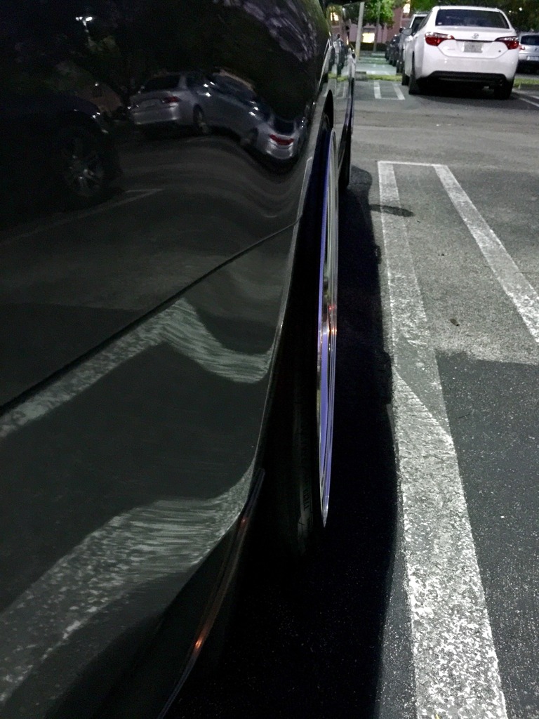

This is me running 20x10.5 +25. Same tire size (245/35/20), but about -4.5 camber.
It was a little too much for me. I personally wouldn't go more aggresive than +30 offset.

Even with spot on toe, -4 degrees of camber is not going to wear normally. It's fine if you are OK with that, but I wouldn't make the OP think that's realistic. That's a ton of camber.

This goes to show that you don't need any fancy camber kits in the front. I'm running natural camber of -3 in the front. Offset is fairly aggressive, but the stretched tire prevents it from hitting anything. I did cut away a little bit of the rear fender liner when I was running the 20x10.5 +25. I doubt it would be rubbing now with the +32 if I kept the liner intact.
